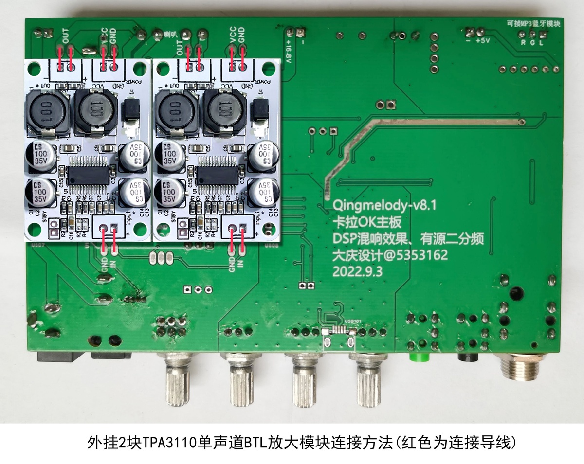

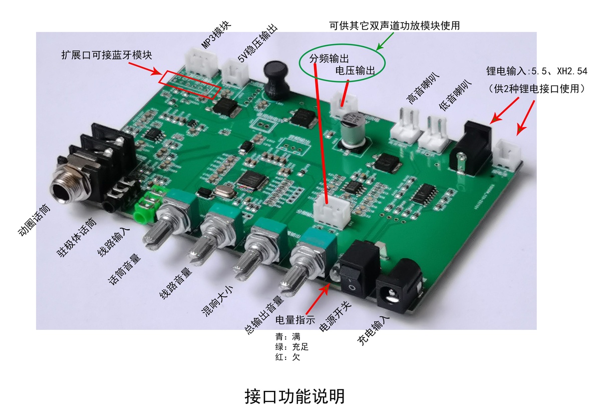

Circuit Introduction
The circuit consists of 7 parts:
1. DSP: Uses a MountainView AP8248 chip salvaged from a V8 sound card, mainly for its reverb and volume control.
2. MIC: Uses a low-voltage, low-noise op-amp (NE5532 in the circuit diagram, just using its package) salvaged from the sound card for microphone amplification. A low-voltage, low-noise LDO powers the op-amp and provides bias voltage for the electret microphone.
3. BT_AUX: Provides audio and power supply voltage interfaces for connection to Bluetooth modules.
4. Lithium Battery Power Indicator: Uses an LM339 for simple voltage detection, driving a 3-color LED to display the battery level. A full charge is cyan (blue-green light), gradually changing to green and then red.
5. Power Supply: Provides multiple voltage options and a power interface.

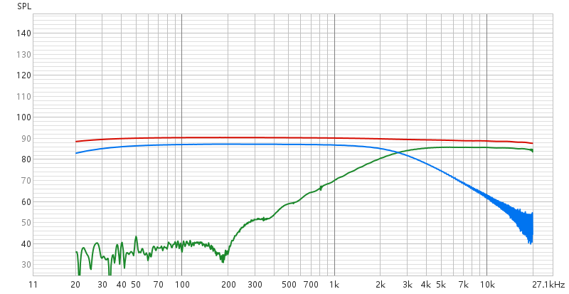

6. Active Crossover: Uses dual op-amps for high and low frequency crossover, with a crossover point around 2.6kHz. The measured frequency response diagram is shown below.
7. Power Amplification: The mainboard itself does not have a built-in amplifier; it only provides terminal interfaces corresponding to commercially available Class D amplifier modules, facilitating the selection of different modules. Stereo amplifier modules or dual-mono amplifier modules can be output to the two interfaces to connect to tweeters and woofers.

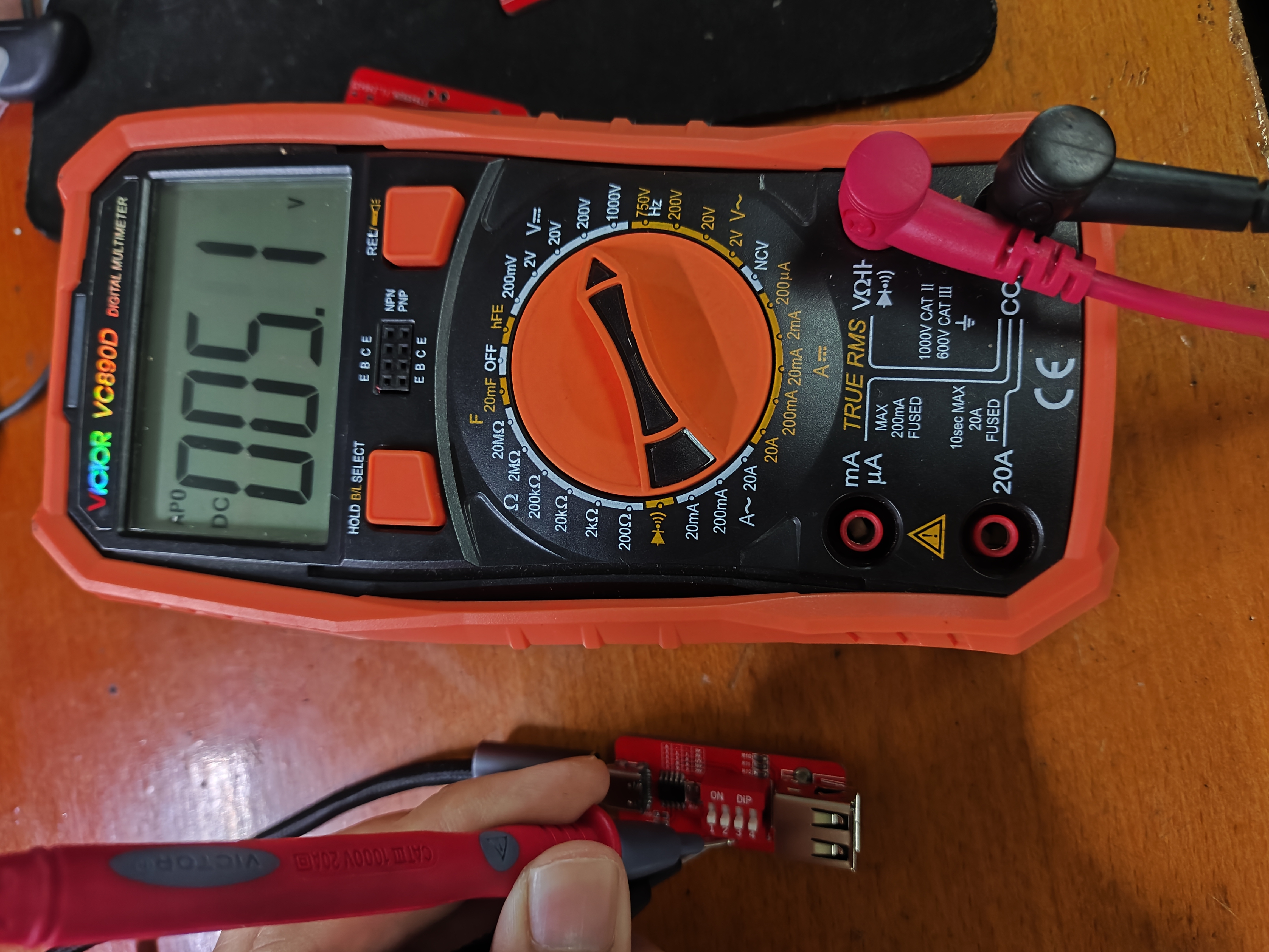

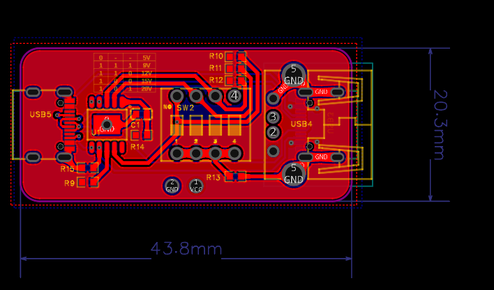

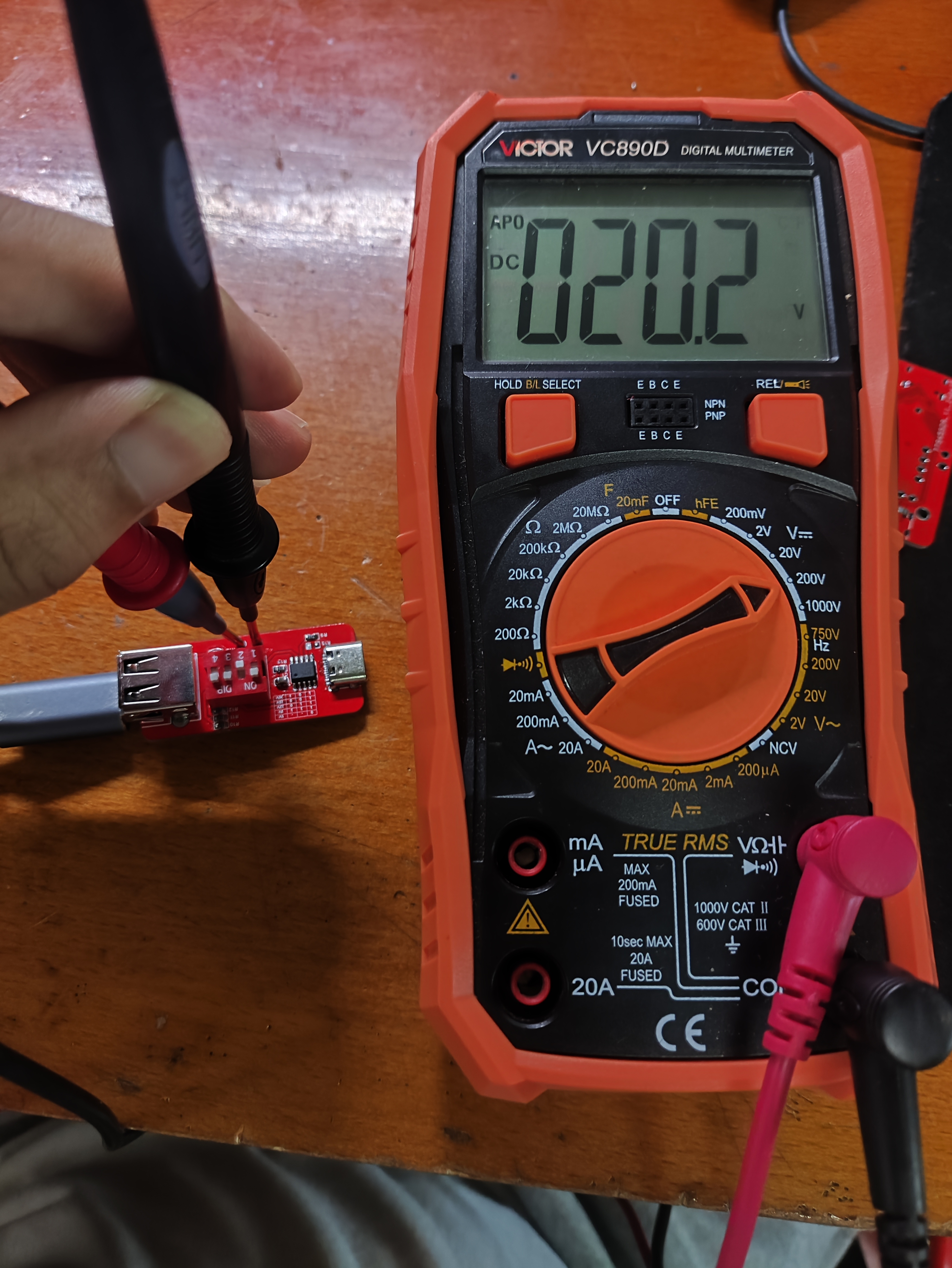

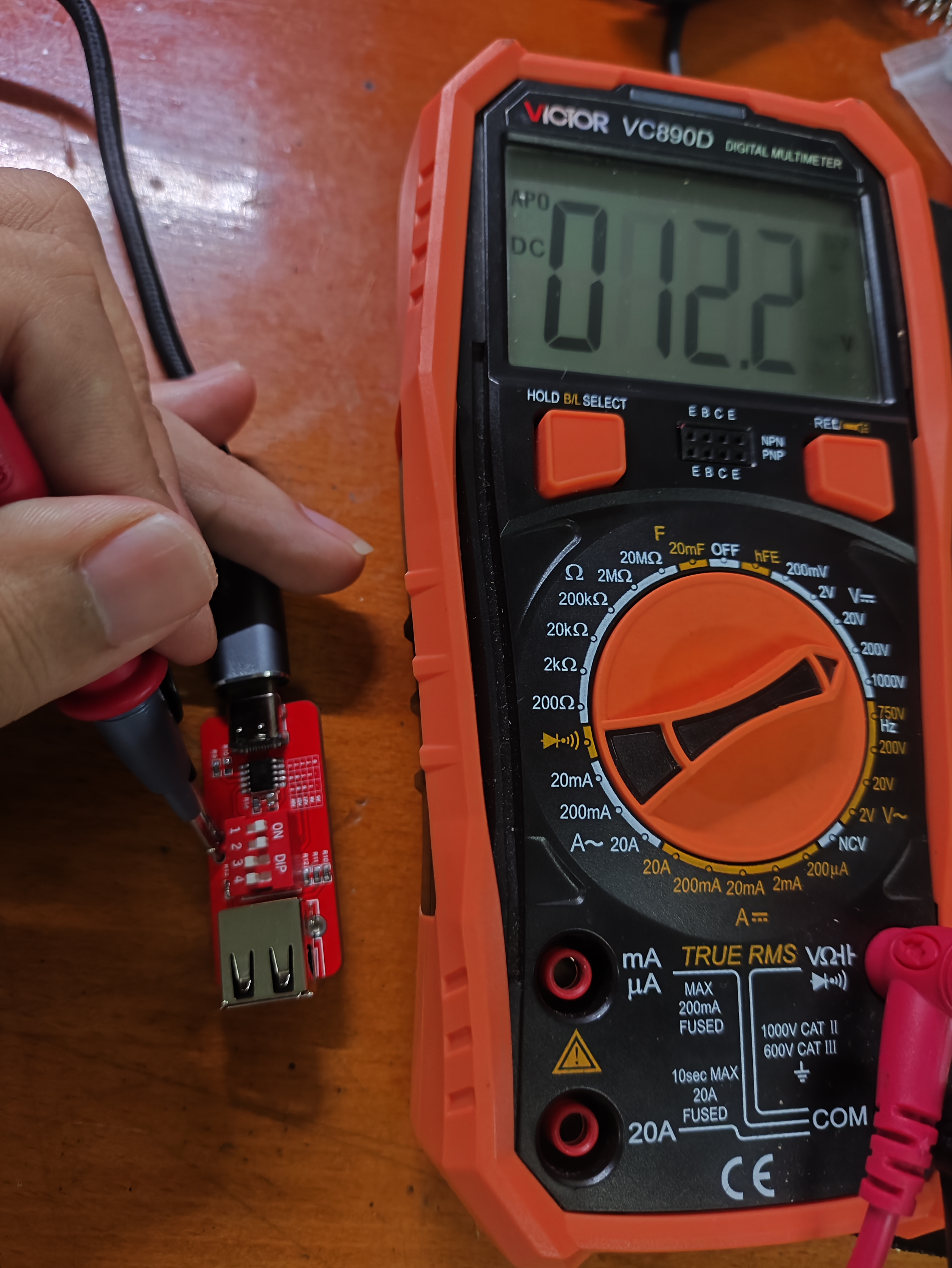

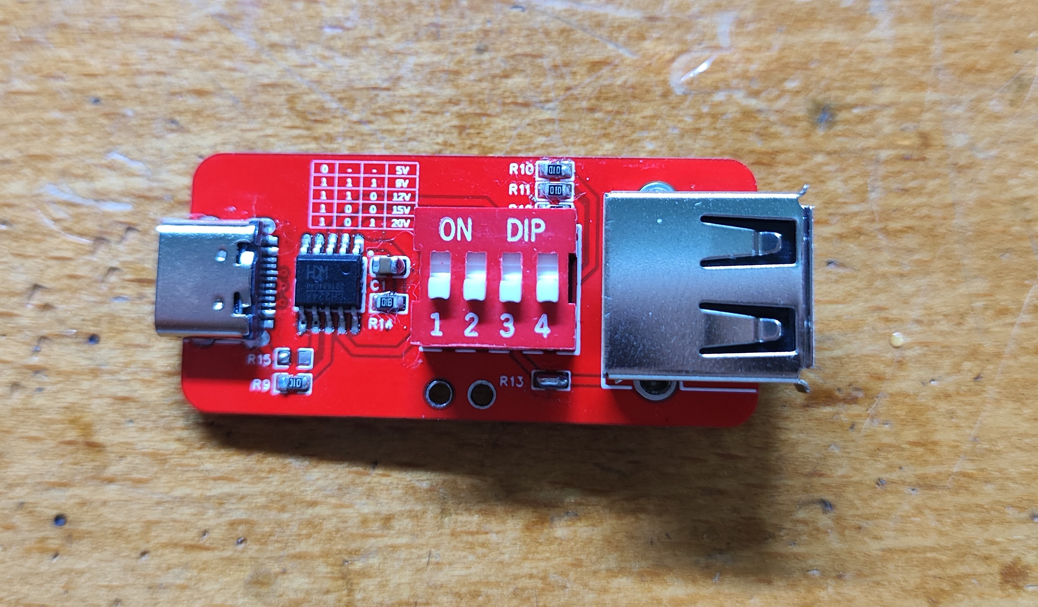

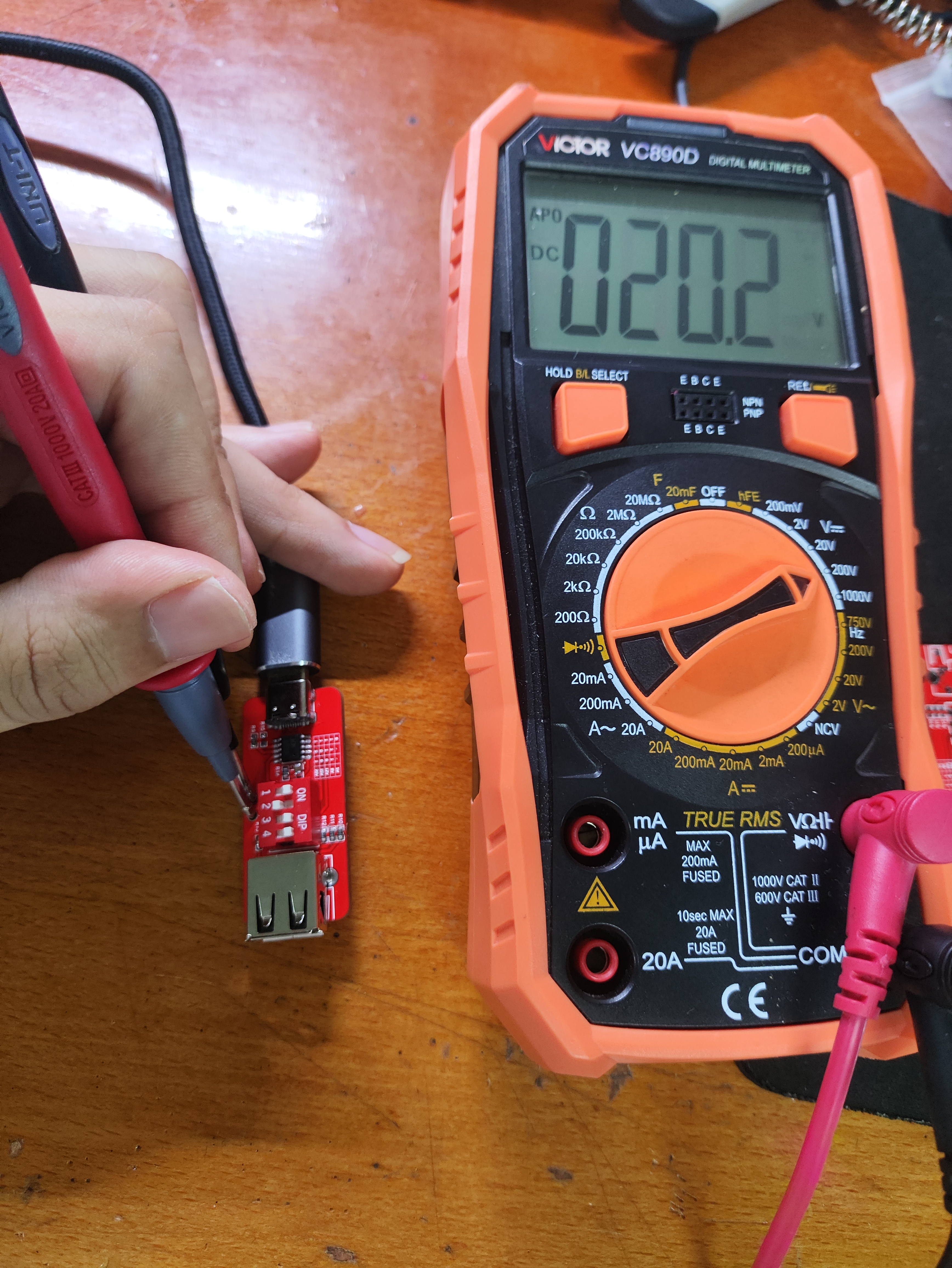

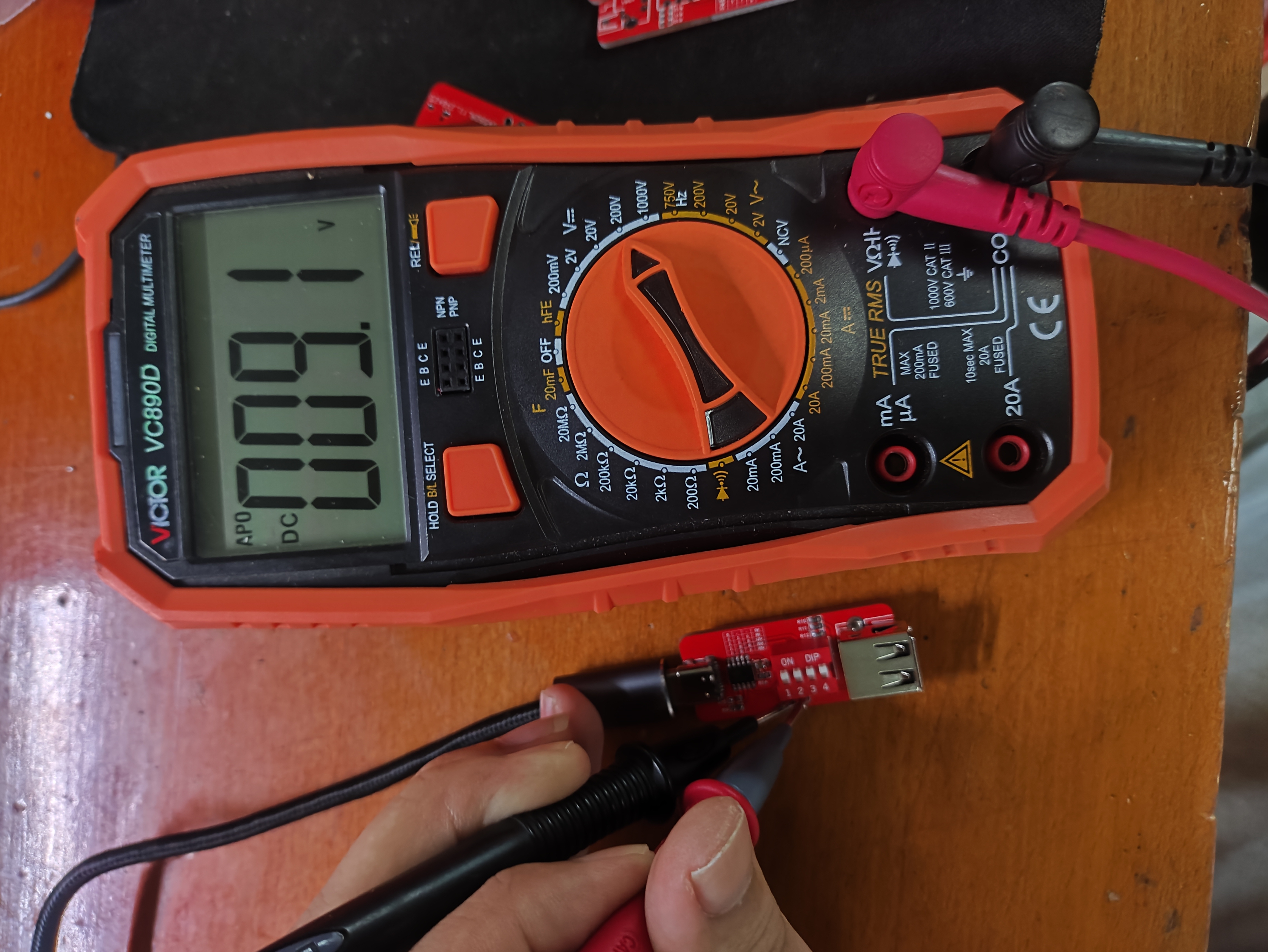

<Power Supply Project> Multi-Protocol Deceptive
It supports QC and PD3.0/2.0 protocols, with 5 adjustable output voltage levels from 5 to 20V, and theoretically supports an output power of up to 100W.
The design concept
involves creating a small, low-cost power supply device. The final choice was to use the CH224K chip as a decoy, along with a phone charger, to power other devices. Looking at other open-source projects using the CH224K, the single-resistor method only offered four voltage levels, while level configuration provides five.
The design is
a single-chip design using level configuration to output 5V, 9V, 12V, 15V, and 20V.

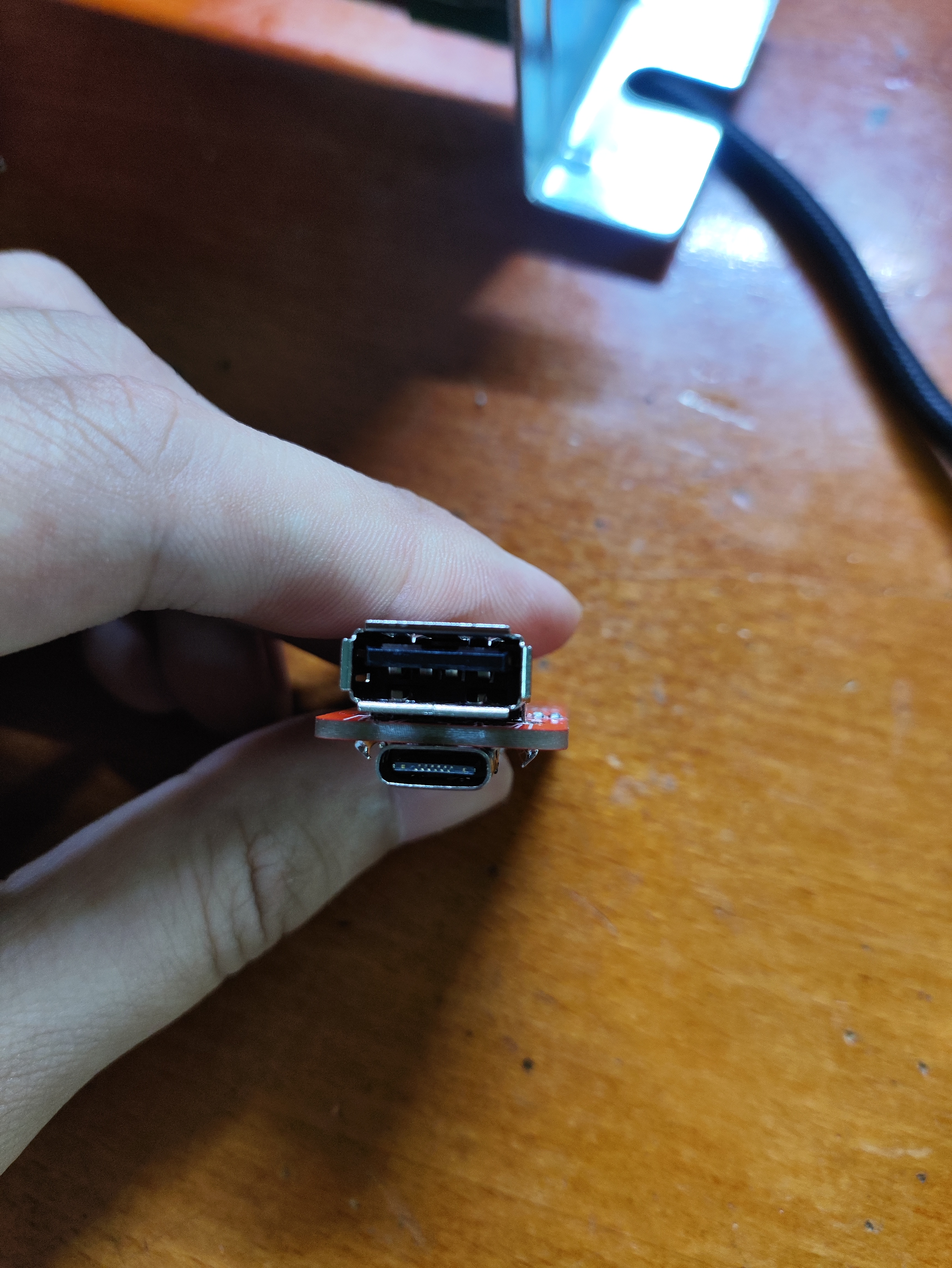

Both Type-C ports can be used as input/output ports simultaneously, and one USB-A port is for output only.
The overall cost is extremely low; the CH224K is only 1 RMB on Taobao. Only three DIP switches are used; a four-position switch would be even cheaper.
Note! The level configuration direction is reversed from the manual!
The original manual's method was somewhat unreasonable; pulling all switches low resulted in a default output of 9V.
When the switch is open, the default output is 5V.
The level configuration method is printed on the PCB.

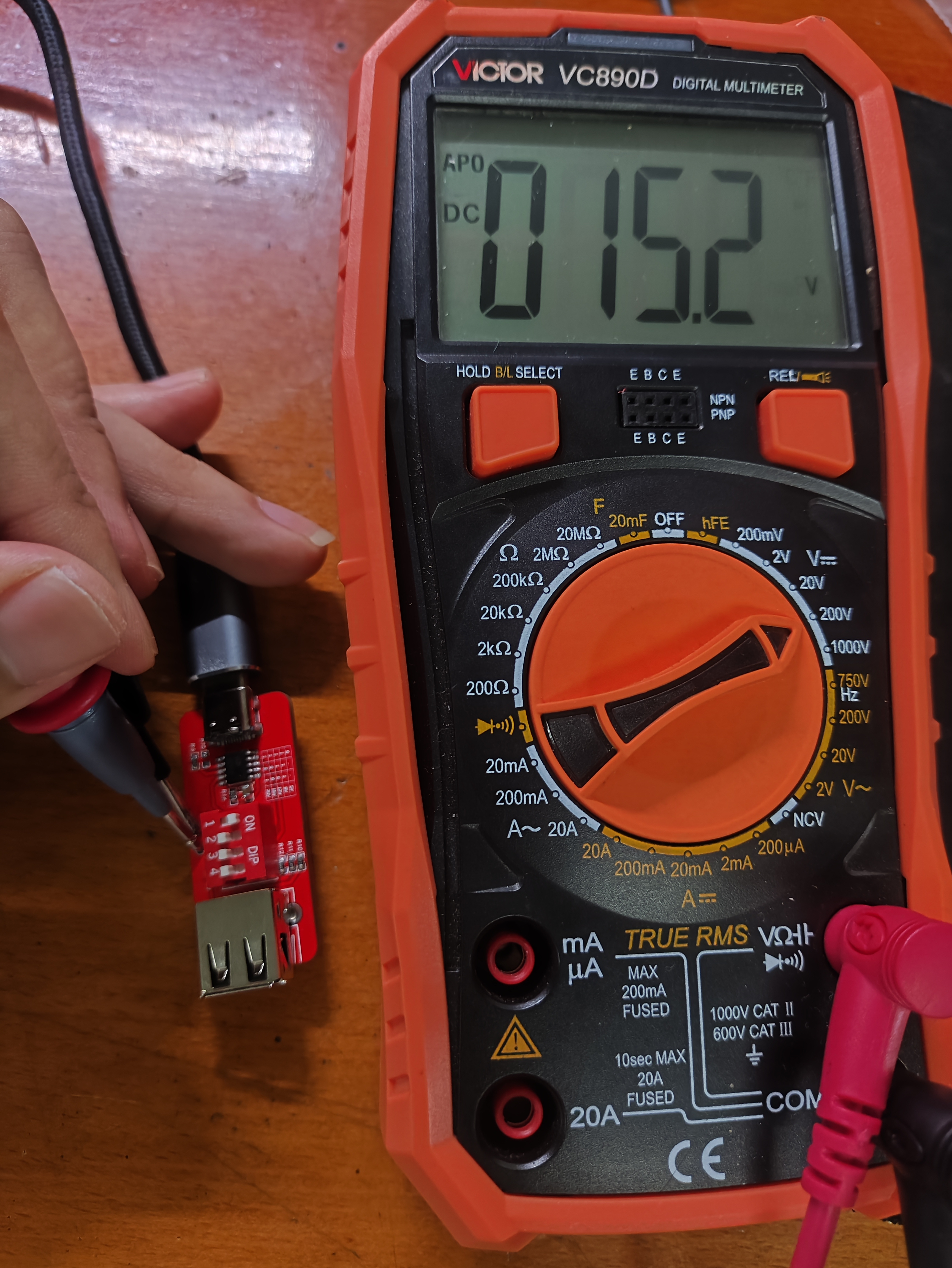

Testing showed 5V,
9V
, 12V
, 15V, and
20V
reverse input.

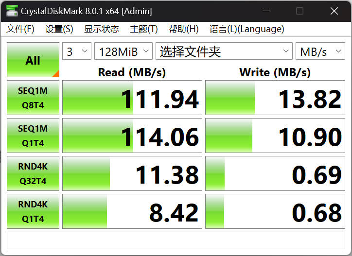

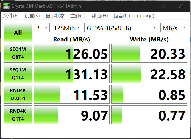

FC3379 QFN32 Minimum TSOP48 USB Flash Drive
The smallest TSOP48 single-chip USB flash drive based on FC3379 QFN32 (after all, it's only 1CE).
Why this project:
The FC3379, a new generation of "garbage king" (meaning it can run all sorts of bad games with decent speed), comes in three packages, the smallest of which, QFN32, only has 1CE channel.
The reason for this project was that I had some old junk chips on hand, and upon disassembling them, I found they were 1CE TSOP TLC NAND flash memory. With the help of my "thinking power," this project was born (?). (A BGA152 version will be released later (procrastination). Some details
referenced from Lost-terminal's project : a double-layer board was used for faster prototyping and to avoid wasting 4-layer board resources (if it's free, cherish it). Because the USB reinforcement pins would interfere with the TSOP pads, the package was modified. When soldering, you need to bend it outwards a bit (for example, the silkscreen markings 3 and 2 on the board indicate VCC 3.3V and VCC 2.5V respectively). `v` is used to switch the VCC power supply of the NAND flash memory. An additional 0R resistor or wire connection is required. All other components can be removed from the original board. It's recommended to use TLC NAND flash if possible, as MLC NAND flash, according to LT, will significantly slow down speeds. (PS: The components are very cramped, which may cause considerable difficulty for those with less skill in soldering. Adding solder paste or using a hot plate may help.) You can also change the silkscreen to your preferred design, although there's not much space left. The speed is almost the same as the original board. (I don't know why the CDM write speed test is much slower than the actual speed.) Never use an ASSSD to run 4K, otherwise it will overload the 3379 firmware, causing a drastic speed drop, requiring a re-opening of the chip. The opening tool for the single-chip chip can be found on the official website: http://www.szfirstchip.com/col.jsp?id=142 FT64B08UCT2-08 (Jinshidun self-labeled Toshiba BICS5, single CE, 64G) full drive direct write speed is stable with no speed drop, occasionally fluctuating significantly. FT32B08CN1-47 (Jinshidun self-labeled B16A, single CE, 32G) full drive direct write speed is stable with no speed drop, almost a straight line (don't ask why the name is LostLabs because it was directly opened using LT's tools x).
