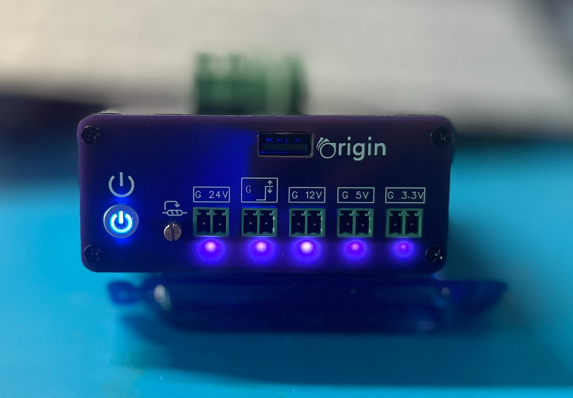

Multi-channel desktop auxiliary power supply
The scenario in which this product was created is as follows:
Sometimes when you're testing something and need a power supply, you either can't find one or the voltage is unsuitable. You have to search and search through a bunch of power supplies! This
includes PD power supplies, which require both tricking and PPS voltage regulation, or there's no adapter available. It's still inconvenient, so you just cobble together a random auxiliary power supply to display and then toss it aside for testing...
This product is suitable
for product verification and debugging,
toy repair,
small signal repair,
DIY applications, and other scenarios
! The product has been verified 24/7!

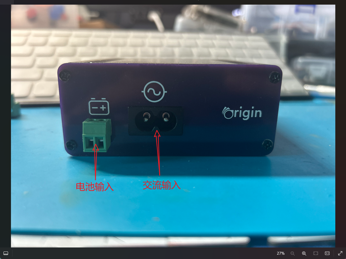

Electrical Parameters
Input Power Voltage: AC: 220V or DC:
AC Input Protection: Yes

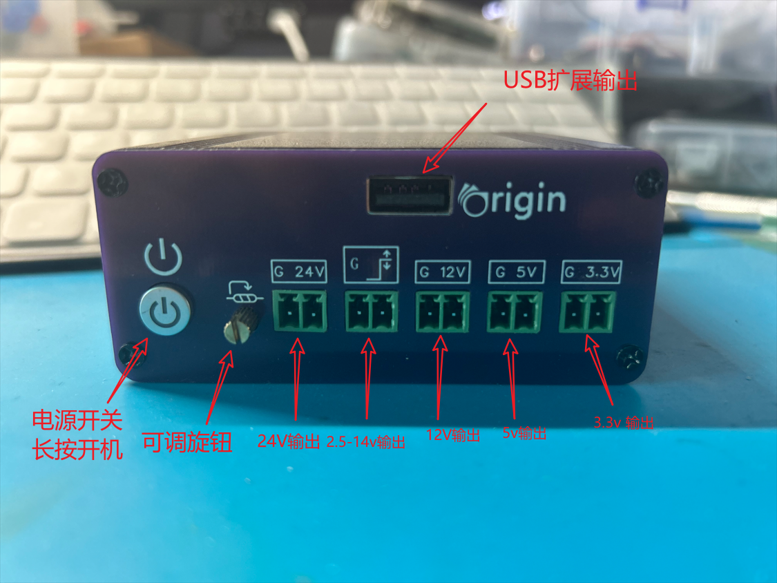

Output Fixed 1: 24V 0.83A Max
Output Fixed 2: 12V 1.66A Max
Output Fixed 3: 5V 2A Max
Output Fixed 4: 3.3V 2A Max
Adjustable 1: 14V 1.42A Max
Function Details (with pictures)

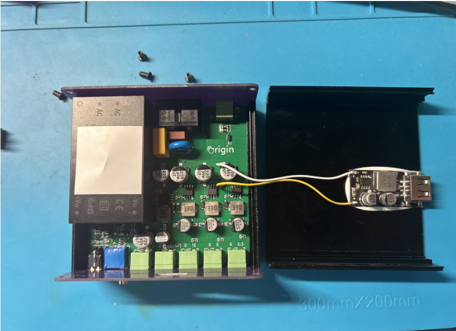

Precautions
: Contains high voltage. Do not disassemble or manufacture if you are not a professional.
Caution: High voltage input!
Caution: Soldering direction!
