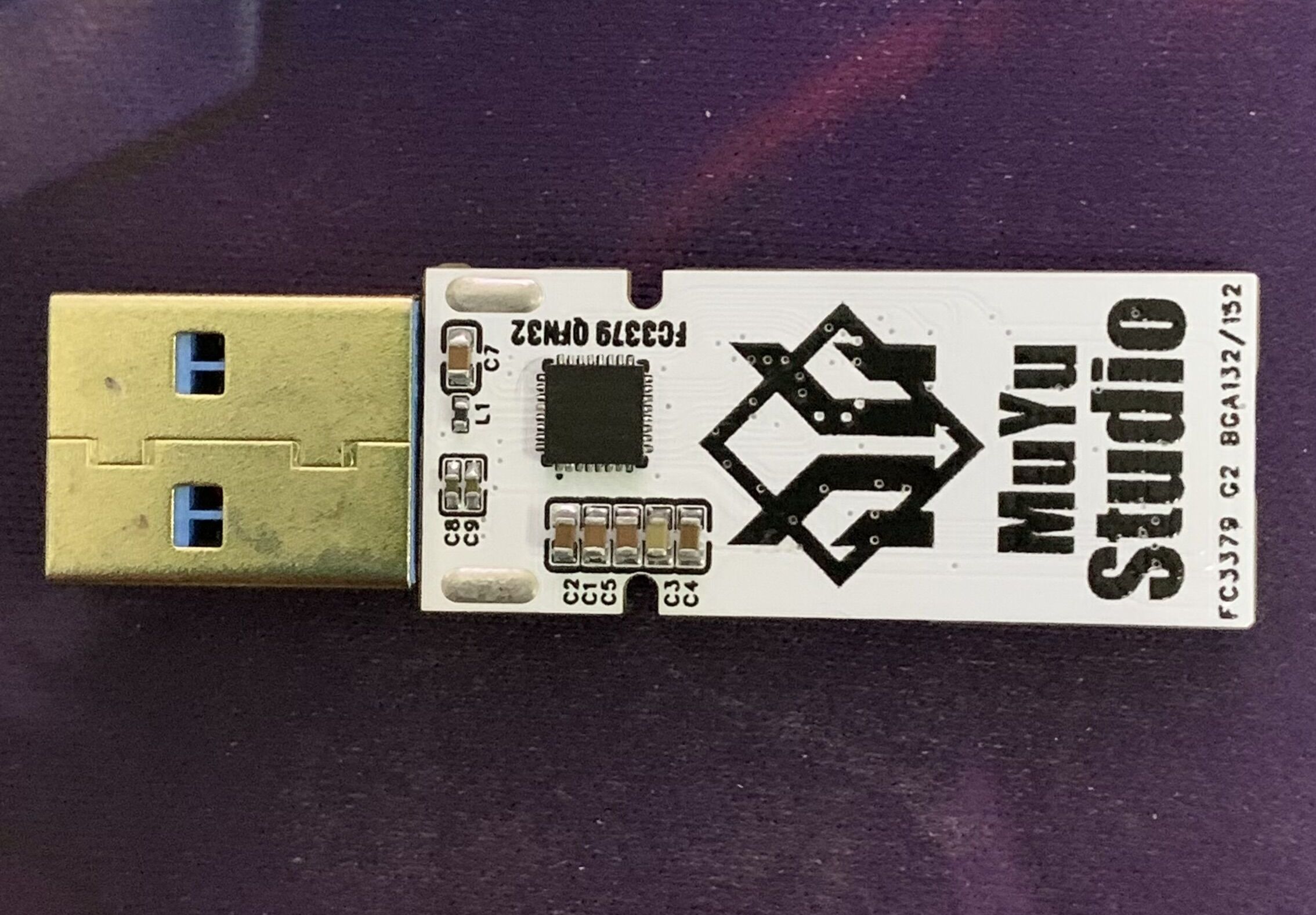

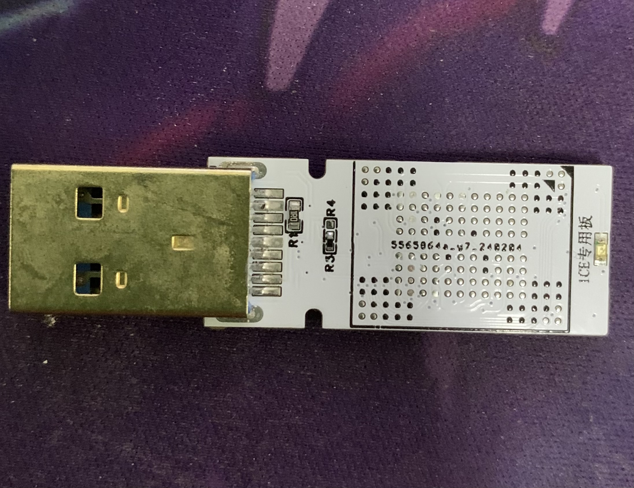

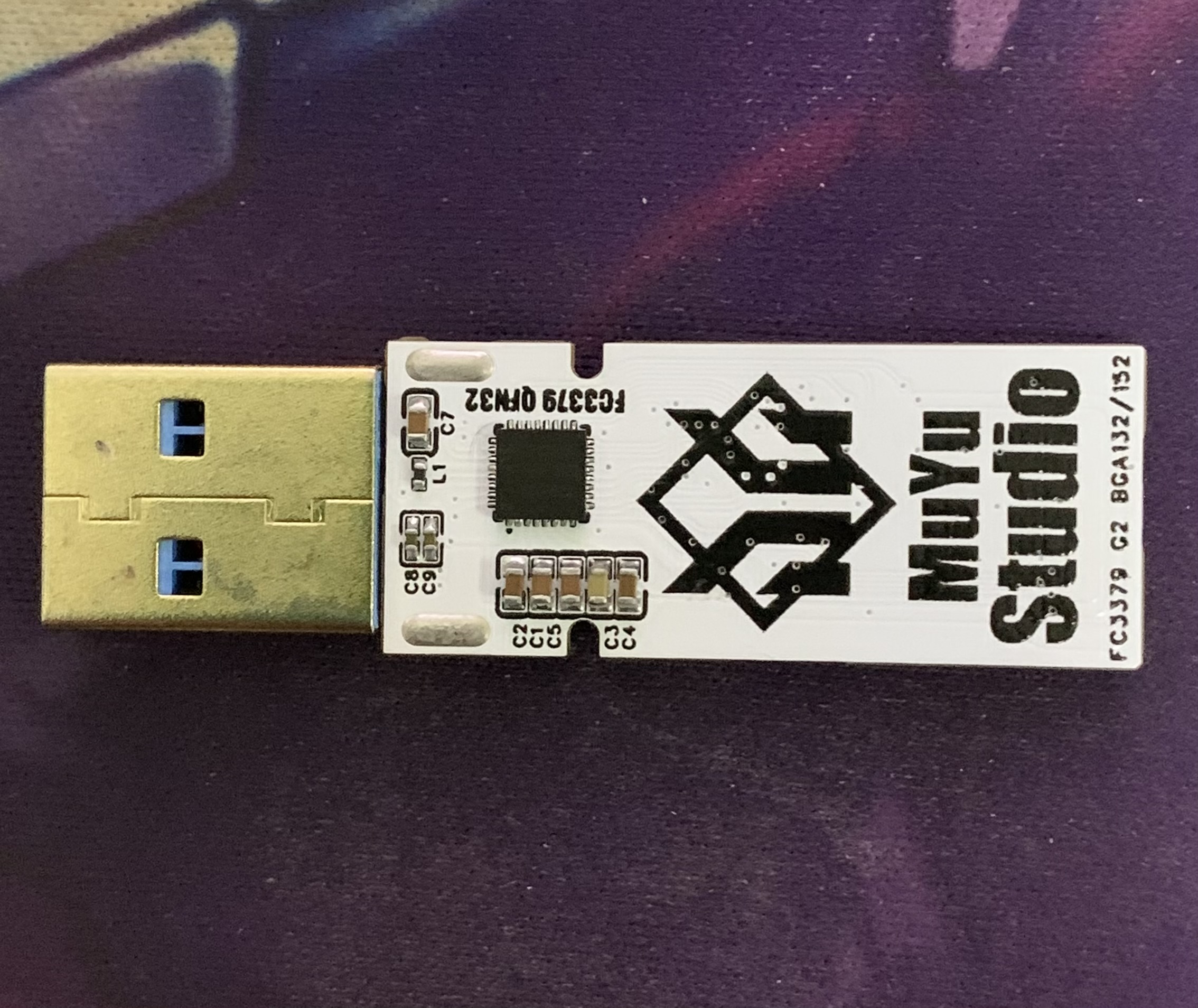

I saw an open-source FC3379 QFN32 1CE single BGA 132/152 module
by the expert @Lost_Terminal in a group chat. The test results looked good. Here's the link: https://oshwhub.com/hellrock/fc3379g2-version-u-disk.

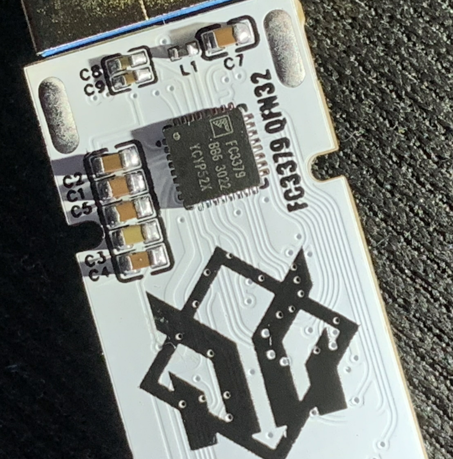

I bought a few FC3379 controller boards and modified his project to create a single BGA version, which is much simpler. The 4.7uF and 10uF capacitor pads were changed to 0603, making manual soldering easier; you can't just move the board directly anymore! ( See
attached image ) . Currently, I don't have suitable flash memory yet; I'm testing controller recognition and speed later...
