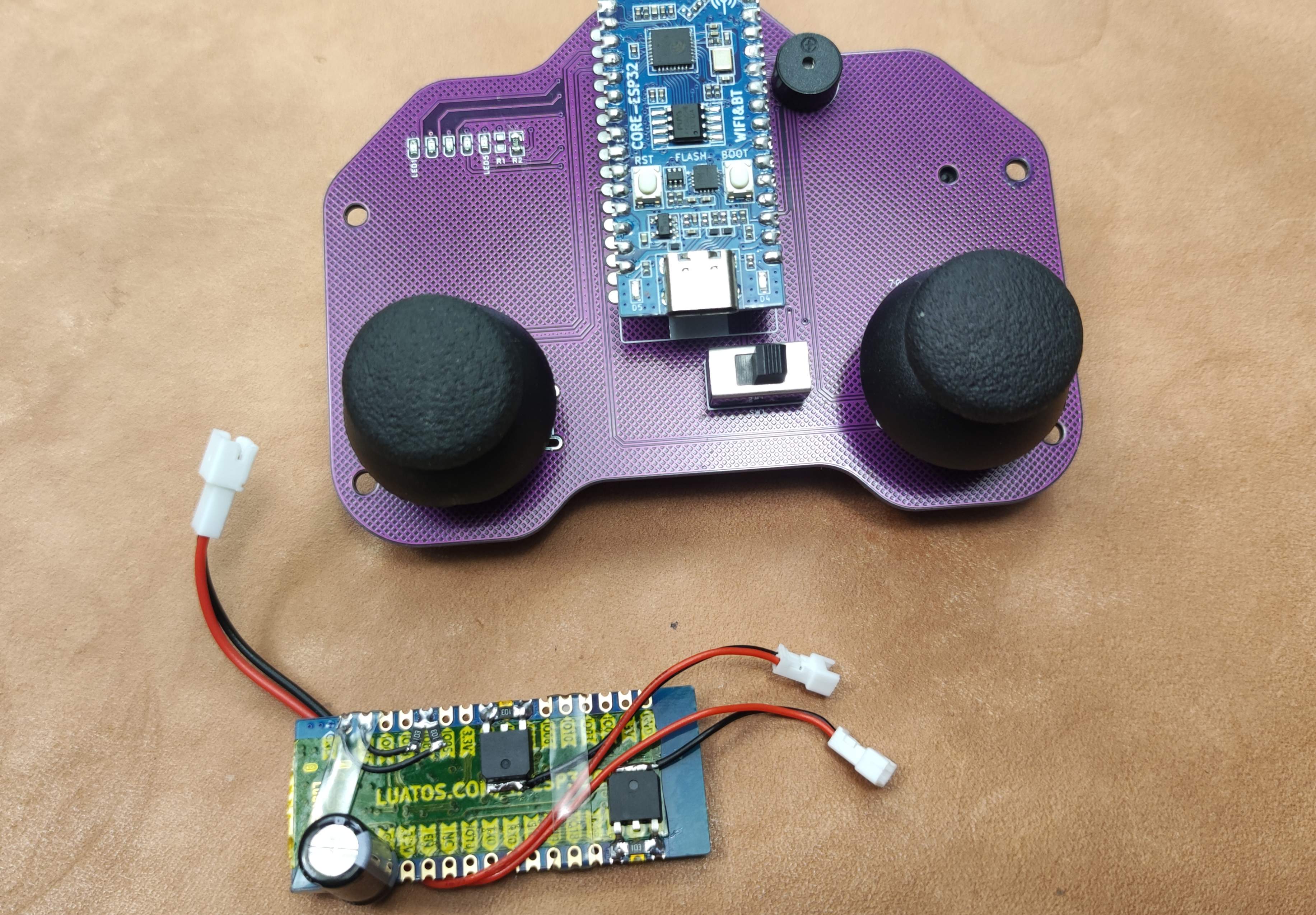

This is an ESP32 C3 remote control controller, a derivative work based on the work of Bilibili UP: 攀哥define.
1. It can be used for small model airplanes, cars, etc. The program uses Espressif's ESP-NOW protocol; please refer to 攀哥define's case study for the program.
2. The PCB design uses the Heze C3 development board. Considering that remote control doesn't consume too much power (relatively speaking), there is no charging circuit on the controller.
3. Power selection is only achieved through the interference between the switch (SS12D10) and the TYPE-C port (the switch must be in the off position when the USB data cable is plugged in) to ensure power safety.
4. The appearance is inspired by Bilibili UP: saturrn圣骑土; thanks to them for sharing.
