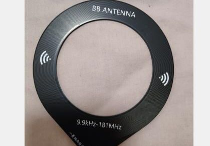

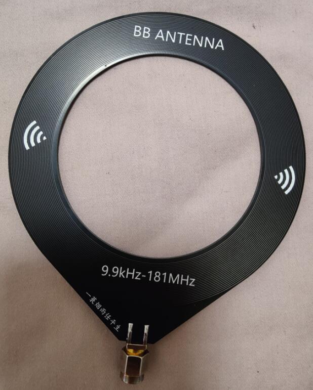

Wideband small loop antenna
The PCB traces act as coils, with an inductance of approximately 440uH calculated in simulations, equivalent to a ferrite rod antenna. However, due to the low self-resonant frequency, it is estimated that above the self-resonant frequency, it will function as an electric field antenna, also providing some gain.
参考设计图片
