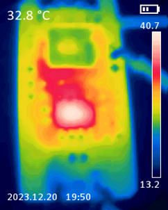

Charging temperature

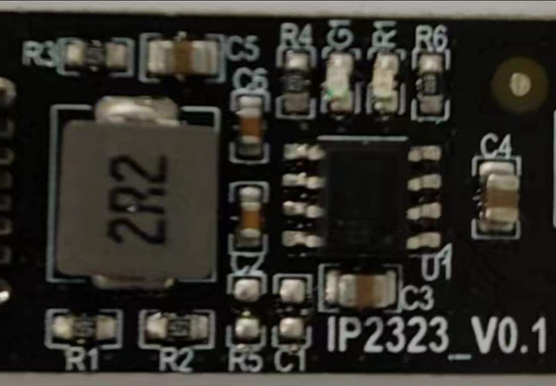

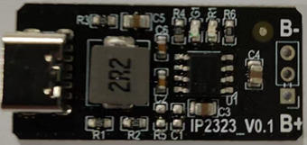

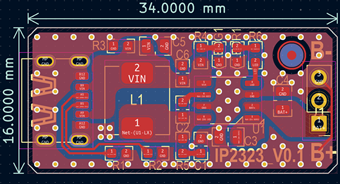

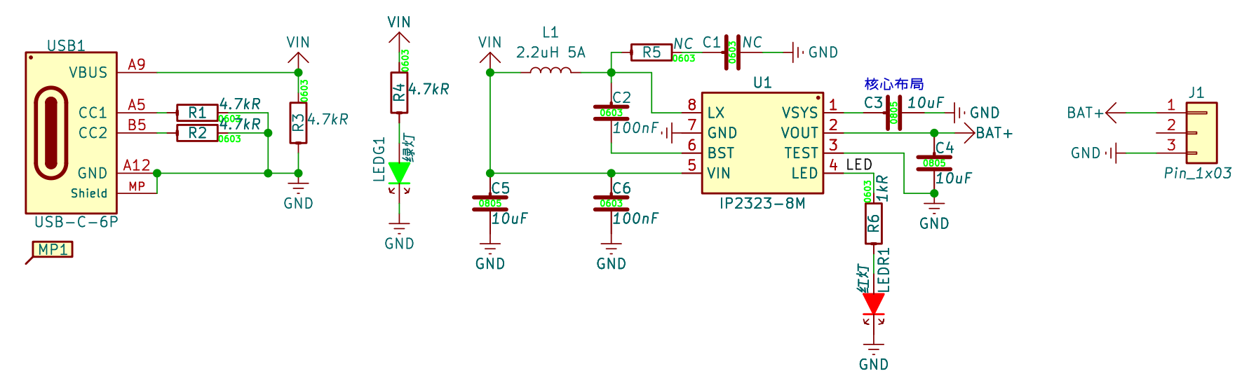

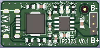

. Schematic diagram
, PCB layout,
PCB 3D preview,
PCB physical image.
