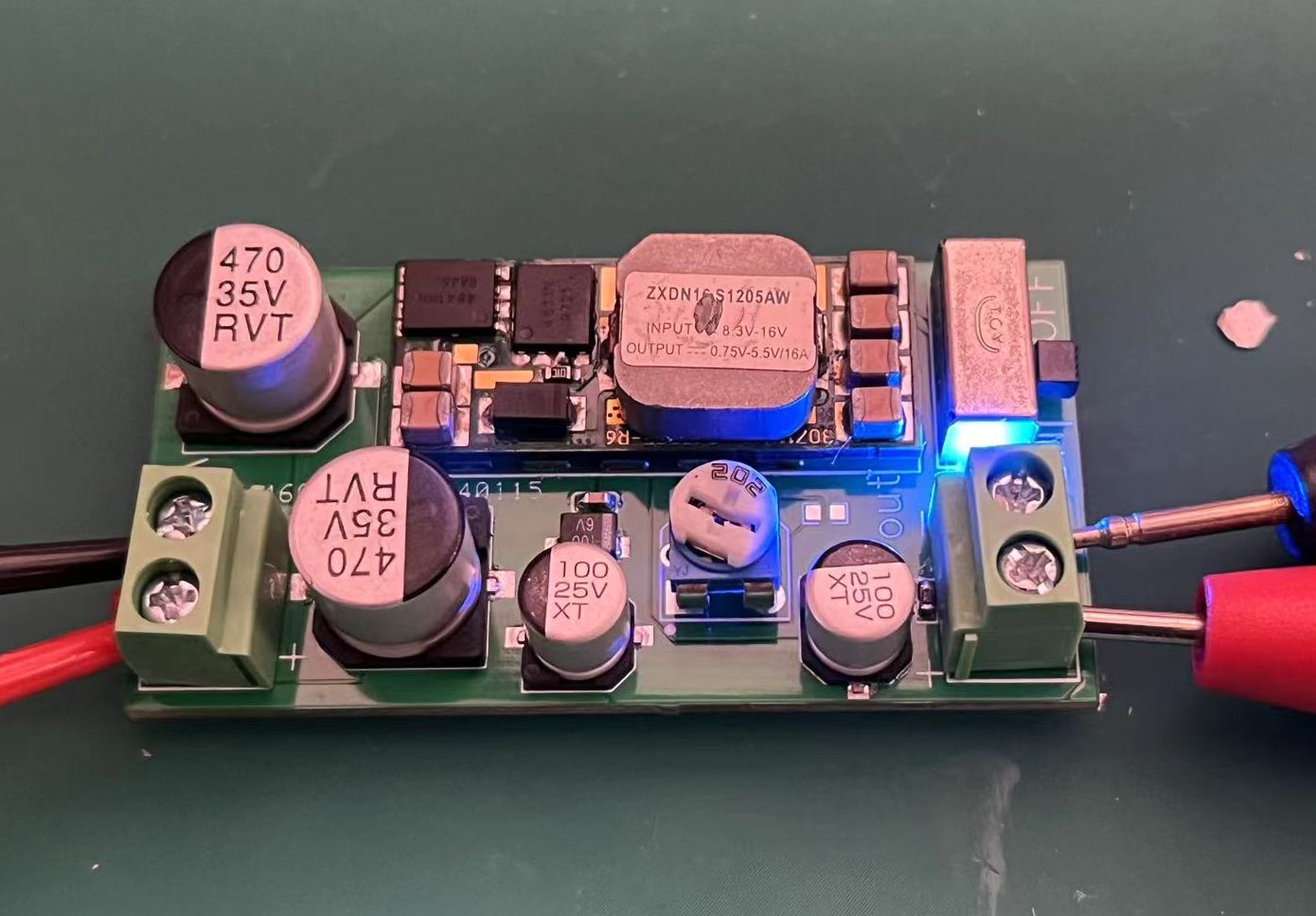

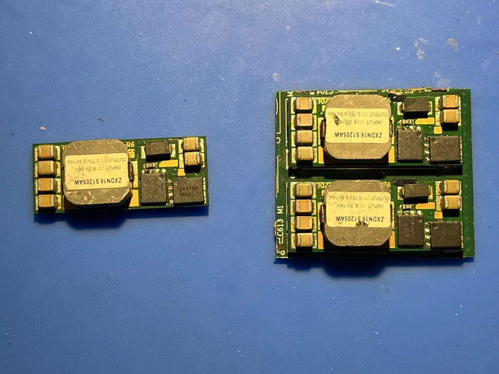

       On the secondhand trading platform Xiaohuangyu, I found a very affordable ZTE DC-DC non-isolated power module for only 4 yuan. The main function of this power module is to convert 12V to a stable 5V output, with a maximum allowable input voltage of 16V and a maximum output current of 16 amps. Notably, it also features adjustable output voltage. If voltage adjustment is not needed, simply solder a fixed resistor R1 with a resistance of 1.35kΩ. This allows the module to demonstrate good compatibility and practicality in various application scenarios.

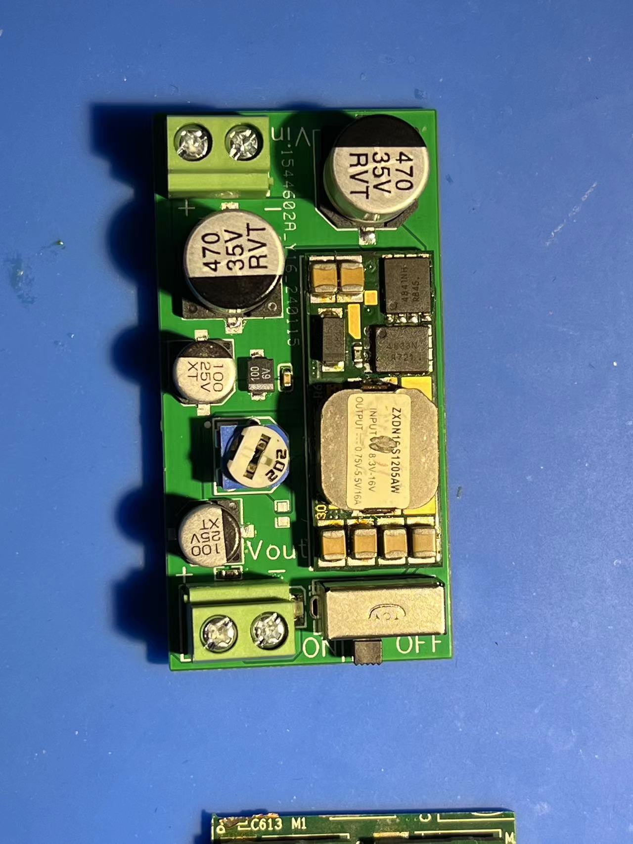

       To facilitate use, I have designed a matching expansion board schematic, which you can directly use for PCB fabrication or modify the interface configuration according to your needs. Theoretically, upgrading the internal capacitors to 1000µF would further reduce output voltage ripple.

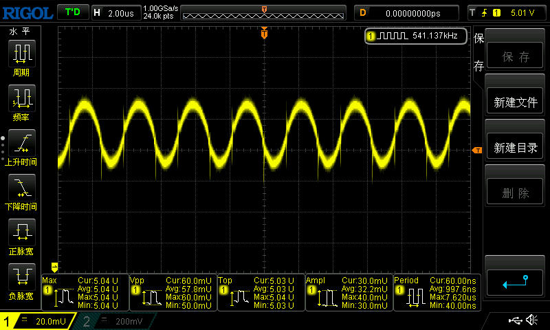

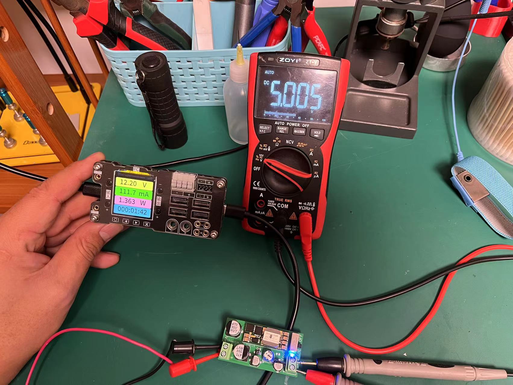

       Under my current testing conditions, the peak-to-peak output ripple of this power module under no-load conditions reached 60mV. It should be noted that due to limitations, these measurements were obtained under no-load conditions. Meanwhile, I also observed that the module's quiescent current is approximately 110 mA when no device is loaded, which translates to a quiescent power consumption of about 1.3 watts. It also exhibits slight heat generation during operation.
Despite these issues, considering its price and basic performance, this ZTE power module still offers high cost-effectiveness and is a worthwhile option.
       When purchasing, it is particularly important to note that to ensure correct installation and use, it is strongly recommended to choose the version with the original baseboard, as original pins are required.
       Furthermore, there are many other affordable power modules available on the platform. However, please be aware that this power module is a non-isolated design, meaning there is no electrical isolation between the input and output. Therefore, circuit safety and system design requirements must be carefully considered in specific applications. Regarding the extended version, there is no technical aspect to it; users can modify it according to their actual needs.
