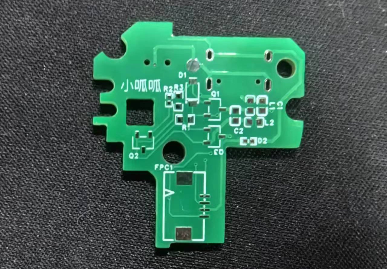

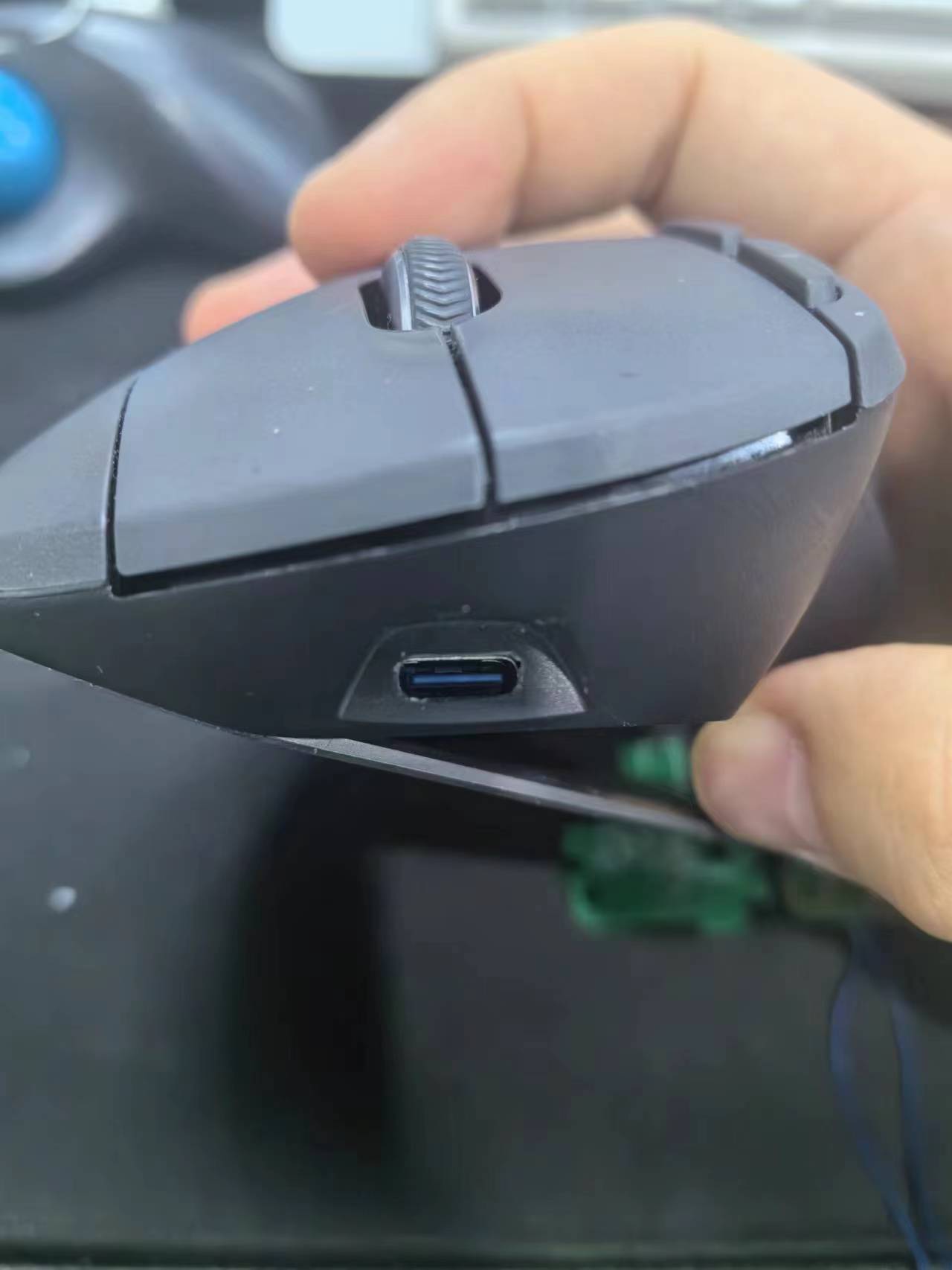

To completely eliminate micro USB cables and only use Type-C cables on my desk, I decided to modify my current mouse as well.

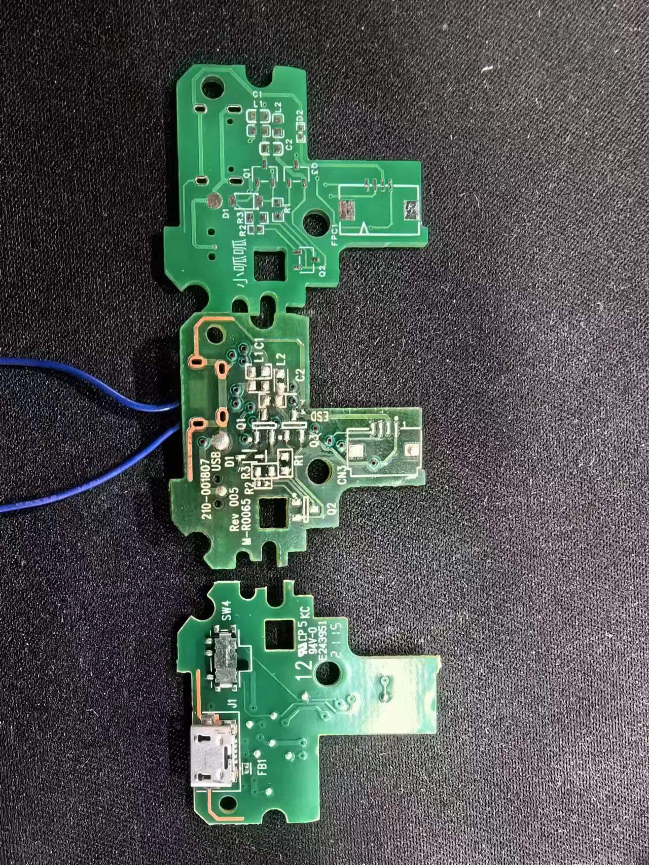

So I bought an original USB charging board and spent some time copying the circuit board.
The components were simply copied according to the silkscreen markings. Alternatively, you can choose to solder only the Type-C connector, FPC connector, and switch; the other circuitry, including the ESD protection circuitry, is unnecessary.

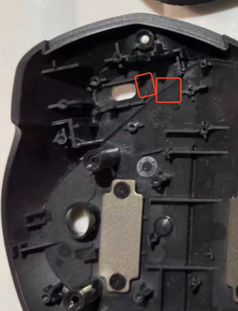

During installation, the bottom shell and USB port need to be sanded. The areas on the bottom shell that need sanding are shown in the image.
