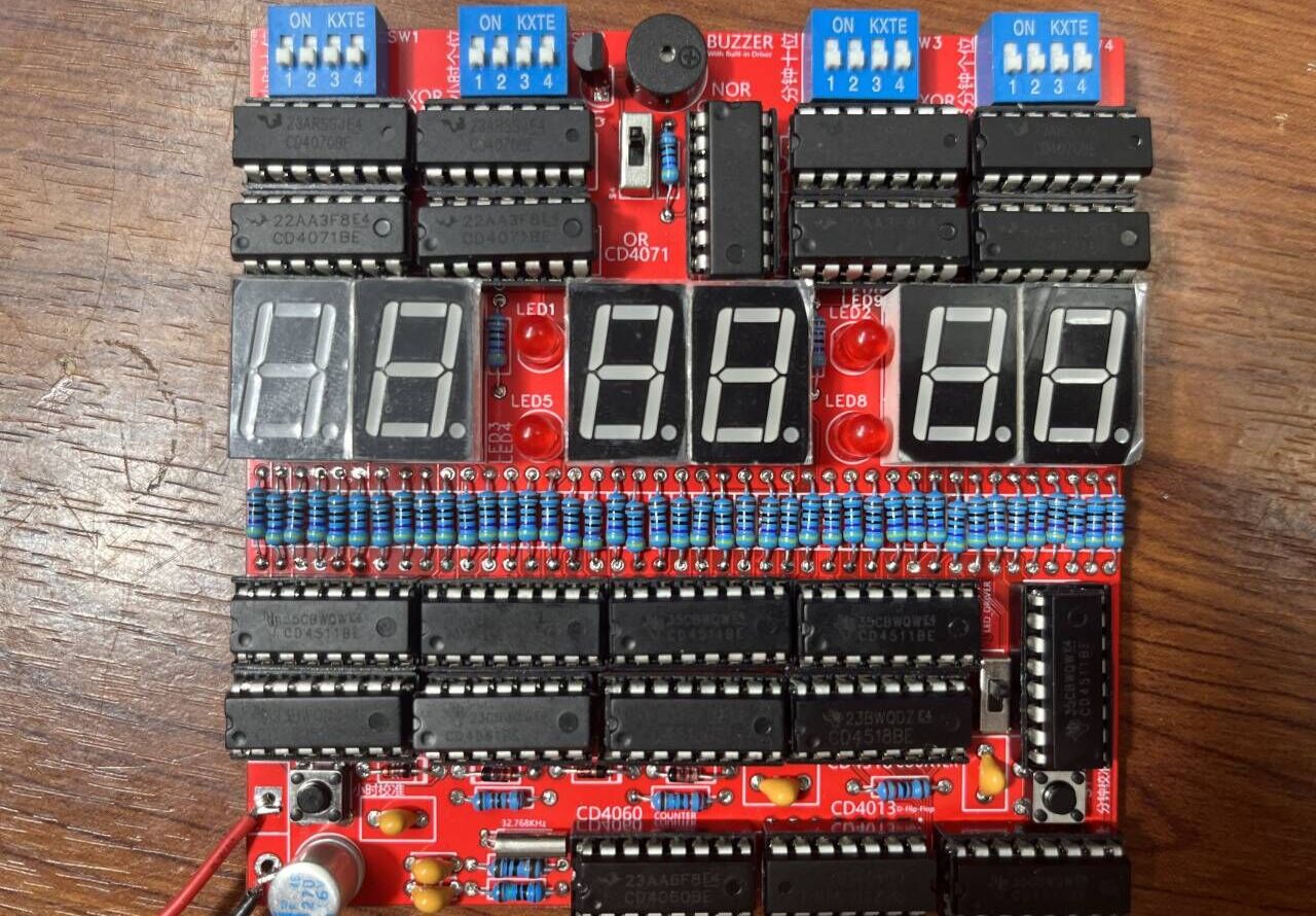

This is a purely digital clock and alarm clock,
both using CD4000 series CMOS chips
with a common cathode. The 0.56-inch digital display
uses a 32768Hz crystal oscillator and frequency divider to form an oscillation circuit
, allowing for time calibration, pausing the seconds, setting the alarm time, and turning the alarm off.
The operating voltage is 5V; do not exceed this voltage.
There is no reverse connection protection; reverse connection will burn out the circuit.
The PCB size is 10*10mm, and it meets the free opportunity requirement with
16 0603 surface-mount pull-down resistors
. The PCB traces are loose; only each component is connected.
This has been verified.
