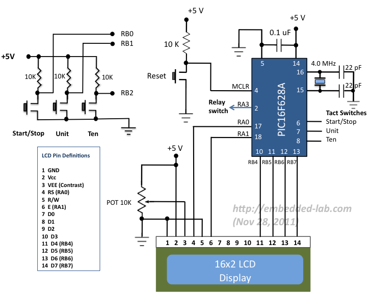

This is a 0-99 minute relay timer using a PIC16F628 microcontroller and a 16-character LCD display. The microcontroller is a PIC16F628A, running at a 4.0 MHz clock speed and using an external crystal. The 16×2 character LCD based on the HD44780 is the main display unit of the project. You can view and set the timer duration via haptic switches. There are three haptic switches connected to the RB0 (start/stop), RB1 (units), and RB2 (tens) pins. You can use the unit and tens minute switches to select the timer interval from 0 to 99 minutes. The start/stop switch is used to toggle the timer on and off. When the timer is on, a logic high signal appears on the RA3 pin, which can be used to turn on the relay. The circuit diagram for this project is shown below.

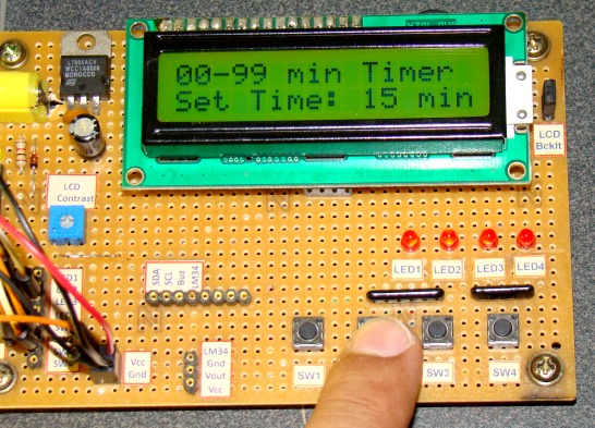

You can use the unit and ten-digit haptic switches to set the time duration from 00 to 99 minutes (in 1-minute increments). Each press of the switch increments the corresponding time number.
Set timer minutes

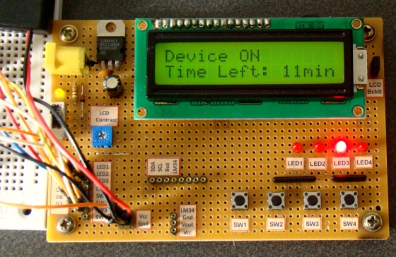

After setting the desired time, press the start/stop switch to start the timer. The RA3 pin goes high (LED illuminates), and the countdown begins. While the timer is running, the remaining time will also be displayed on the LCD screen. When the time is up, the timer stops, and the LED turns off. You can interrupt and stop the timer at any time by pressing the start/stop switch again.
Display the remaining time on the LCD.
