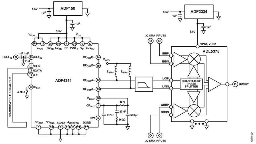

Figure 1. Direct conversion transmitter (schematic diagram: all connections and decoupling not shown)

The circuit shown in Figure 1 uses a fully integrated fractional-N PLL IC ADF4351 and a wideband transmit modulator ADL5375 . The ADF4351 provides the LO signal to the transmit quadrature modulator ADL5375, which upconverts the analog I/Q signal to an RF signal. Together, the two devices provide a wideband baseband I/Q to RF transmit solution. The ADF4351 is powered by an ultralow noise 3.3 V ADP150 regulator for optimal LO phase noise performance. The ADL5375 is powered by a 5 V ADP3334 LDO. The ADP150 LDO's output voltage noise is only 9 μV rms, helping to optimize VCO phase noise and reduce the effects of VCO pushing (equivalent to power supply rejection).

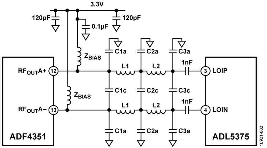

The schematic diagram of the filter is shown in Figure 3. This topology is flexible and can use a fully differential filter to minimize component count, a single-ended filter for each output, or a combination of the two. We found that for higher frequencies (>2 GHz), the series inductance value of two single-ended filters is twice the inductance value of a fully differential filter, thus reducing the impact of device parasitics and providing optimal performance. For lower frequencies (<2 GHz), fully differential filters are sufficient.
The ADF4351 output matching includes the Z BIAS pull-up resistor, and the decoupling capacitor of the power node also plays a role. To achieve broadband matching, it is recommended to use a resistive load (Z BIAS = 50 Ω) or to connect a resistive load in parallel with the reactive load of Z BIAS . The latter provides slightly higher output power, depending on the inductor chosen. Note that the shunt resistor can be placed at C1c as a differential component (i.e., 100 Ω) to minimize board space (see Type B filter in Table 2).
Design the filter so that the cutoff frequency is approximately 1.2 to 1.5 times the highest frequency in the band of interest. This cutoff frequency allows some margin in the design because typically the cutoff frequency will be lower than the design value due to parasitic effects. Printed circuit board (PCB) parasitics can be simulated in electromagnetic (EM) simulation tools for improved accuracy.
Figure 3. ADF4351 RF output filter schematic

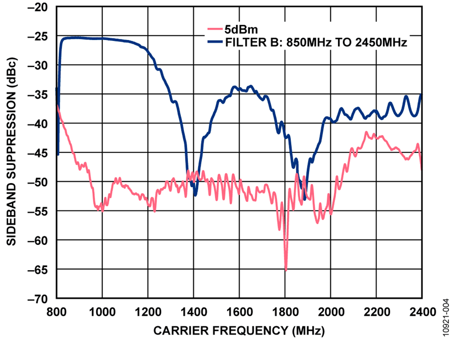

Figure 4. Sideband suppression of type B filter (850 MHz to 2450 MHz)
Figure 5. EVM diagram
For a circuit using a Type B filter (800 MHz to 2,400 MHz), the sideband suppression performance versus frequency is shown in Figure 4. The test conditions for this scan are as follows:
  • Baseband I/Q amplitude = 1 V pp differential sine wave in quadrature with 500 mV (ADL5375-05) DC bias
  • Baseband I/Q frequency (f BB ) = 1 MHz.

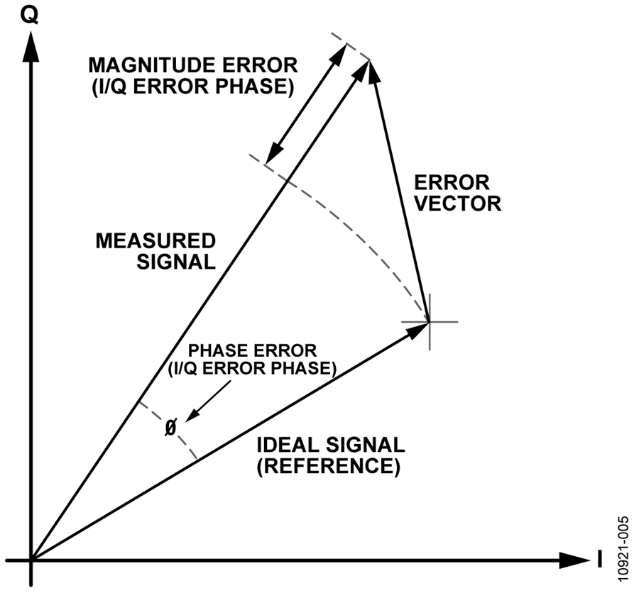

EVM is a measure of the performance quality of a digital transmitter or receiver, reflecting the deviation of actual constellation points from their ideal positions due to amplitude and phase errors (see Figure 5).

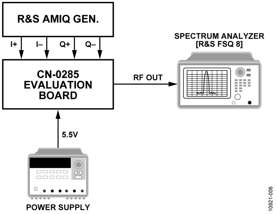

Table 3 shows the EVM measurement results with and without filter. In this example, the baseband I/Q signal is generated from the differential I and Q analog outputs using 3GPP test model 4 using a Rhode & Schwarz AMIQ I/Q modulation generator. A type B filter is also used. Figure 6 is a block diagram of the EVM test setup. For comparison, the ADF4350 was also measured. The lower EVM of the ADF4351 due to improved in-band PLL noise performance can be seen in Table 3. Other factors that improve EVM include the ADF4351's lower phase frequency detector (PFD) spurious levels.

Figure 6. EVM measurement setup (schematic diagram)

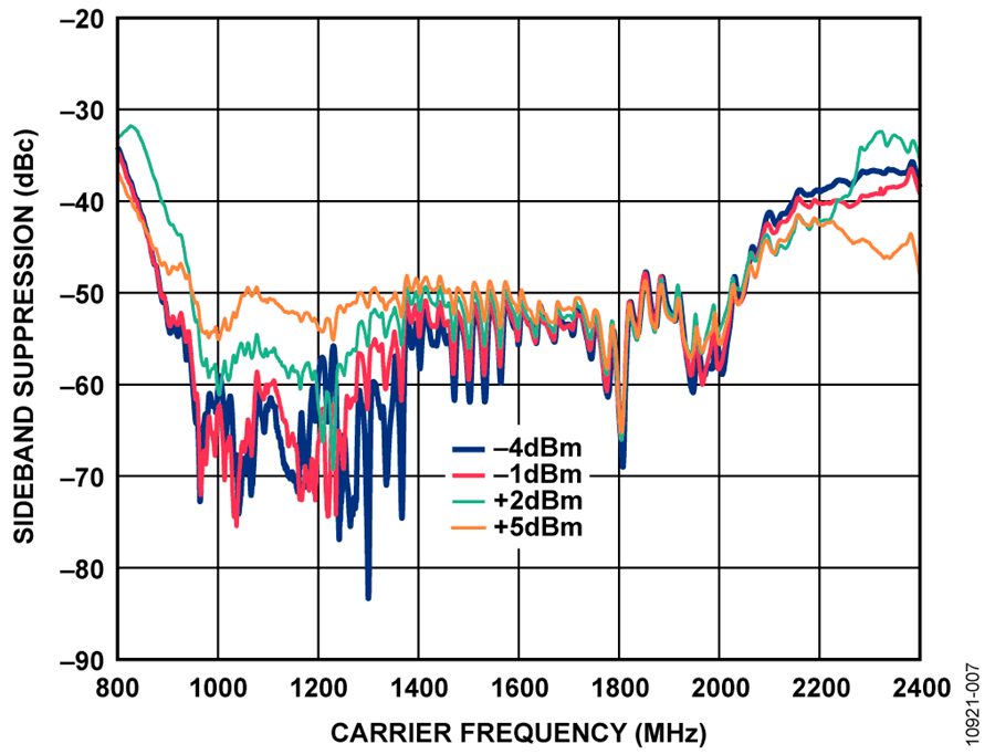

Figure 7 shows the sideband suppression results using an 850 MHz to 2450 MHz filter (Type B filter).
Figure 7. Sideband suppression results for 850 MHz to 2450 MHz, Type B filter.
