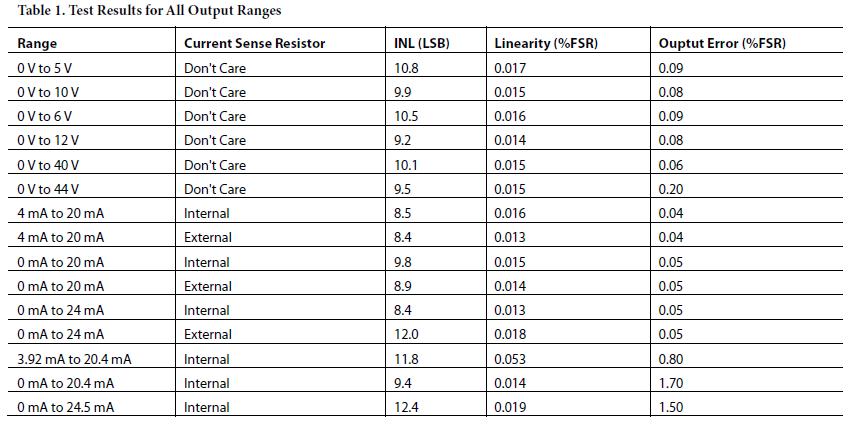

For PLC, DCS and other process control systems, integral nonlinearity (INL), differential nonlinearity (DNL) and output error are the most important performance indicators. The AD5751 has a very flexible and configurable output range to meet application needs. The INL, DNL and output error measurement results of this circuit are shown in Figure 2, Figure 3 and Figure 4 respectively. Measurement conditions are 25°C, voltage output mode and using internal current sense resistor. The AD5751 range is set to 0 V to 5 V. Test results for all other ranges are listed in Table 1.
The test results shown in Table 1 were measured using an Agilent 34401A digital multimeter using the EVAL-CN0204-SDPZ circuit board and an Agilent E3631A DC power supply at 25°C.
Note that the customer needs to adjust the output ranges 0 mA to 20.4 mA and 0 mA to 24.5 mA to exactly match the 0 mA to 20 mA and 0 mA to 24 mA ranges. The 1.70% FSR output error over the 0 mA to 20.4 mA range includes gain error, which can be eliminated by customer calibration.
