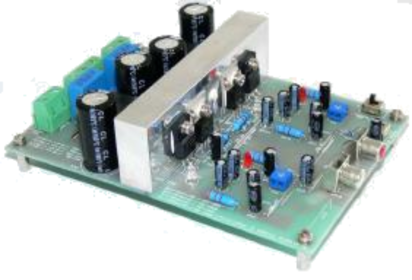

25W-500W scalable output power Class D audio power amplifier reference design
IRAUDAMP7S
25W-500W scalable output power Class D audio power amplifier reference design. Using IRS2092 protected digital audio driver
Advantage
  • 250 W x 2 channels, (THD=1%, 1kHz, 4 Ohms)
  • 0.01% THD+N Distortion @ 120W, 4 Ohms
  • Residual noise 200 µV, IHF-A weighted, AES-17 filter
  • Single layer PCB
  • OCP, OVP, UVP, DC protection and OTP
  • Half-bridge/full-bridge selector
  • Using IRS2092S gate driver IC and IRFI4019H-117P MOSFET
