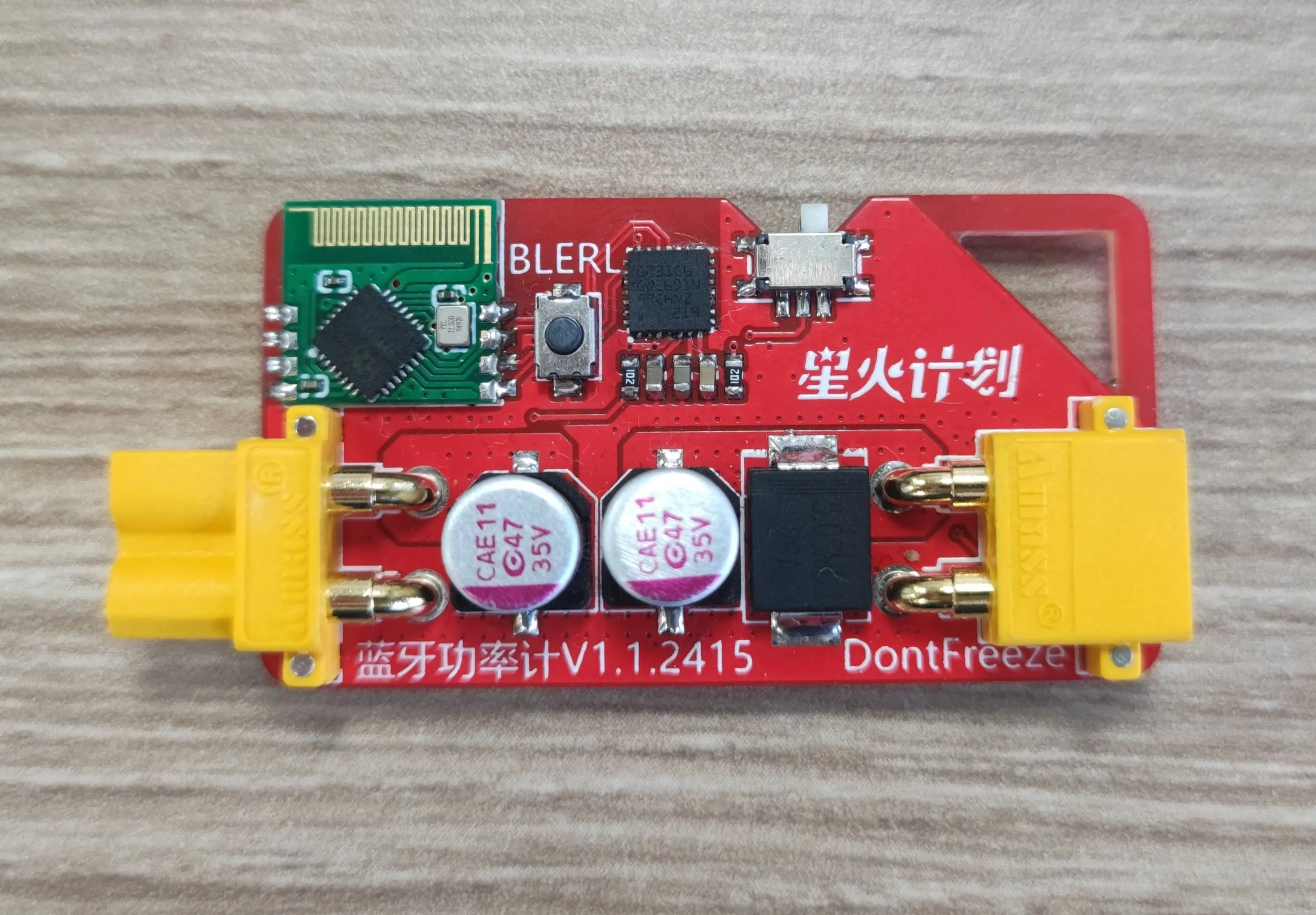

Project Description:
  When debugging equipment with sudden load changes, such as motors, it's necessary to monitor voltage, current, and power variations to prevent undervoltage protection due to power fluctuations or overcurrent protection due to excessive instantaneous current. This requires a power meter with a sufficiently high sampling frequency that can graphically display parameter changes. The final solution uses the CH9140 Bluetooth serial port pass-through module for data transmission. Firstly, it allows the use of various serial port assistants as a host computer, flexibly utilizing their plotting, saving, and even other scripting functions. Secondly, Bluetooth transmission completely isolates the high-power power supply from the computer, ensuring the computer won't explode due to load failure (the downside is that the Bluetooth signal seems weak; a different wireless module may be considered later).

: Voltage range: 5-30V (cannot be too low because the LDO output voltage will be inaccurate); Voltage
resolution: 0.1V
; Current range
: 0-20A; Current resolution: 0.1A; Sampling frequency:
4kHz (then averaged eight times);
Refresh rate: 500Hz.

Design principle:
    The current-sensing op-amp amplifies the differential signal of the voltage drop across the current-sensing resistor to a suitable voltage range that the microcontroller's ADC can read;
  the voltage is divided by a resistor and then followed by a unity-gain stable op-amp for impedance transformation.
  The above two signals are converted into digital signals by the ADC, and then linear fitting is performed to reconstruct the voltage and current signals.
  There is a low-pass filter with a cutoff frequency of approximately 1kHz at the input port of the microcontroller's ADC. Although the sampling rate is set to 4kHz, it is used for oversampling before software averaging and filtering, so the final data refresh rate (transmission rate) is still 500Hz. For
the ADC input RC filter resistor values, I referred to this table and approximately configured the ADC as shown in the red box, with an external resistor value of 10K.

  The version using the BLE_SER_A_ANT module can only transmit at a fixed baud rate of 115200; this is a hardware design issue with WCH. This resulted in 1.2ms taking up time to send just 14 characters, forcing me to adjust the update rate to 500Hz.
There was also packet loss during serial transmission for some unknown reason, causing the VOFA+ curve to fluctuate when receiving abnormal data.
This switch was originally intended for serial wireless downloading, but for some reason it's not working.
