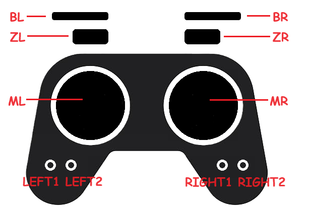

5. Controller Operation Instructions:
Press and hold ML to power on and enter download mode. Press and
hold MR to power on and enter calibration mode.
Calibration Mode: When the green light is on (10s), shake the joysticks vigorously. The controller will automatically record the ADC value at the extreme positions. Then, when the blue light is about to turn off and turns on again (10s), stop the controller. The controller will record the ADC value at the center position of the joystick.
Default Button Functions:
ML - Switch current button function layer;
MR - Enable gyroscope mapping.
Gyroscope Mode: By default, gyroscope data will be mapped to Z/RZ (mapping other data can be modified via via).
