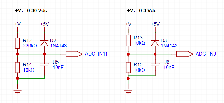

2. Voltage Sampling Circuit
The voltage divider resistors in this project are designed to be 220K+10K, therefore the voltage division ratio is 22:1 (ADC_IN11).
The voltage divider resistor selection
is designed to measure the maximum voltage value. For safety reasons, this project uses 30V (the actual maximum display can be 99.9V or 100V).
The ADC reference voltage is 1.5V in this project, and this reference voltage can be configured through the program.
To reduce the power consumption of the sampling circuit, the low-side resistor (R7) is usually chosen as 10K based on experience.
Then, the high-side resistance of the voltage divider resistor can be calculated using the above parameters.
The required voltage division ratio is calculated, i.e., the ADC reference voltage. The input voltage is designed; using known parameters, 1.5V/30V = 0.05 can be calculated.
The high-side resistance is calculated as the low-side resistance/voltage division ratio; using known parameters, 10K/0.05 = 200K can be calculated.
A standard resistor is selected: a resistor slightly higher than the calculated value of 200K is chosen. We usually choose E24 series resistors; therefore, in this project, 220K, which is greater than 200K and closest to the calculated value, is selected.
If, in actual use, the voltage to be measured is lower than 2/3 of the module's design voltage (66V), the voltage divider resistor can be replaced and the program modified to improve measurement accuracy. The following example illustrates this:
Assuming the measured voltage is no higher than 24V and other parameters remain unchanged,
calculations show 1.5V/24V = 0.0625, 10K/0.0625 = 160K. 160K is a standard E24 resistor and can be directly selected, or a higher value 180K can be chosen with some redundancy.
If, in actual use, the voltage to be measured is higher than the module's 99V design voltage, a different resistor can be selected. To achieve a wider voltage measurement range, one can choose to replace the voltage divider resistor or modify the reference voltage. The following example illustrates this:
Assuming the measured voltage is 160V, the solution is to increase the voltage reference to expand the range.
Given that the voltage division ratio of the selected resistor is 0.0145, we can calculate 160V * 0.0145 = 2.32V using the formula. Therefore, we can choose a 2.5V voltage reference to expand the range (increasing the range will reduce accuracy).
Considering the potential fluctuations in the measured power supply, a 10nF filter capacitor is connected in parallel with the low-side voltage divider resistor to improve measurement stability.

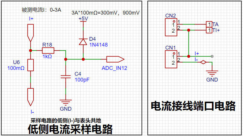

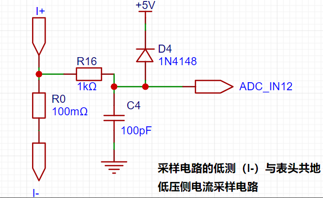

3. Current Sampling Circuit
This project uses a low-side current sampling circuit for current detection. The low side of the sampling circuit shares a common ground with the development board's meter interface. Do not solder R0 during learning.
Design Analysis
The sampling current designed in this project is 3A, and the selected sampling resistor (R0) is 100mΩ. The sampling selection mainly needs to consider the following aspects:
the maximum value of the pre-designed measurement current, which in this project is
the voltage difference brought by the 3A current sensing resistor. It is generally not recommended to exceed 0.5V.
The power consumption of the current sensing resistor should be selected according to this parameter. Considering the power consumption (temperature) problem under high current, this project selected a 1W packaged metal wire-wound resistor.
The amplification factor of the voltage across the current sensing resistor: This project does not use an operational amplifier to build an amplifier circuit, therefore the amplification factor is... 1.
The current sensing resistor value can then be calculated using the above parameters.
Since this project does not use an amplifier circuit, a larger sampling resistor is needed to obtain a higher measured voltage for measurement.
Considering that a larger resistor will result in a larger voltage drop and higher power consumption, an unlimited selection of a larger resistor is not possible.
This project uses a 1W package resistor, corresponding to a power rise of 1W.
Based on the above data, a 100mΩ current sensing resistor was chosen. According to the formula, 3A * 100mΩ = 300mV, 900mW.
To cope with different operating environments, especially high-current scenarios, the R0 resistor can be replaced with constantan wire or a shunt. The appropriate alternative can be chosen based on the actual application scenario. For safety and educational purposes, this project will not discuss measurements exceeding 3A, but the principle remains the same.

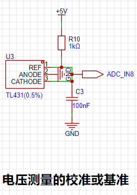

4. Current Sampling Circuit Design for Voltage Measurement and Calibration using a TL431 Circuit:
This project adds an extra TL431 circuit to provide a 2.5V reference voltage. This can be used to provide an external voltage reference for the chip to calibrate the AD converter. From a product design perspective, due to the inherent ADC performance advantages of the CW32, this circuit is not necessary. This circuit is designed on the development board to learn the relevant application principles.
The TL431 is a relatively "old" device, a classic, and widely used one, still found in many electronic products.
Many beginners may be encountering this device for the first time, so we will briefly explain its principles to facilitate better application of the TL431.
TI defines it as: TL431, a precision programmable reference. At room temperature, we can focus on several key characteristics on the first page of the references.
Precision: Precision indicates that its output voltage is very accurate. I used ±0.5% accuracy, and the actual measured voltage on the board was 2.495V. Compared to common Zener diodes, the accuracy is vastly different. In the application circuit diagram, the TL431 is represented by a Zener diode symbol.
Adjustable Output Voltage: The adjustable output voltage is between Vref and 36V. In our project, we use the output Vref voltage, which is approximately 2.5V. Therefore, we use 2.5V in the description, which is approximately equal to 2.5V.
Sinking Current Capability: This refers to how much current the output voltage pin can provide, which is closely related to the resistance value (R13) in the application circuit. It should not be less than 1mA. If there is no need for sinking current, do not design the current too high, as this will cause unnecessary power consumption.

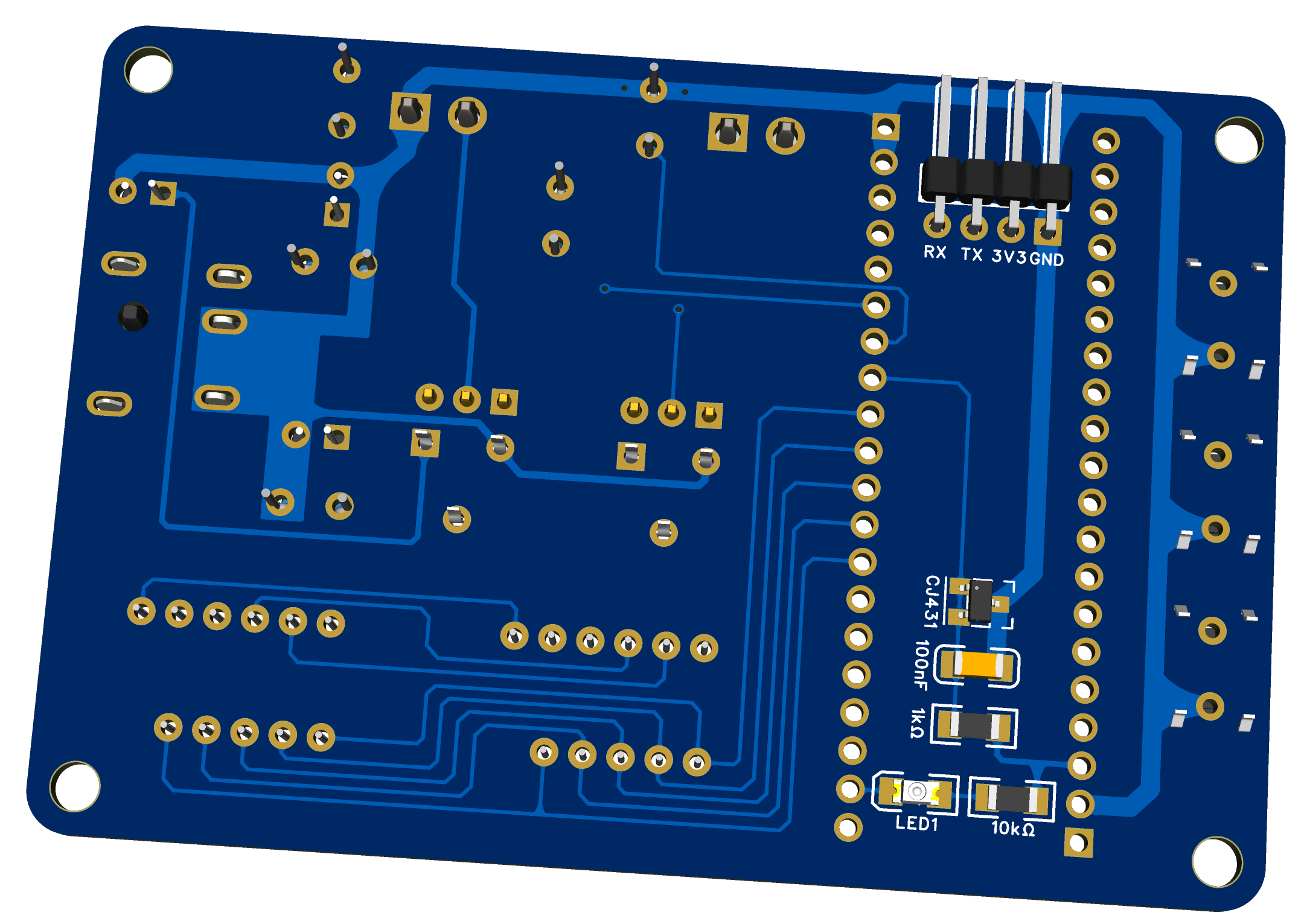

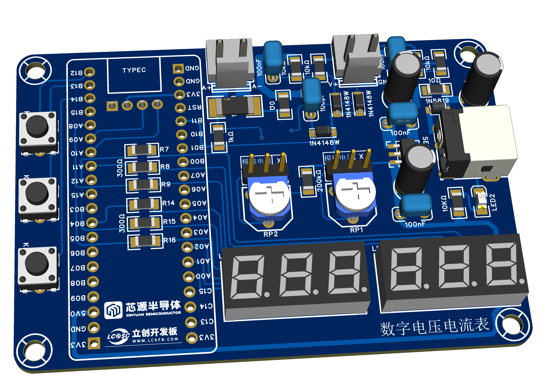

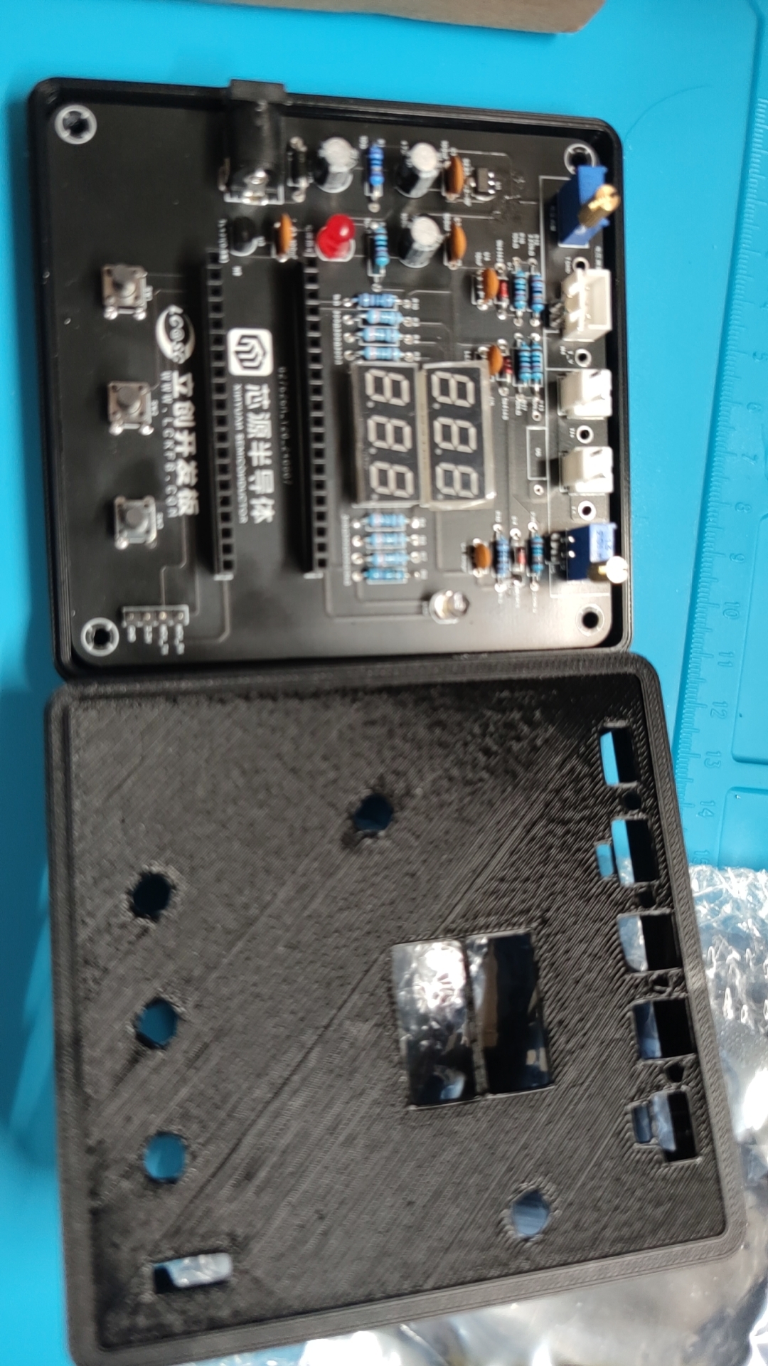

5. Housing Design:
The 3D housing was drawn and printed using JLCPCB EDA. The middle has holes for the digital tube and LED display, and the top has holes for calibration resistors and voltage and current measurement.

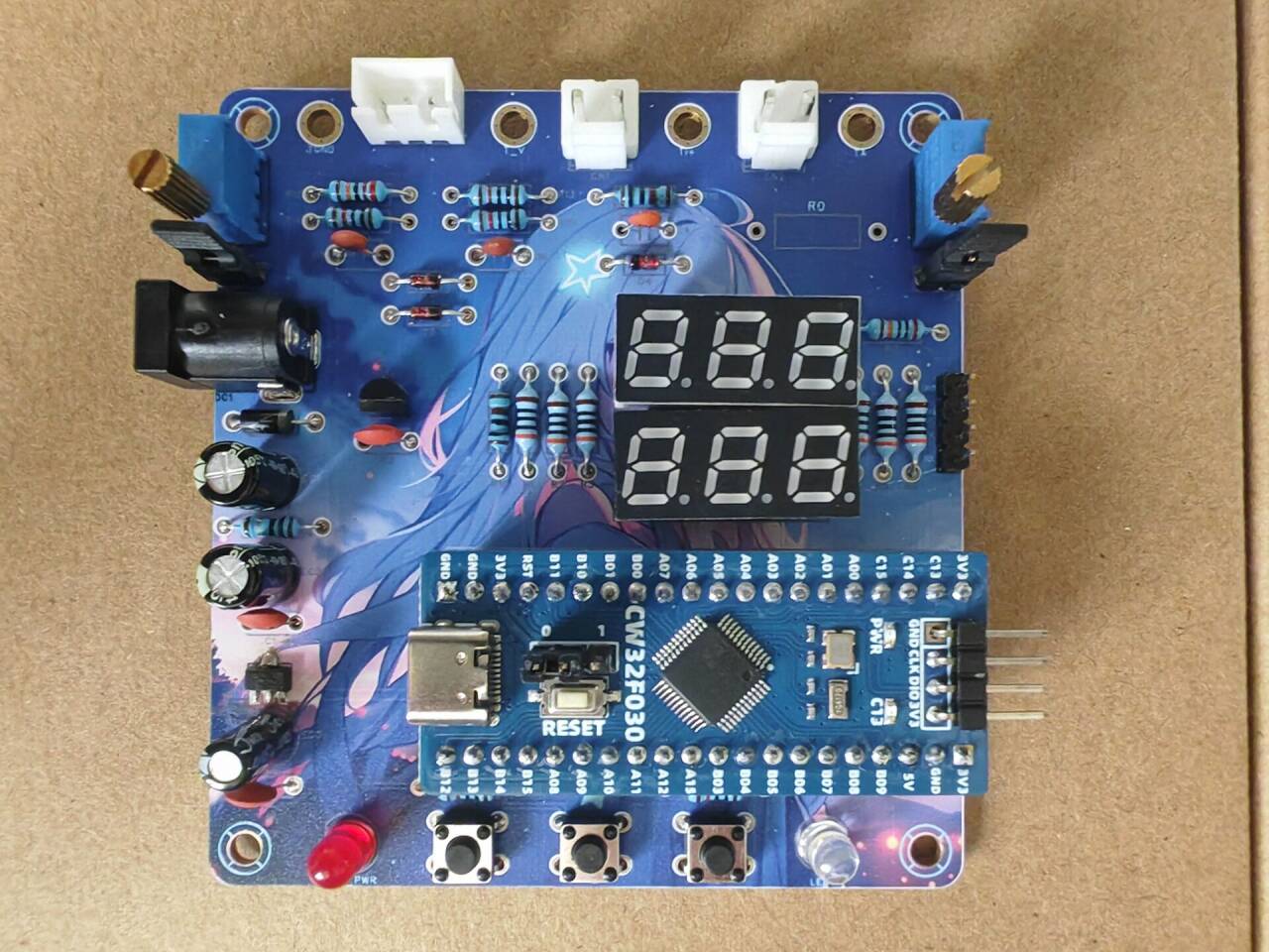

CW32 Voltage and Current Meter

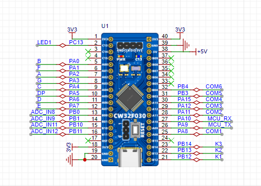

The main control uses the LCSC*Diwenxing CW32F103C8T6 development board, which includes a simple voltage and current meter.
The problem analysis
uses an ADC to read the voltage on the pins and displays it on a digital tube.
The schematic design explains that
the main control section
directly uses the LCSC development board, saving the design of crystal oscillator and filter circuits.
The CW32 development board has true 12-bit precision, and the CW32F103 chip's four unique reference voltages ensure the accuracy of the sampled data.

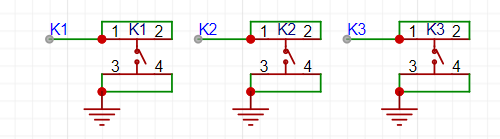

the independent button . By
default, the button is high, and when pressed, it is low.
This button circuit does not include pull-up/pull-down resistors, and the I/O port cannot be configured in floating mode; pull-up/pull-down resistors need to be designed in the software.
No debouncing capacitors are used; debouncing processing must be performed after button configuration. The low-voltage linear regulator (LDO) used

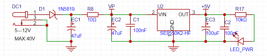

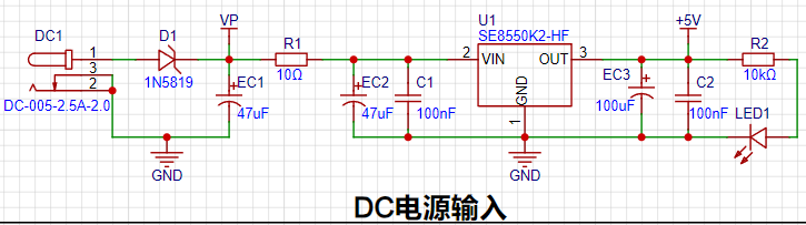

for the power input
is not the mainstream AMS1117, but rather the SE8550K2-HF.
The AMS1117-3.3V converts 5-7V to 3.3V, and the AMS1117-5V converts 12V to 5V; other models also have very low input power.
Considering that voltmeters are mostly used in industrial scenarios with 24V or 36V power supplies, the SE8550K2-HF, with an input power supply capacity of up to 40V, was chosen as the power supply.
For the package selection, the SOT-89 offers better heat dissipation.
A 1N5819 diode was used for reverse connection protection, saving costs compared to a fuse.
The series diode for reverse connection protection takes into account the fact that the power supply voltage of this device is usually higher than 5V; the 0.7V voltage drop of the diode will not affect the power supply. When the power supply voltage is low, due to the overall low power consumption of the project, the measured power supply current is low (20mA). Due to the unique structure of the Schottky diode D4 (1N5819), its VF is lower than that of general-purpose switching diodes, as shown in the figure below, with a voltage drop of approximately less than 0.2V.
A small series resistor R8 (10Ω) is used for voltage division, which reduces the problem of severe heat generation caused by the large voltage difference of the LDO under high voltage conditions. On the other hand, the principle of low overcurrent of a series-connected 10-ohm low-power resistor is utilized to act as a low-resistance fuse, providing overcurrent or short-circuit protection.
Filtering capacitors: large capacitors filter low frequencies (overall disturbances), and small capacitors filter high frequencies (glitch).
Both the PCB and schematic must ensure that the electrolytic capacitor (large capacitor) comes first, followed by the ceramic capacitor (small capacitor). The
waveform must pass through the large capacitor first to flatten the overall waveform, and then through the small capacitor to eliminate glitches. Reversing the order will result in an unsatisfactory filtering effect.
A power indicator light (constantly lit) is added at the end of the circuit to observe the circuit's operating status. A 0.28-inch three-digit common-cathode

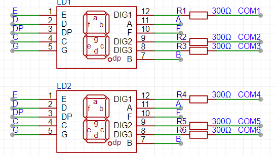

digital
tube is used as the display element, as it has higher environmental adaptability and is less prone to damage.
A conventional transistor not used for time display is used, with 7 segments and 3 digits.
The current-limiting resistors (R1-R6) of the digital tube are configured with 300Ω, providing good visibility for both red and blue digital tubes, with a soft and non-glaring brightness.
Because the project uses relatively few components and only requires two digital tubes, the chip's I/O resources are sufficient, so shift registers are not used. Dual-channel voltage

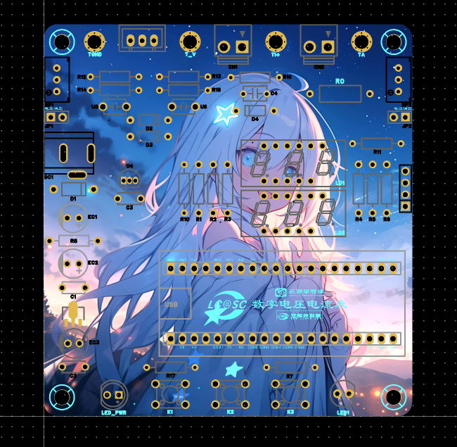

PCB design guidelines state that
power traces should be as wide as possible, approximately 20-60 mil.
Ordinary signal traces: around 10 mil;
ADC signal traces: 10 mil or 8 mil. Excessive width may affect signal integrity when the traces are too long.
In PCB design, elongated oval pads are often used for through-hole pads to increase the contact area between the solder, soldering iron, and the pad, making soldering easier.
Additionally, silkscreen layers are used to separate closely spaced pads. On actual circuit boards, the raised silkscreen layer significantly reduces solder bridging during soldering. This method is widely used in product design to improve production yield.
Small font sizes and thick line widths in silkscreen printing can lead to blurring and unclear labeling. It is recommended to choose appropriate silkscreen font size and line width, as different silkscreen fonts produce different effects. Choosing a suitable font will result in better printing performance at the same line width and font size.

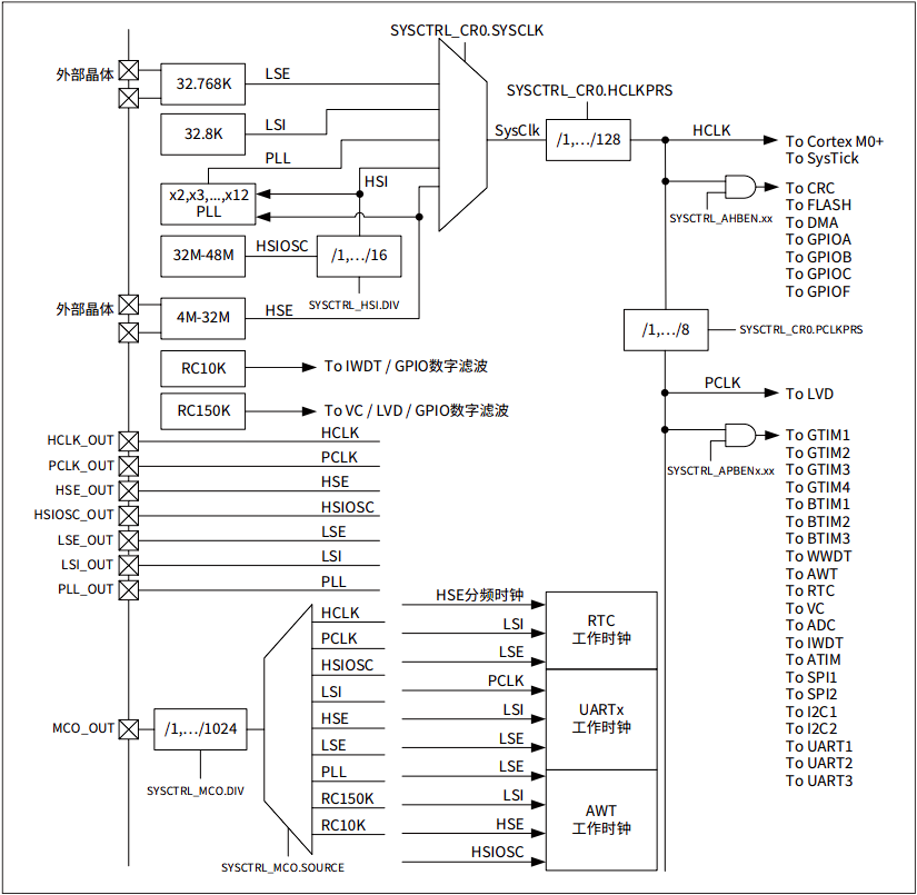

Software Description:

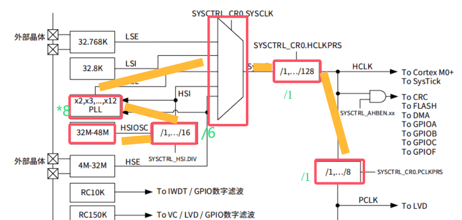

Configuring Internal Clock Parameters
. The default operating frequency of the CW32's internal clock is not the frequency we want. Before using CW32, we need to configure the internal clock tree.
The CW32F030 user manual provides the system
's internal clock tree, as shown in the diagram below. The CW32 has five clock sources:
HSI (high-speed internal clock)
, HSE (high-speed external clock)
, LSI (low-speed internal clock),
and LSE (low-speed external clock).
The PLL (phase-locked loop – frequency multiplier)
uses an internal high-speed crystal oscillator HSIOSC to calibrate and output 48MHz. The frequency division factor is set to 6, the PLL frequency multiplier factor is set to 8
, and the HCLK and PCLK frequency division factors are set to 1, resulting in a 64MHz frequency. The digital

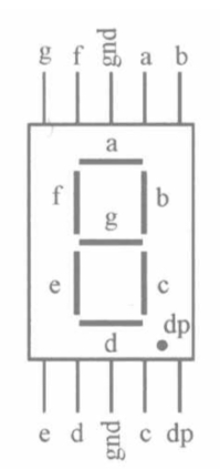

tube display uses
A-DP control segment codes to display the digits and decimal point
. The DIG1/COM control bit codes are used. A common-cathode three-digit digital tube is selected; a low-level control of three different bits
(A~G) each has its own display number (from low to high):
DP GFEDCBA.
Example: Displaying the number 5, according to the digital tube segment code diagram above,
0 1 1 0 1 1 0 1 ---》 0x6d The DP digit can be added or removed.
A switch statement scans sequentially, controlling the display of a specific digit
on the digital tube
. Dynamic scanning of the digital tube involves sending segment codes and digit codes to each digit in turn. Utilizing afterglow and the persistence of vision, the human eye perceives that each digit is displaying

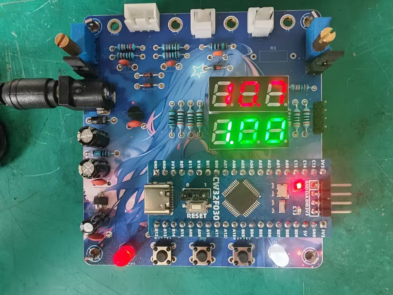

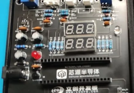

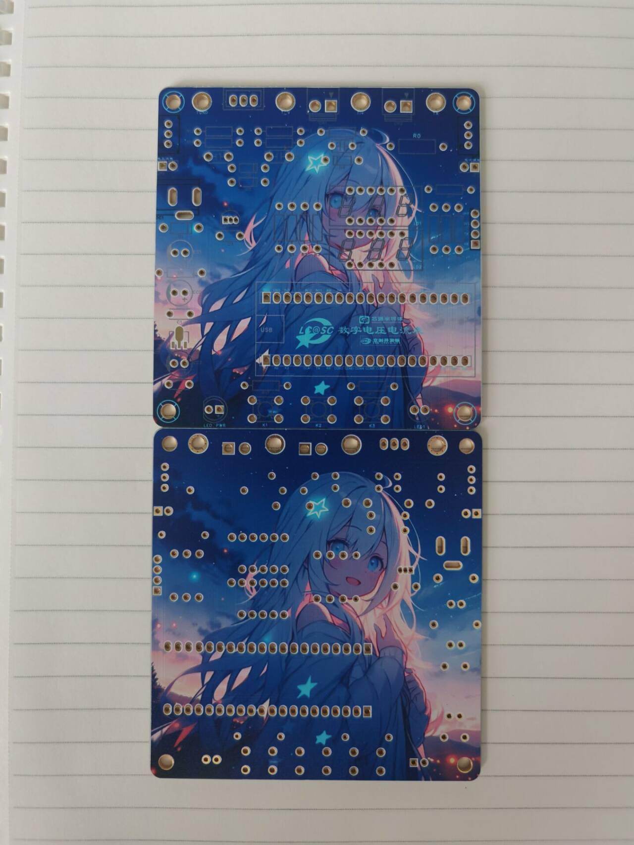

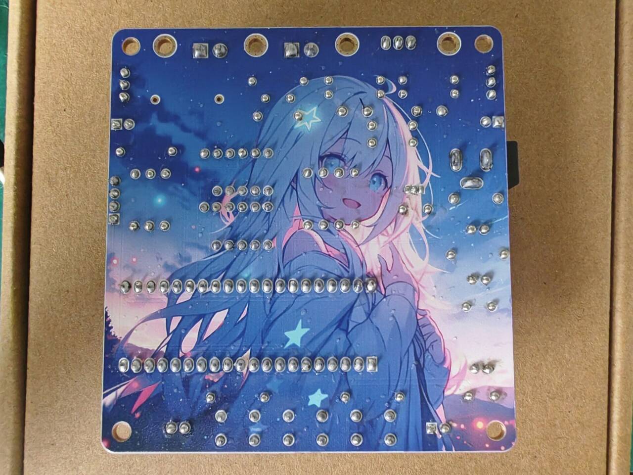

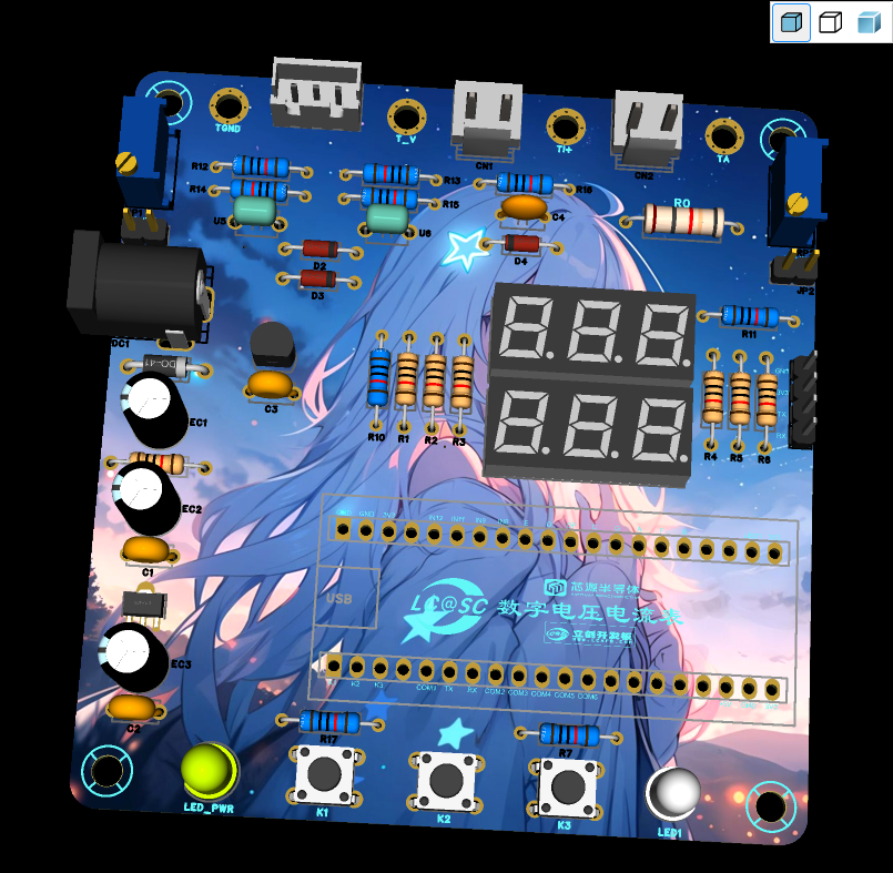

Physical demonstration
: JLCPCB 2D display image,
JLCPCB 3D display image,
PCB prototyping image,
soldering completion,
functional testing

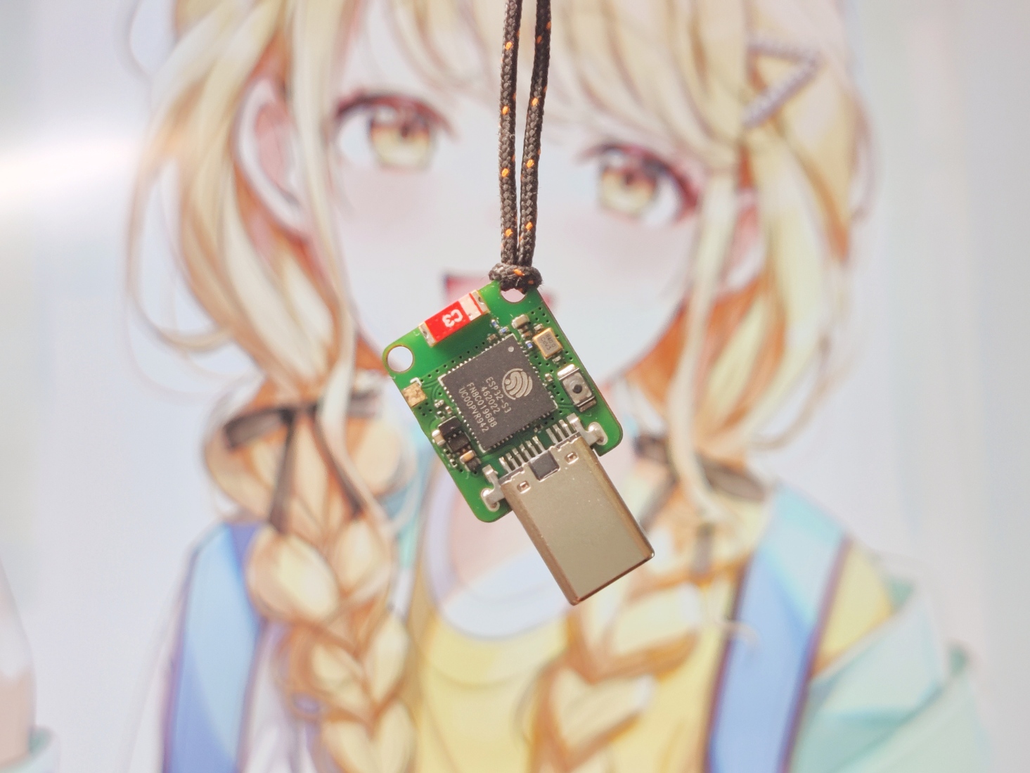

The ESP32-S3-Dongle is a multi-functional USB device that can be used as a USB network adapter, Bluetooth keyboard receiver, WOL remote wake-up device, etc. Based on the ESP32-S3FN8, it is suitable for various application scenarios.
The PCB of this project adopts a single-sided surface mount design, facilitating soldering with a hot plate. The power supply section uses a TLV62568 DC-DC converter, supporting 1A current, costing 0.3 yuan per unit.
In addition, the PCB has an onboard SK6805-EC15 RGB LED connected to the GPIO9 pin, providing flexible display functionality for device status indication.

CW32 Geostar Digital Voltage and Current Meter
LCSC-Diwenxing CW32 Digital Voltmeter and Ammeter Training Camp Project. This project aims to introduce students to basic circuit design, PCB prototyping, and CW32 Diwenxing development board programming and flashing through the design and fabrication of this digital voltmeter and ammeter, paving the way for further learning.
Function Introduction: Voltage measurement is designed for DC 0~30V, and current measurement is designed for DC 0~3A.
Schematic Explanation: Slightly modified from the reference schematic, the current measurement replaces the extra multimeter connector with an external series connection, reducing PCB space usage and simplifying wiring.
Key Program Explanation: I couldn't learn CW32 programming quickly, so the .hex files were downloaded directly from the official website and programmed via TTL serial port for convenience. Important
Material Purchase Notes: Most of the packages were designed by myself (I'm addicted to it), and I didn't use the BOM upload method for procurement. The disadvantage is that it's easy to miss things; for example, in this project, I forgot to count the number of digital tubes the first time and only bought one, and when I went to buy it again, I found that the same model was out of stock.
Assembly Instructions: T12 soldering iron, generic 6337 solder wire, and a temperature of 360 degrees Celsius was required to achieve satisfactory results. It is recommended to find all the necessary components first, and then solder them one by one from small to large, from surface mount to through-hole. Soldering is very relaxing once you get used to it, and there is a small sense of accomplishment in seeing the finished product.

Power supply circuit:
A relatively stable 5V voltage is provided to the circuit through an SE8552K2-HF, and a series diode is used for reverse connection protection.

1. Power Supply Circuit
LDO (Low Dropout Linear Regulator) Selection This project uses an LDO as the power supply. Considering that most voltmeter products are used in industrial scenarios with 24V or 36V power supplies, the SE8550K2 with a maximum input voltage of up to 40V was selected as the power supply. The main reason for not using a DC-DC step-down circuit to handle the large voltage drop is to avoid introducing DC-DC ripple interference during the design process, and the secondary reason is to reduce project costs.

3. Voltage Sampling Circuit:
is designed to measure the maximum voltage. For safety reasons, this project uses 30V (the actual maximum display value can be 99.9V or 100V).
If, in actual use, the voltage to be measured is higher than the module's 99V design voltage, a different resistor can be selected. To expand the voltage measurement range, you can choose to replace the voltage divider resistor or modify the reference voltage. The following example illustrates this:
Assuming the measured voltage is 160V, we can choose to increase the voltage reference to expand the range.
Considering the potential fluctuations in the measured power supply, a 10nF filter capacitor is connected in parallel with the low-side voltage divider resistor in the circuit design to improve measurement stability.
(Range switching )
This project uses a low-side current sampling circuit for current detection. When learning the common ground between the low-side of the sampling circuit and the development board's meter interface, please do not solder R0!!!
The design analysis
for this project involves a sampling current of 3A, and the selected sampling resistor (R0) is 100mΩ. The selection of the sampling resistor mainly needs to consider the following aspects:
the maximum value of the pre-designed measurement current;
the voltage difference caused by the 3A current sensing resistor in this project; and
the power dissipation of the current sensing resistor, which should generally not exceed 0.5V. A suitable package should be selected based on this parameter. Considering the power dissipation (temperature) issue under high current, a 1W metal wire-wound resistor package was chosen
. The voltage amplification factor across the current sensing resistor is also important. Since no operational amplifier is used to build the amplification circuit in this project, the factor is 1.
. Since no amplifier circuit is used, a larger sampling resistor is needed to obtain a higher measured voltage for measurement.
Considering that a larger resistor would result in a larger voltage drop and higher power consumption, an unlimited selection of a larger resistor is not feasible.
This project uses a 1W package resistor, corresponding to a power consumption of 1W.
Based on the above data, a 100mΩ current sensing resistor was selected. According to the formula, 3A * 100mΩ = 300mV, 900mW can be calculated.
To cope with different operating environments, especially high-current scenarios, the R0 resistor can be replaced with constantan wire or a shunt. The replacement can be selected according to the actual application scenario. For safety and educational purposes, this project will not discuss measurements exceeding 3A in detail, but the principle is the same.
5. Digital Tube Display
This project uses a digital tube as the display unit.
This project uses two 0.28-inch three-digit common-cathode LED displays as display devices. Compared to displays, LED displays offer better visibility in complex environments. The brightness of the LED displays can be increased by using smaller current-limiting resistors to meet the needs of the actual usage environment. Furthermore, LED displays have better mechanical properties and are not as easily damaged by external forces as displays. They are widely used in industrial applications requiring stability and reliability. From a development board learning perspective, this facilitates targeted learning of electronic measurement principles.
In this project, actual testing showed that a 300Ω current-limiting resistor for the LED displays resulted in good visibility for both red and blue LED displays, with a soft and non-glaring brightness.
6. TL431 Circuit Design for Voltage Measurement Calibration:
This project adds an additional TL431 circuit to provide a 2.5V reference voltage. This can be used to provide an external voltage reference for calibrating the AD converter. From a product design perspective, due to the inherent ADC performance advantages of the CW32, this circuit is not necessary. This circuit was designed on the development board to learn relevant application principles.
The TL431 is a relatively "old" device, a classic with wide applications, and still found in many electronic products.
Many beginners may be encountering this device for the first time, so we'll briefly explain its principles to help you better utilize the TL431.
TI defines it as a "Precision Programmable Reference," and we can focus on several key characteristics on the first page of the references.
Precision: Precision indicates its highly accurate output voltage. The TL431 I used has ±0.5% accuracy, and at room temperature, it measured 2.495V on the board. Compared to common Zener diodes, the accuracy is vastly different. In application circuit diagrams, the TL431 is internally represented by a Zener diode symbol.
Adjustable Output Voltage: The adjustable output voltage is between Vref and 36V. In our project, we use the output Vref voltage, which is approximately 2.5V. Therefore, we use 2.5V in the description, which is approximately equal to Vref.
Sinking Current Capability: This refers to how much current the output voltage pin can provide, which is greatly affected by the resistance value (R13) in the application circuit. The current should not be lower than 1mA. If there is no need for sinking current, do not design the current to be too high, as this will cause unnecessary power consumption.
