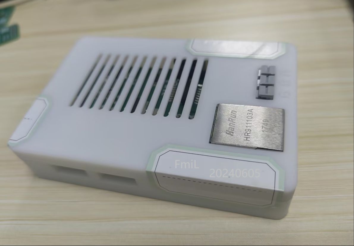

Isolated USB hub/to-485/to-Ethernet port
The WCH domestic conversion chips used in this product
include: a USB hub chip (CH334, a USB to 4-port hub chip, see https://www.wch.cn/products/CH334.html);
a USB to serial port chip (CH9101, a VCP/CDC serial port chip, see https://www.wch.cn/products/CH9101.html);
a USB to Ethernet chip (CH397, a 100M network card chip, see https://www.wch.cn/products/CH397.html);
and a USB current limiting power distribution switch chip (CH217, which can be used in conjunction with CH334 for control). See https://www.wch.cn/products/CH217.html for details.
The isolated RS485
uses the Nsi8241 isolation chip to isolate the TTL serial port from the RS485, achieving 3k~8kVrms level isolation withstand voltage.
https://www.novosns.com/general-digital-isolator-1370
has been simply verified.
Connecting to a USB hub, emulator, network cable, and RS485,
actual tests show:
1. Serial port transmission and reception are normal;
2. Emulator debugging at 10MHz is normal;
3. Network port connection is normal and can connect to the host computer.
The 3D shell design uses a professional EDA version
to design the three-view diagram, which is simple and convenient. Combined with real-time preview of the PCB 3D model, it even eliminates the need to measure the actual dimensions. The actual prototyping effect is also very accurate. (The discrepancy between the image and the actual product on the cover is due to the initial design not considering the shell thickness. Components did not extend beyond the board edge, resulting in the interface being separated by the shell by 3mm. On some devices, the USB port was too shallow and not securely connected. The PCB and shell design has been modified to make the overall design more reasonable.)
A minor issue: when the shell is configured as a top and bottom shell, the inner wall cannot be cut with a separate slot. The USB port is designed to fit into the slot on the inner wall, requiring manual cutting to remove the connecting portion.
