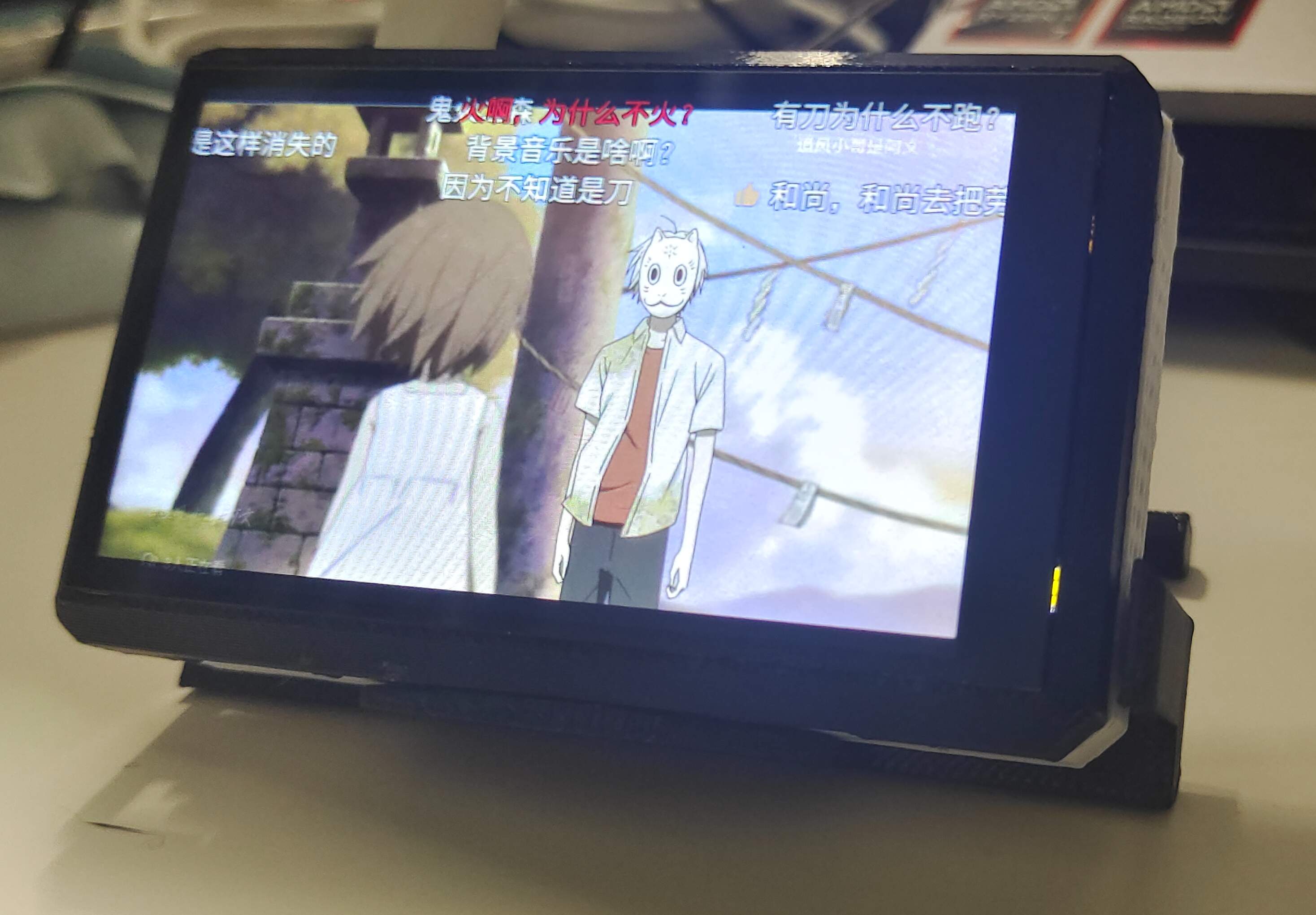

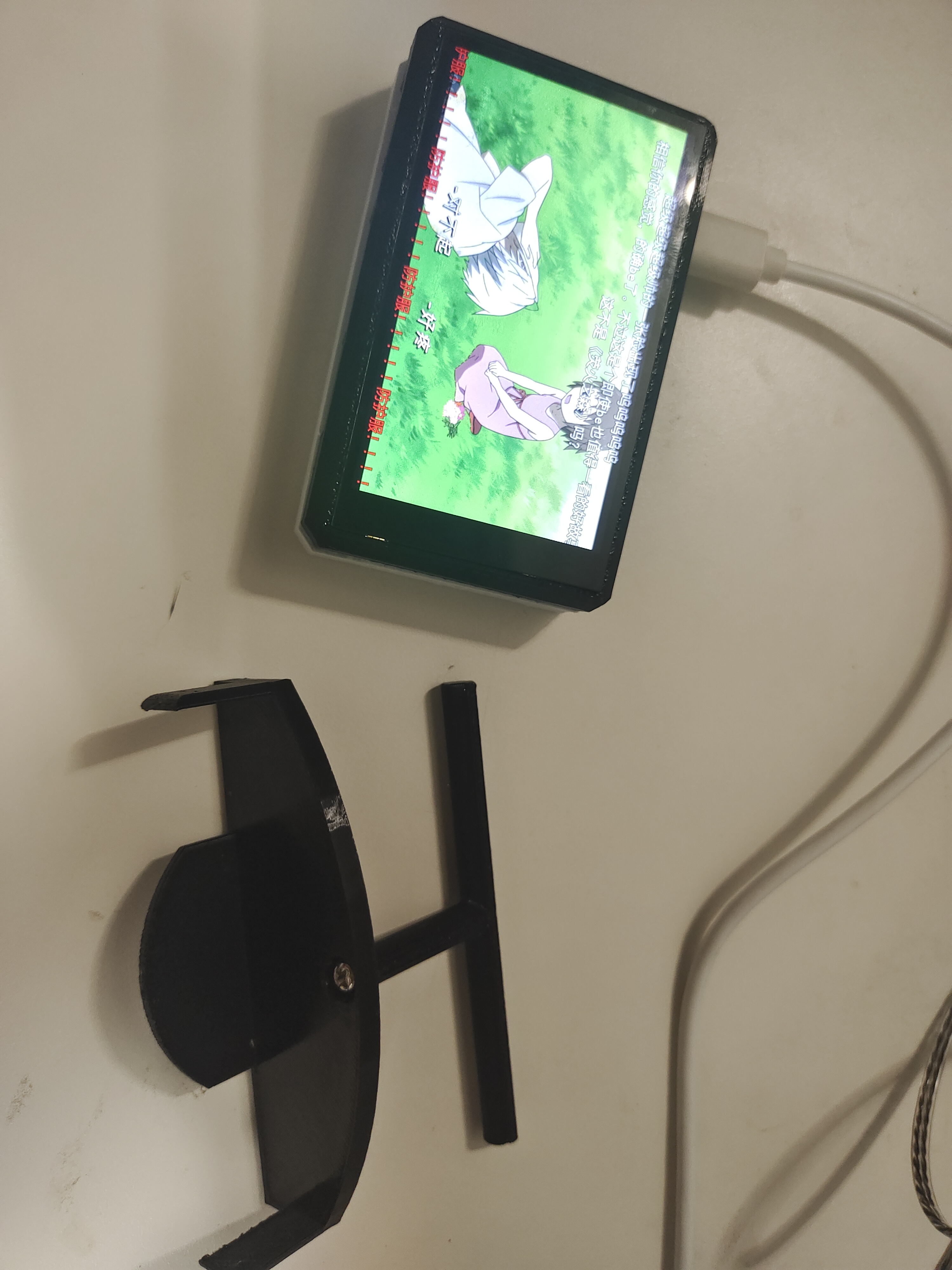

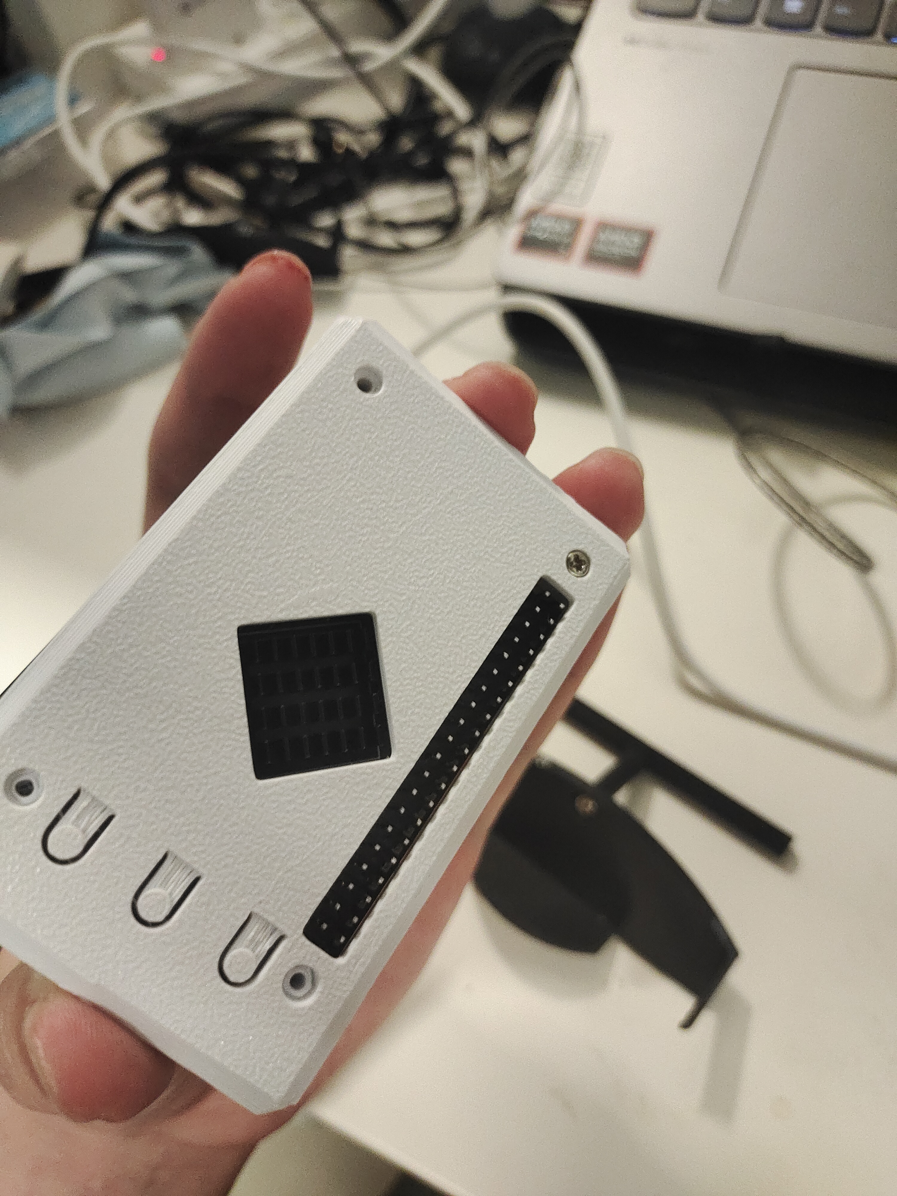

(1) This project is based on the LCSC development board to carry out the Taishanpai training camp for learning and creation. The LCSC development board bilibili explanation and its detailed documentation can provide great help to the majority of enthusiasts.
(2) Through this project, you can learn about SDK compilation, common Linux commands, Linux device tree, driver writing and hardware design using LCSC EDA.
Taishanpai training camp bilibili video tutorial: [Linux environment setup for beginners] LCSC Taishanpai RK3566 Linux development board training camp first lesson_bilibili_bilibili
II. Material Preparation
(1) Taishanpai development board x1 (I suggest that beginners should buy 2+16GB)
(2) Taishanpai expansion board (you need to make it yourself. In addition to the materials in the BOM, you also need to buy 31pin and 6pin FPC soft flat cables for connecting the Taishanpai development board and the expansion board)
(3) 3.1-inch screen
III. Production process
(1) Complete the environment setup according to the tutorial
(2) Learn SDK compilation
(3) Understand the Linux device tree
(4) Change the screen driver
(5) Use LCSC EDA to make the Taishanpai expansion board
(6) Soldering and assembling the Taishanpai expansion board
Taishanpai learning document: [LCSC Taishanpai RK3566] Development Board - Feishu Cloud Document (feishu.cn)
