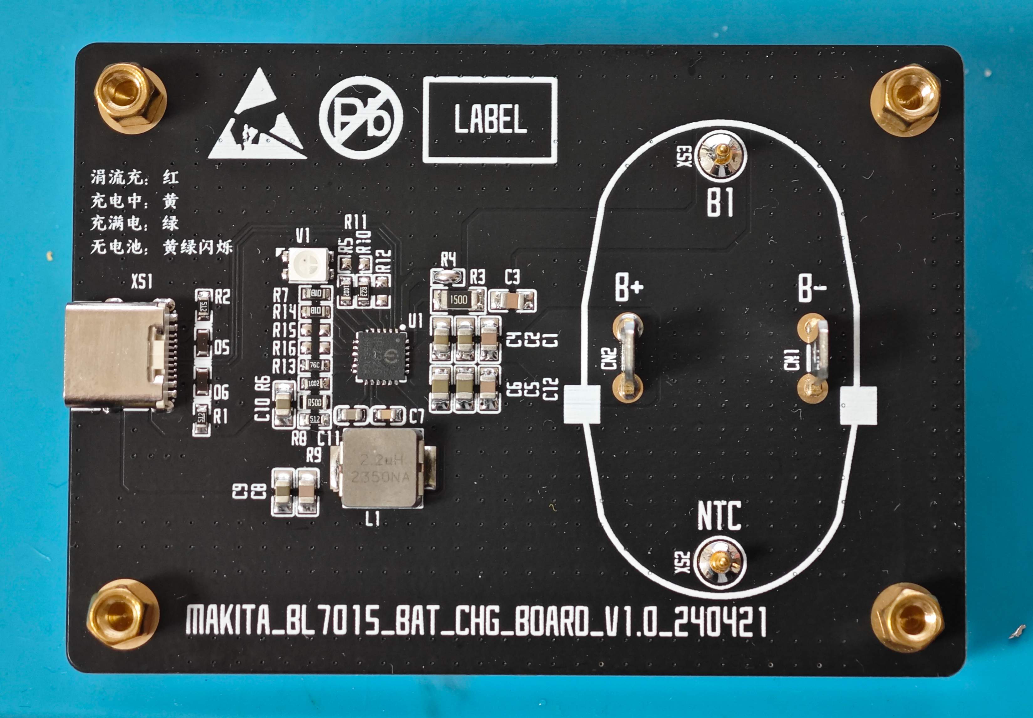

Makita DF012/DF022 battery charging board
Known Defects: The TX5818 version fails to switch the indicator light correctly during 9V linear charging, while 5V charging works normally.
I. Design Considerations
: 1. IP2326 Version:
① Original batteries or homemade batteries using the kit's NTC resistor will cause charging abnormalities; in this case, the NTC function needs to be disabled.
② For ease of soldering and precise positioning, the opening dimensions of the inserts and pins are designed to match the components; a slightly tight fit during installation is normal.
③ Other design considerations refer to another project, "Panasonic EZ7420/EZ7520 Battery Charging Board - Ingenic IP2326 Version".
2. TX5818 Version:
① The chip manual does not mention NTC-related parameters, therefore NTC-related components are temporarily NC (Not Required).
② Protection ICs and NMOS can be flexibly replaced according to your needs.
③ If 9V charging is not needed, the decoy chip circuit can be deleted; if equalization is not needed, the related circuit can be left unsoldered.
④ The TX5818 charges slightly more fully than the IP2326.
II. Other
1. The chip's built-in balancing function or balancing circuit has limited balancing capabilities. It can only eliminate small voltage differences during use. Large voltage differences will cause balancing to take too long. Therefore, when making your own battery, you must first perform balancing. Don't expect to use this charging board for balancing. If you find a large voltage difference after the battery pack has been charged and discharged for a period of time, you should replace the battery cells in time.
2. The 9V mode of the TX5818 is induced by PD. It cannot be induced by a QC protocol charging head.
3. The simple casing has copper pillars with a height of 5mm on the top and bottom. In the TX5818 version, because the height of the sliding switch exceeds 5mm, the height of the copper pillars needs to be increased appropriately.
4. The device does not have an over-discharge protection circuit, and there is no protection board inside the battery. If you feel that the speed is reduced or the power is insufficient during use, you should charge it in time to avoid over-discharge of the battery.
5. Ensure that someone is present when charging.
