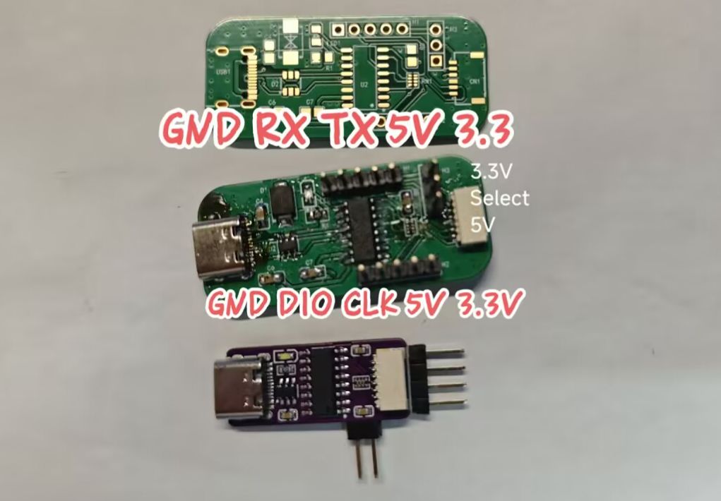

DAP-Link Based on CH552G (Modified from LCSC)
: This project modifies and
creates a
custom DAP-Link downloader (LCSC modified version) based on the JLCSC DAP-Link. [Video link:
https://www.bilibili.com/video/BV1ix4y187Ar](https://www.bilibili.com/video/BV1ix4y187Ar
Image of the actual product] (https://www.bilibili.com/video/BV1ix4y187Ar) [
Instructions for use:
Modified from the JLCSC DAP-Link, adding a 3.3V output. 3.3V and 5V outputs can be freely selected. This DAP-Link has a pin header interface and an SH1.0 1x6pin reverse ribbon cable interface. The SH1.0 1x6pin reverse ribbon cable interface allows selection of the output voltage as 3.3V or 5V.
] ( https://www.bilibili.com/video/BV1ix4y187Ar
) For firmware download instructions, please refer to LCSC: LSPIClink: LCSC Liangshanpai Development Board with DAPlink using CH552G as the programmer controller. LCSC Development Board Official Website: lckfb.com (gitee.com)
