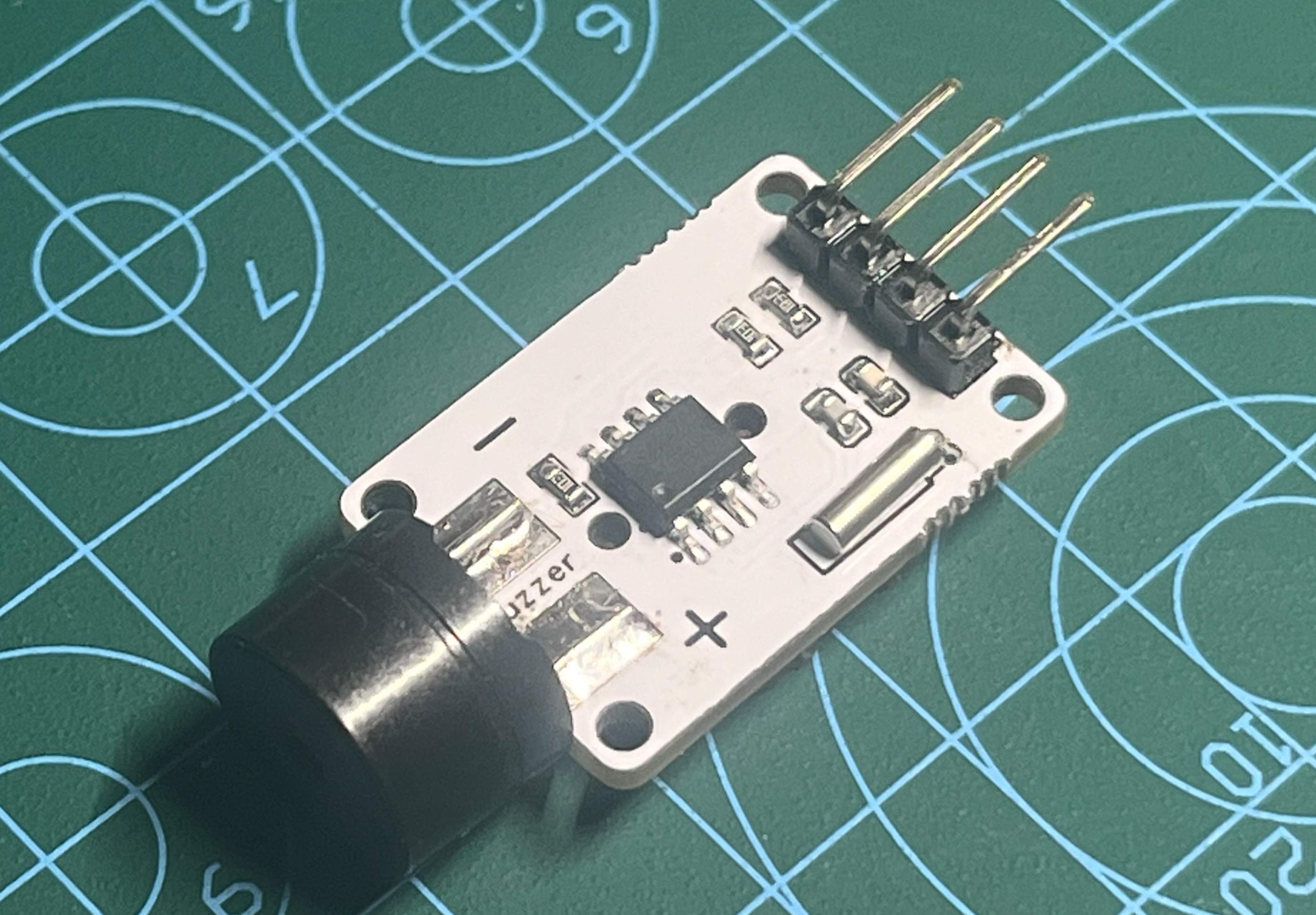

DS1307 clock module with buzzer
Compared to TB products, a typical DS1307 module brings out and pulls up the SQW pin; it also provides two larger pads, which can be used to solder a passive buzzer to the large pads, thereby utilizing the square wave output capability of the DS1307's SQW pin to make the buzzer sound.
