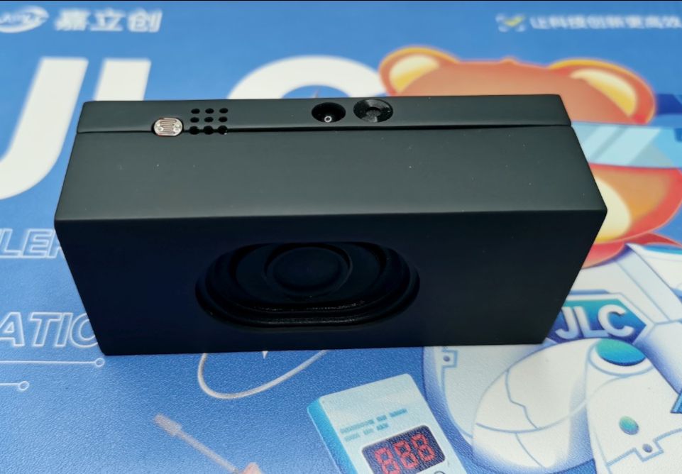

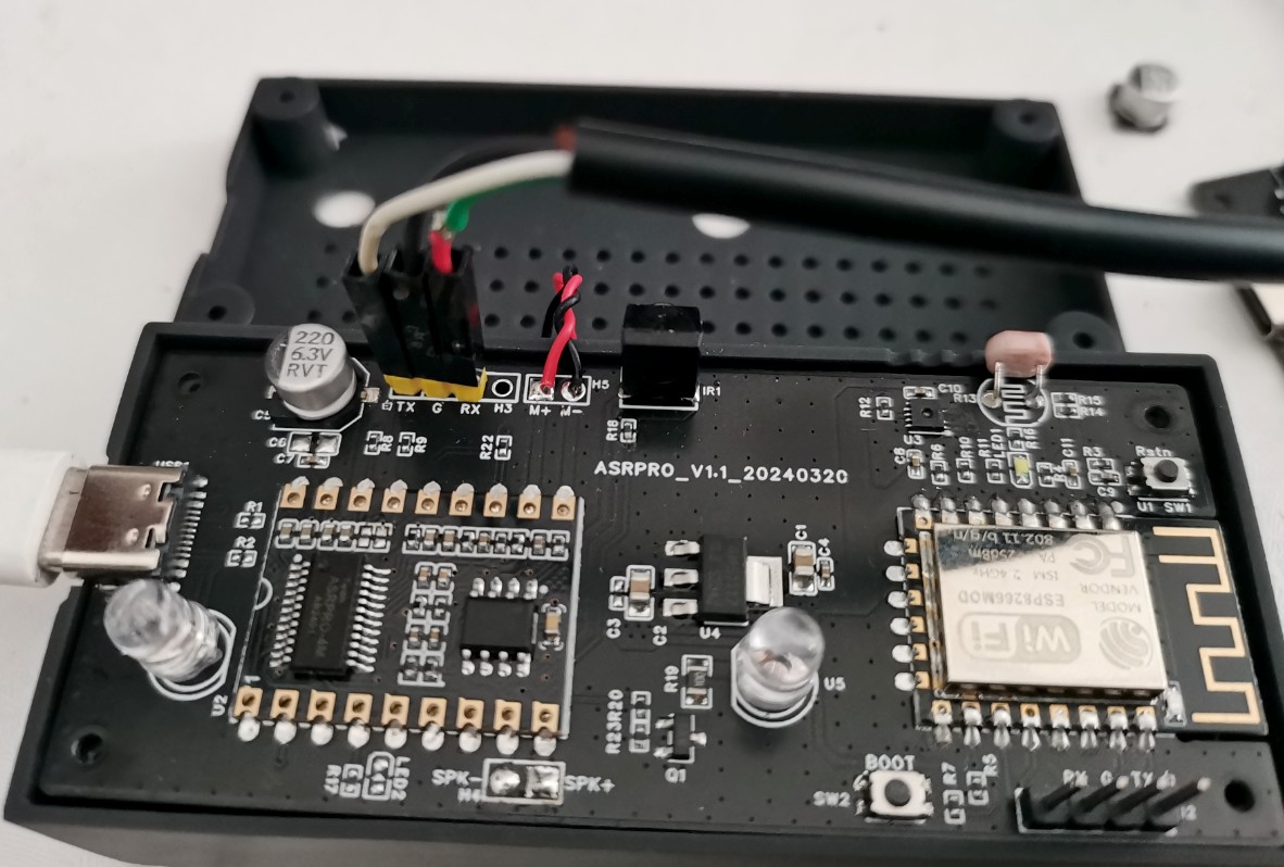

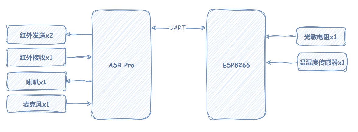

The Tianwen ASRPRO offline voice module is connected to Phone Assistant using ESP8266.
1. Simple block diagram
. 2. Its name
happens to be all black, so I call it "Little Black."

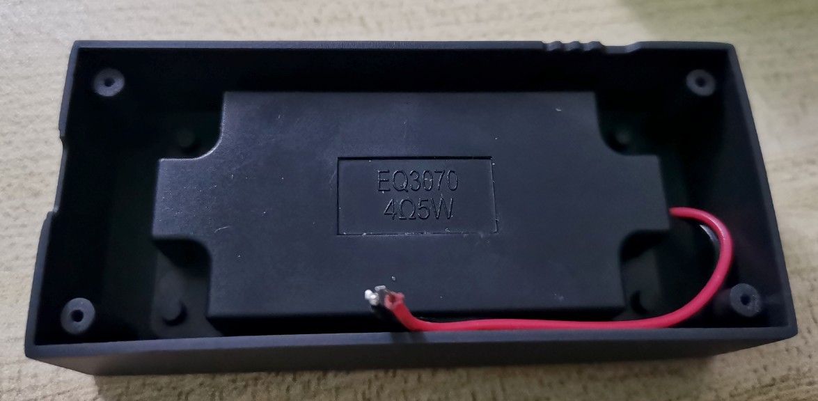

3. The wiring for assembling the speaker inside is soldered like this. Opening the cover too much risks breaking it.

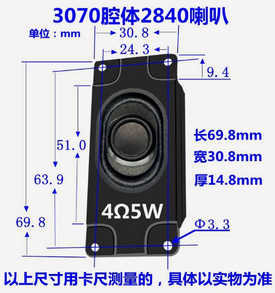

The speaker is directly snapped in. I bought two types of speakers; one was the wrong size .
The speaker positioning and hole size were designed according to this size.
