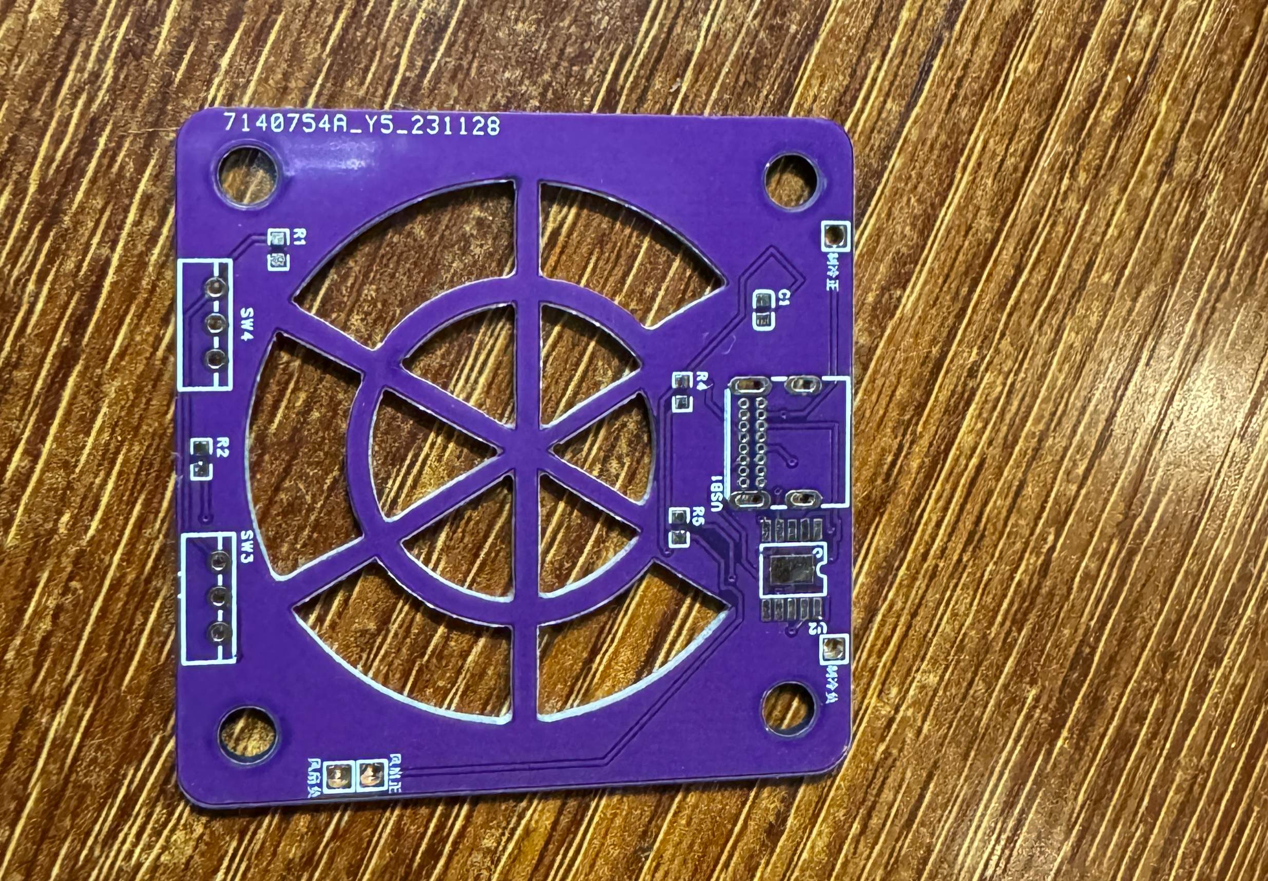

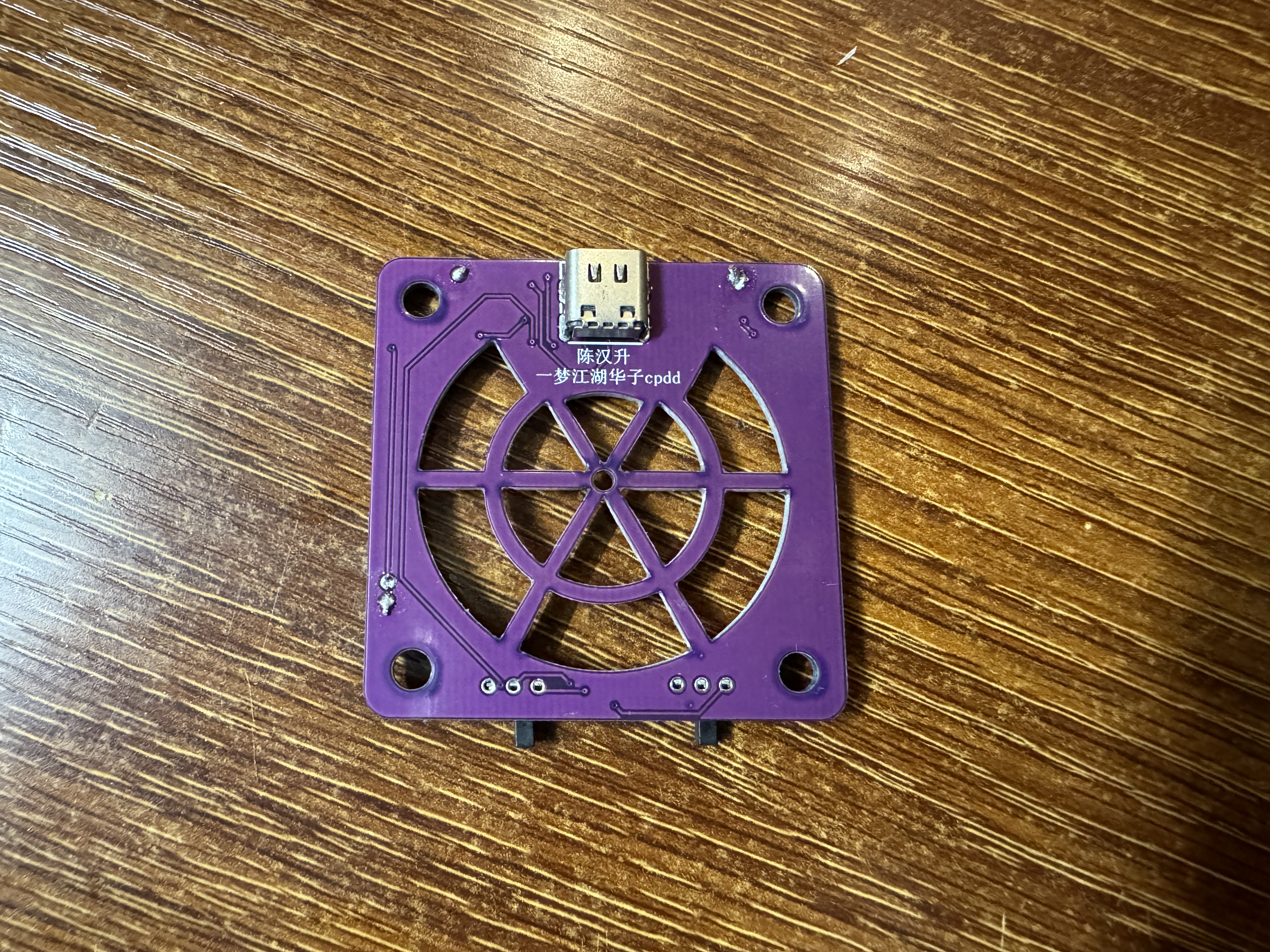

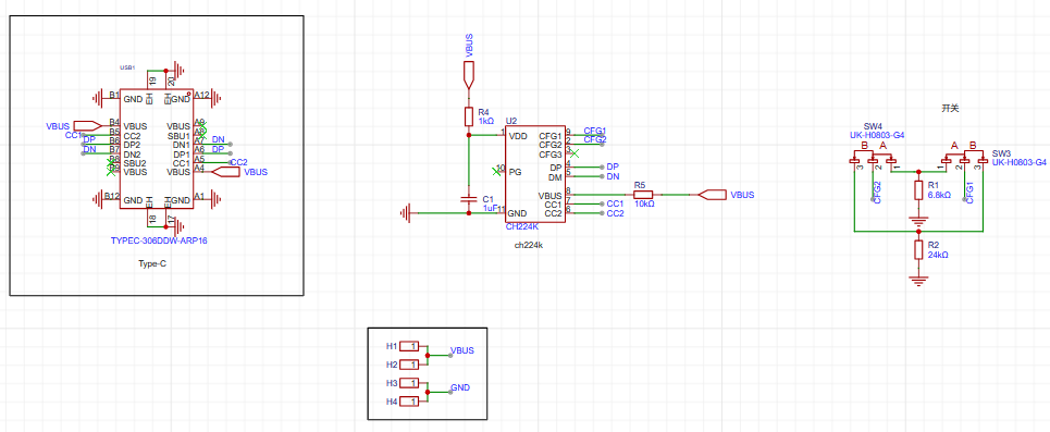

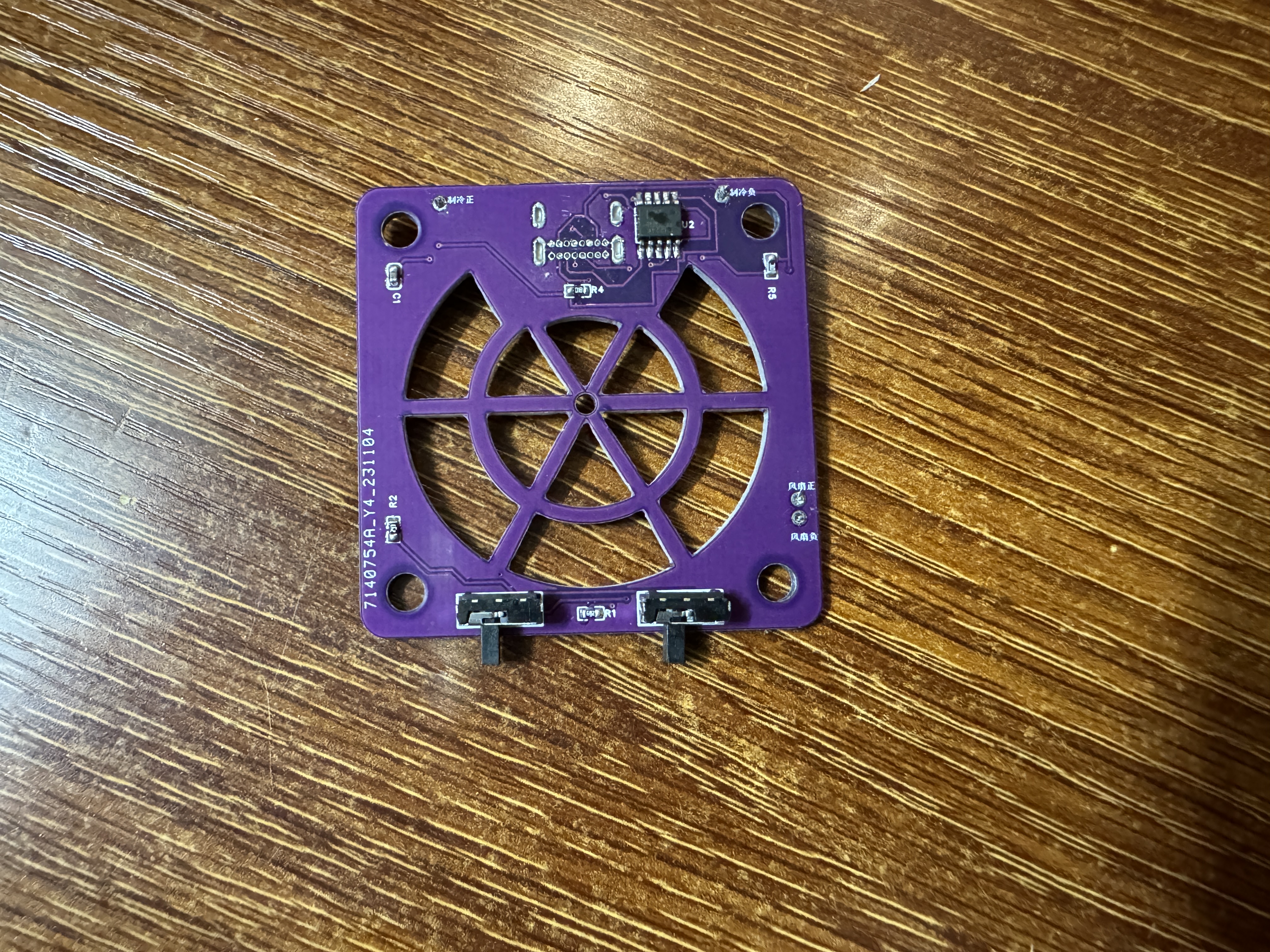

The schematic design and
PCB design are
fan-shaped for easy heat dissipation. The physical prototype is
shown in the
attached image .
While the finished product does achieve 9V and 12V adjustment for the fan, the power of the cooling element is not as high as expected for adjustable 9V and 12V. I would greatly appreciate any guidance from experts on where the problem might be.
