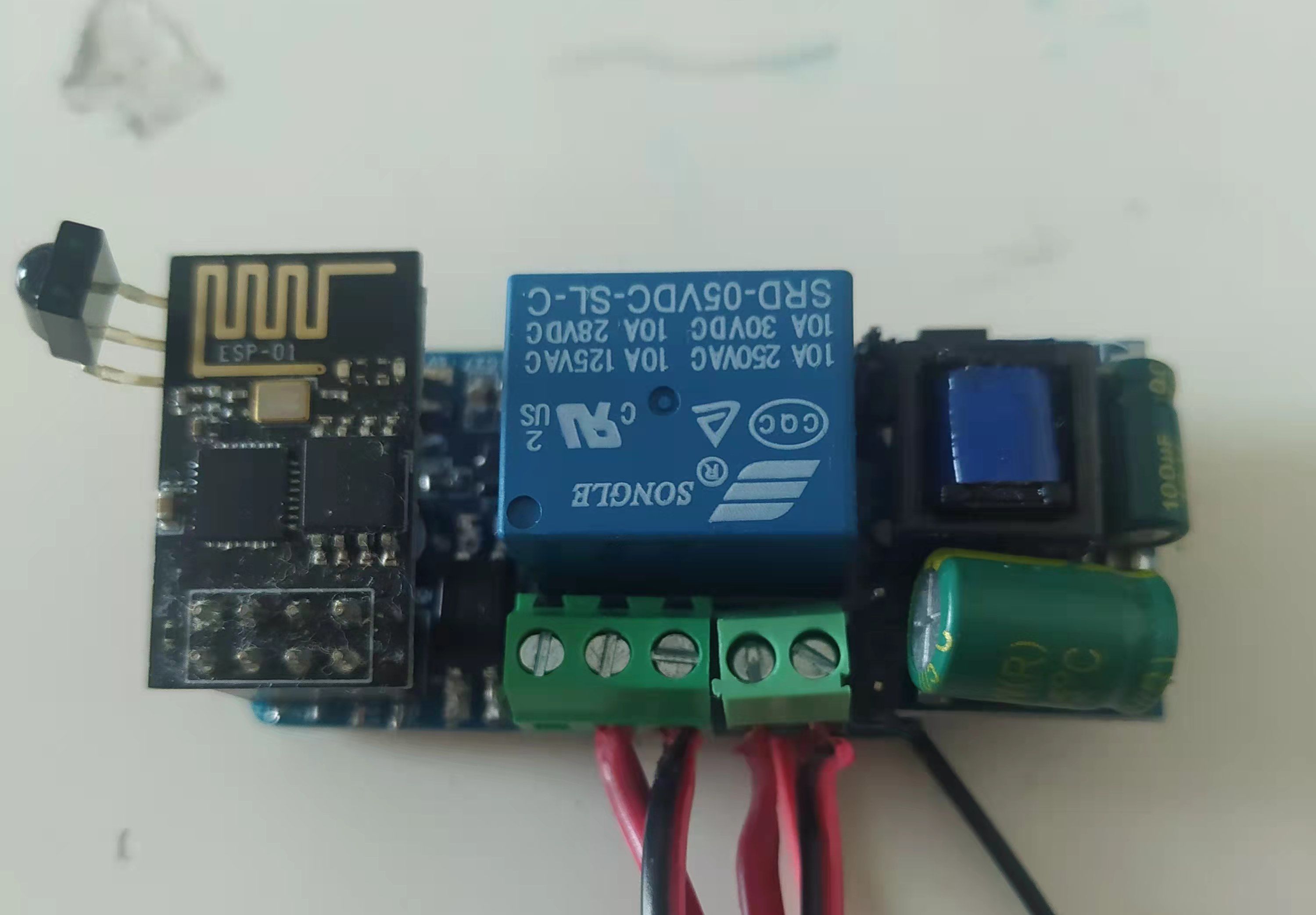

ESP01 Smart Switch

The pin assignment is as follows:
GPIO0 connects to the relay, GPIO2 connects to the button, and RX connects to the infrared sensor
. Only GPIO0 needs to be configured in the APP; the button and infrared sensor are already forcibly bound.
An infrared remote control is used; in fact, any NEC protocol remote control can be used. The code value corresponding to the remote control button needs to be configured in the APP when configuring the command ID.

The above is a wiring diagram of two switches controlling one light. We only need to replace one of the switches on the main control board with the relay. The relay's "normally open" and "normally closed" outputs correspond to L1 and L2 of the switch above, respectively. Actually, normally open and normally closed outputs can also correspond to L2 and L1. Three relays can control three lights respectively.

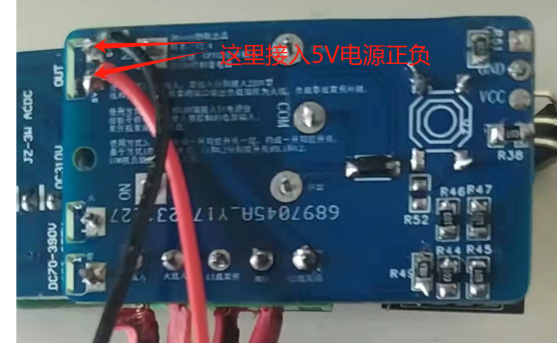

The board has a 5V external power supply port, allowing direct input of 5V without needing an external 220V power supply. This facilitates testing and verification, and in actual use, it can control non-220V circuits.
