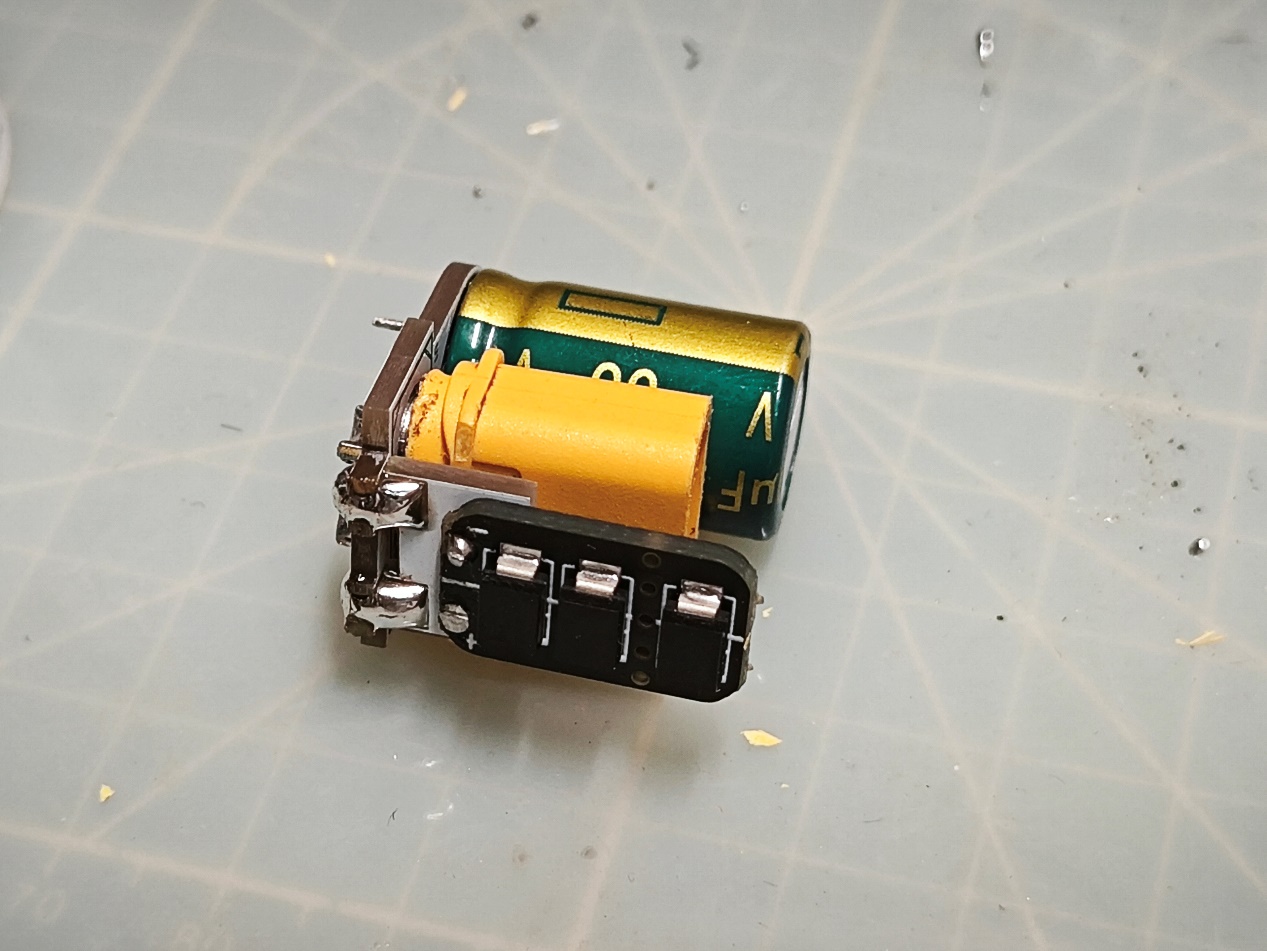

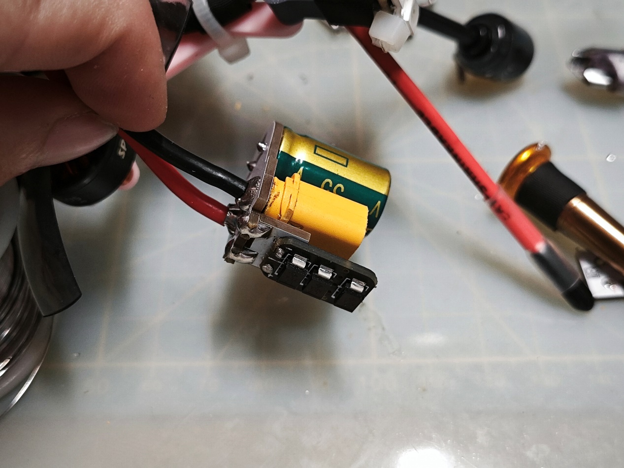

XT60 FPV drone - capacitor - TVS adapter board (compatible with Tianjin Aerospace TVS module)

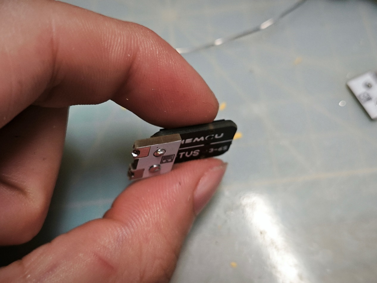

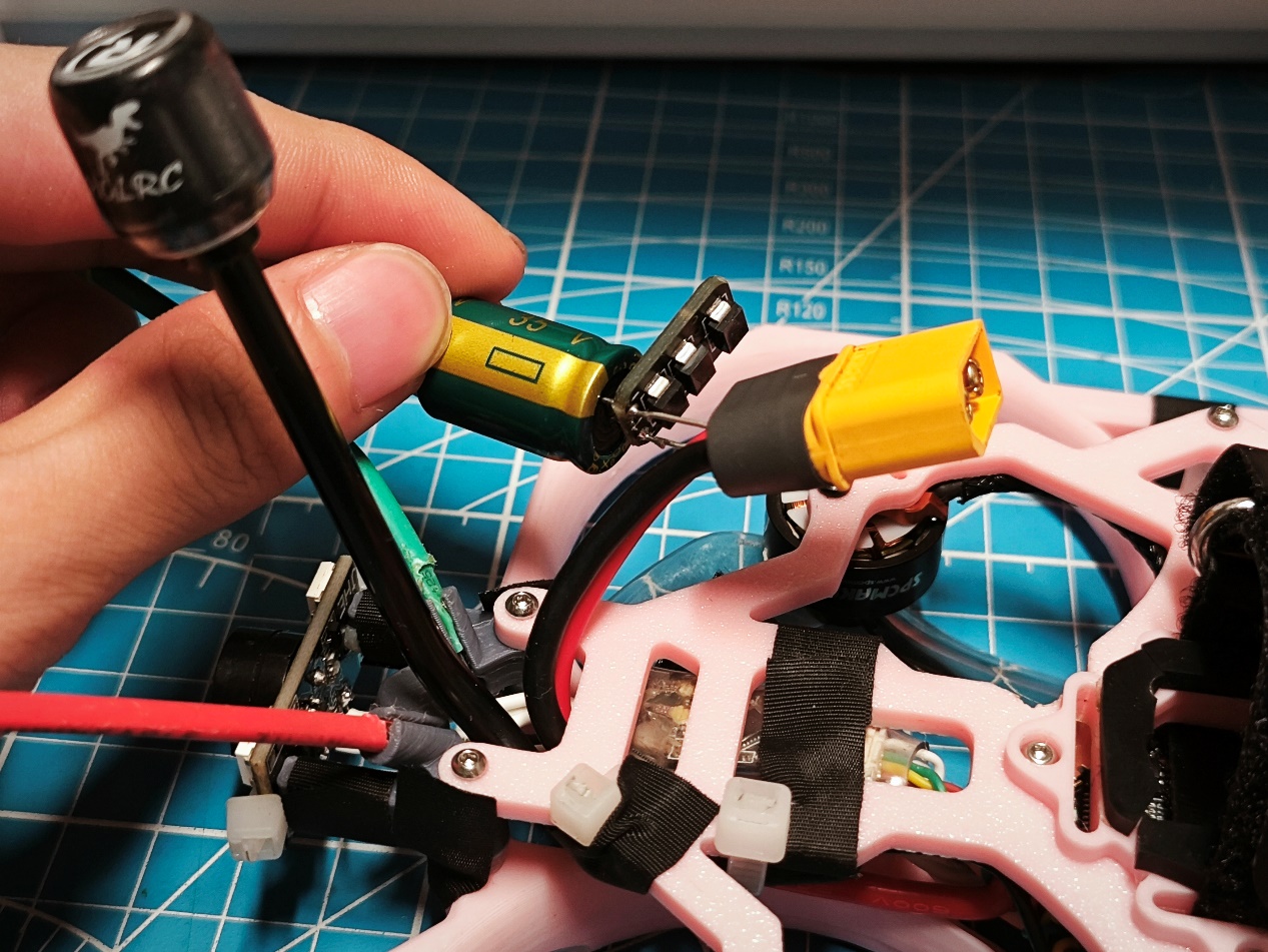

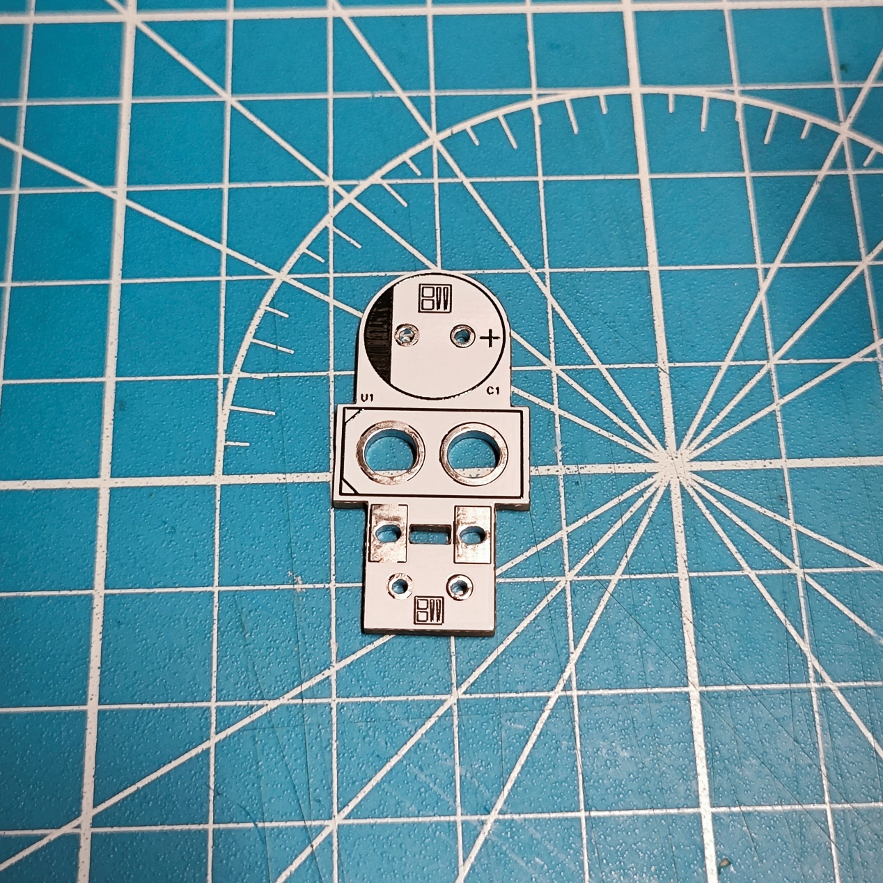

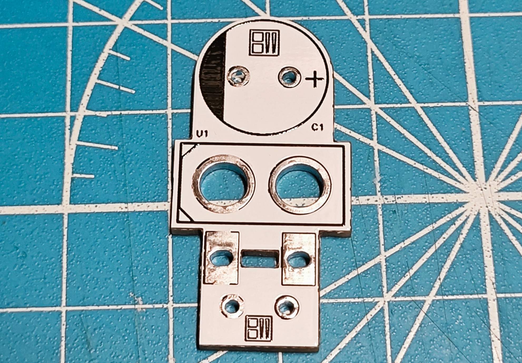

The original capacitors and TVS diodes were soldered to the XT60 via only two capacitor leads, making them prone to breakage. Therefore, an adapter board was designed using JLCPCB EDA, resulting in a more robust and stable overall installation. The TVS connection utilizes a "break-and-weld" structure, allowing for one-time assembly without being identified as a panel, thus reducing production costs.
Figure 1: Before installation ; Figure
2: After installation
; Figure 3: PCB layout;
Figure 5: TVS connection section;
Figure 6: Overall soldering result.
