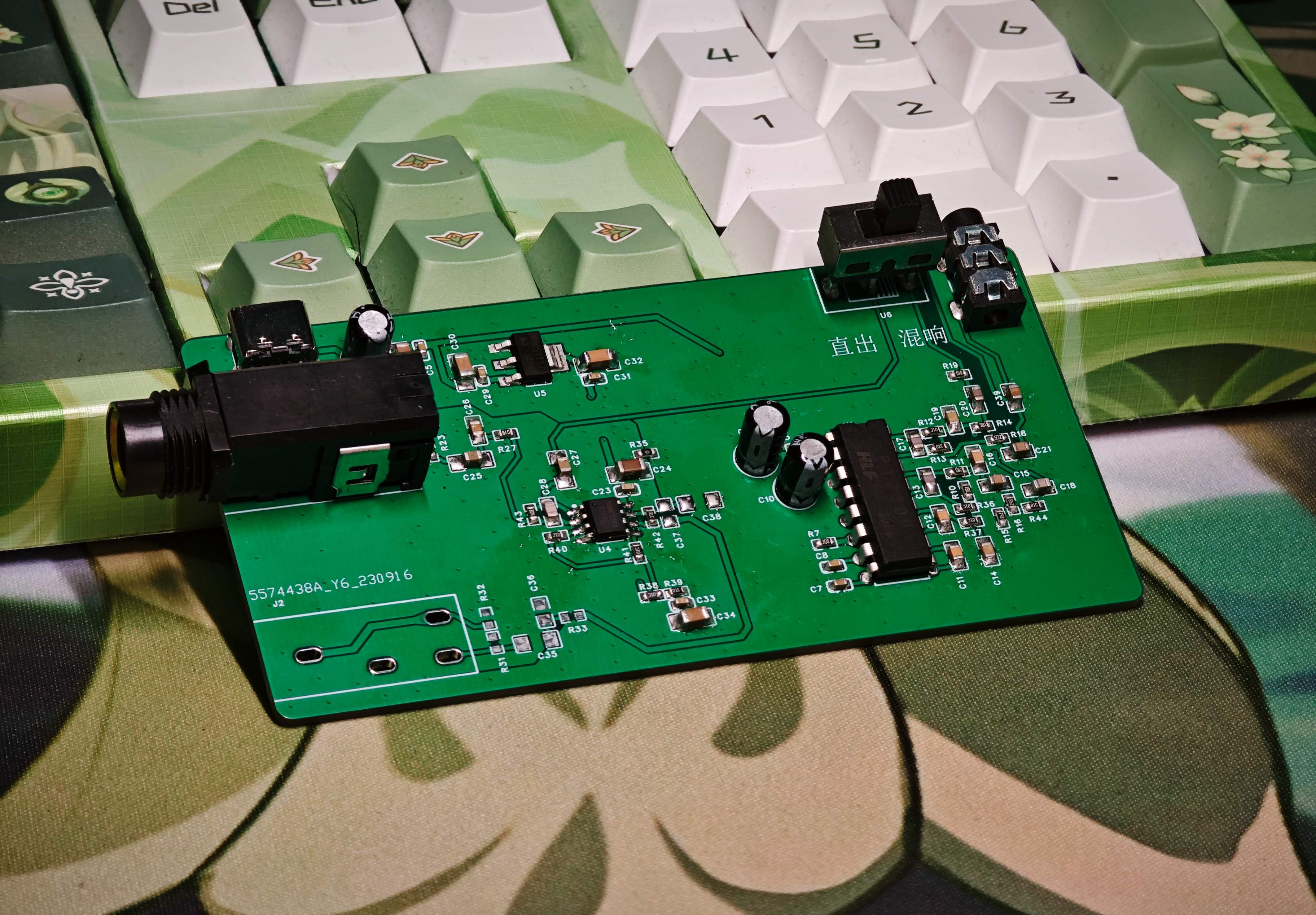

1. Introduction
The PT2399 is a CMOS-based echo audio processor IC that uses a DAC, high sampling frequency, and 44K memory for digital processing to generate audio. Regarding delay time, it also incorporates a voltage-controlled oscillator circuit internally, allowing the system clock to reach a readily adjustable frequency.
The LMV358 is a low-voltage, low-noise, low-power operational amplifier.

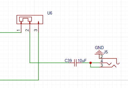

A switch here allows selection between direct op-amp output and reverb output.

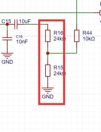

This resistor adjusts the gain.

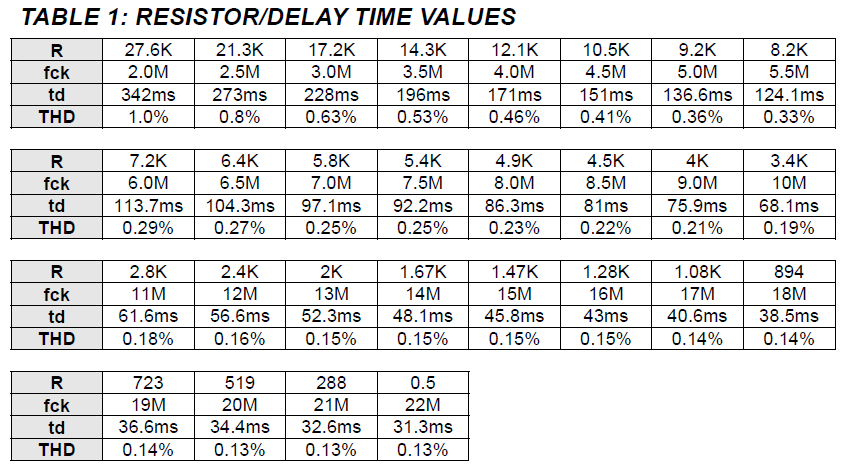

PT2399 Internal Block Diagram:
Reverb parameters can be adjusted via the resistor:
Resistor adjustment position is as follows:
This is an adjustable potentiometer in the standard circuit; it can be replaced with a potentiometer to achieve satisfactory results.
