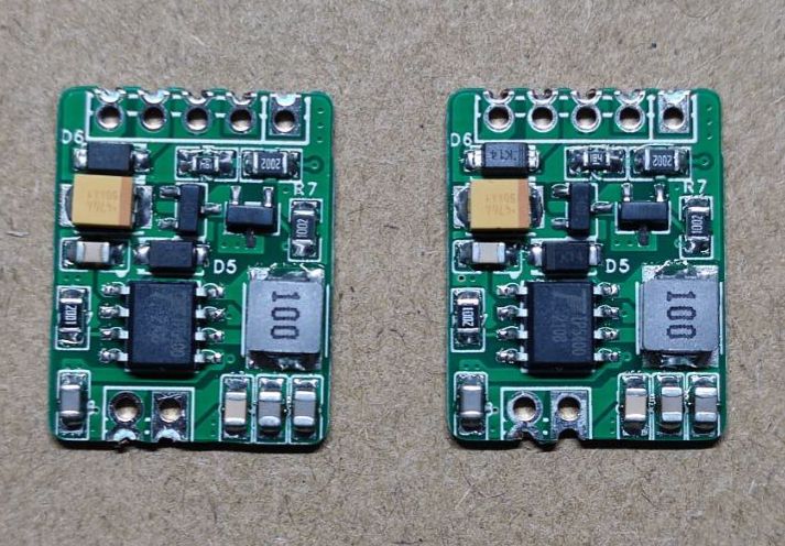

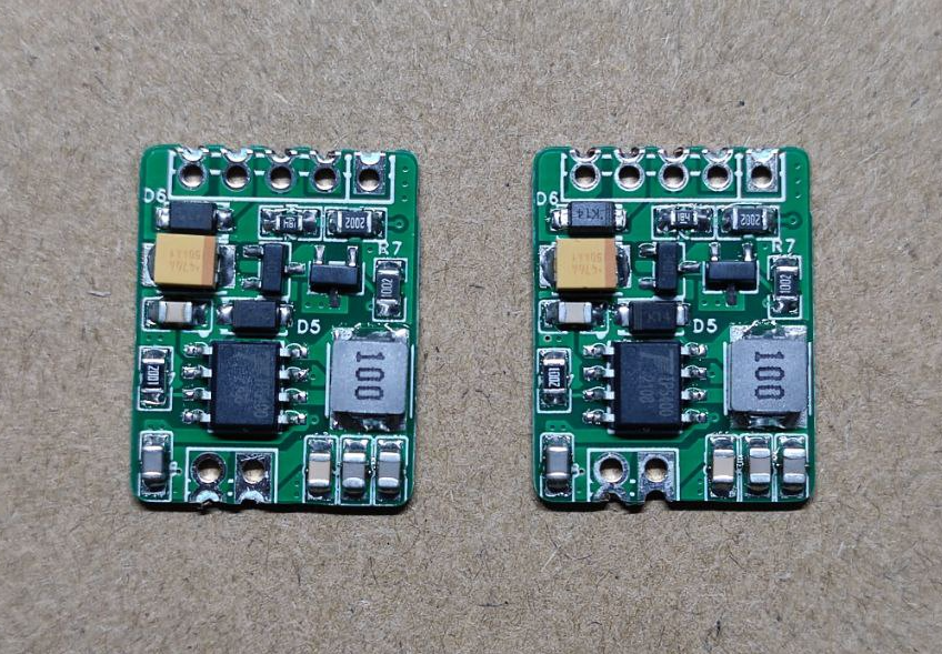

This is a small power board module based on the TP5400, integrating single-cell lithium battery charging, boost discharging, and USB + battery power switching. It supports 2.54mm pin headers and stamp holes.
Compared to version 1.0, it adds battery undervoltage protection, disconnecting the battery from the output when the TP5400 is not boosting, preventing over-discharge of batteries without protection boards.
The physical product image shows

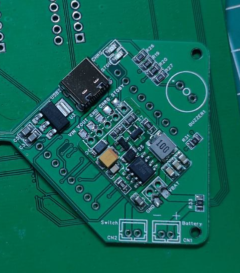

The 2.54mm header pin header and stamp hole design allows it to be used as a module or directly as a power management board on other PCBs.
For actual board appearance
and prototyping,
it is recommended to use a 1mm thick PCB for easy mounting on other PCBs.
When prototyping, please note "no half-hole process required, consequences at your own risk" to avoid additional costs.
