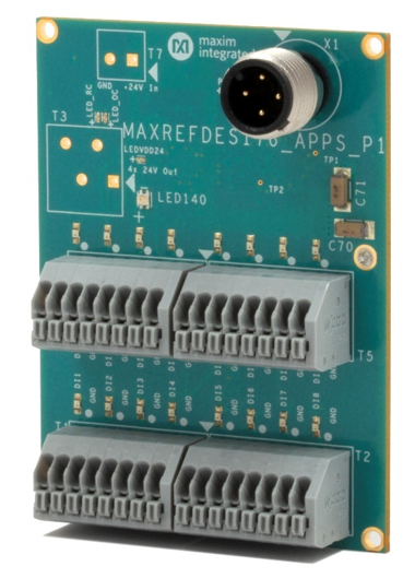

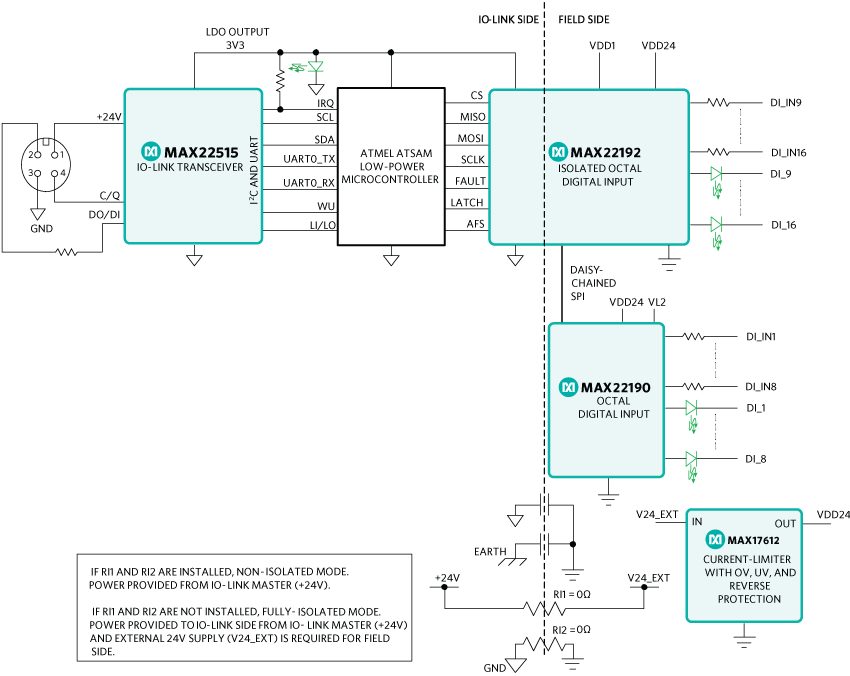

Maxim Integrated and TMG TE collaborated to design the MAXREFDES176# reference design that is compliant with the IO-Link version 1.1/1.0 standard. The MAXREFDES176# design consists of an industry-standard MAX22515 IO-Link device transceiver, an Atmel ATSAM low-power microcontroller that uses the TMG TE IO-Link device stack, and a MAX22192 isolated octal digital input serializer daisy-chained with a MAX22190 octal digital input serializer to provide a total of 16 digital inputs that are IEC 61131-2 compliant. The complete reference design fits on a 72mm x 54mm printed circuit board (PCB).The MAXREFDES176# IO-Link digital input hub consumes minimal power, space, and cost, making it a complete solution for the many digital input sensors found in various industrial control and automation applications.

The MAXREFDES176# uses an industry-standard M12 connector, which allows a 4-wire cable to be used.
The MAX22192 is an IEC 61131-2 compliant industrial digital input device with integrated digital isolation. The MAX22192 translates eight 24V, current-sinking industrial inputs to an isolated, serialized SPI-compatible output that interfaces with a 1.71V to 5.5V logic voltage. A current-setting resistor allows the MAX22192 to be configured for Type 1/Type 3 or Type 2 inputs. The MAX22192 has an isolation rating of 600VRMS for 60 seconds and is available in a 70-pin GQFN package with 2.3mm clearance and creepage.
The MAX22190 is also an IEC 61131-2 compliant industrial digital input device, but without integrated isolation. The MAX22190 translates eight 24V, current-sinking industrial inputs to a serialized SPI-compatible output that is daisy-chained with the MAX22192. A current setting resistor allows the MAX22190 to be configured for Type 1/Type 3 or Type 2 inputs.
A LATCH signal on each digital input chip allows for synchronizing input data across both devices.

The MAXREFDES176# consumes 30mA (typ). A green LED indicates the 3.3V alive signal from the MAX22515, and 16 green LEDs are used to indicate the status of each digital input.

The MAXREFDES176# can be operated in two different isolation modes depending upon whether RI1 and RI2 (both 0Ω resistors) are installed (non-isolated) or not (fully isolated). In non-isolated mode, power (+24V) is provided from the IO-Link master through pin 1 of the X1 connector. In fully isolated mode, two power domains and two power sources are required. For the "IO-Link Side" (as seen in Figure 1), the IO-Link master provides power (+24V) through pin 1 of the X1 connector. For the "Field Side," an external 24V supply is required, which is connected through terminal T7.
The MAX17621C current limiter is used to provide overvoltage (OV) and reverse-voltage protection for the external supply, blocking any current flowing in the reverse direction and providing protection for the circuit. In this reference design, a SMAJ33CA TVS was included for surge protection.
