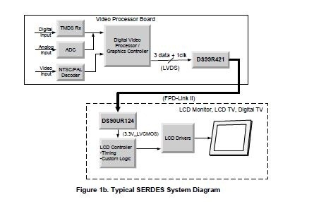

The TIDA-00136 reference design is a high-speed serial video interface that allows remote automotive WVGA TFT LCD displays using the OpenLDI (LVDS) interface to be connected to a video processing system. This design uses TI's FPD-Link II SerDes technology to transmit uncompressed video data over shielded twisted pair or coaxial cable. Examples of applications include rear-seat entertainment systems, automotive instrument clusters and head unit displays. This design combines the DS99R421Q1-EVK and DS90UR124-Q1 boards to form the solution.
characteristic
  • ● Supports WVGA x 60 Hz data rate
  • ● Directly connected to the display, supporting OpenLDI standard (LVDS)
  • ● Built-in self-test (BIST) ASIL B application
  • ● AEC-Q100 serializer and deserializer
