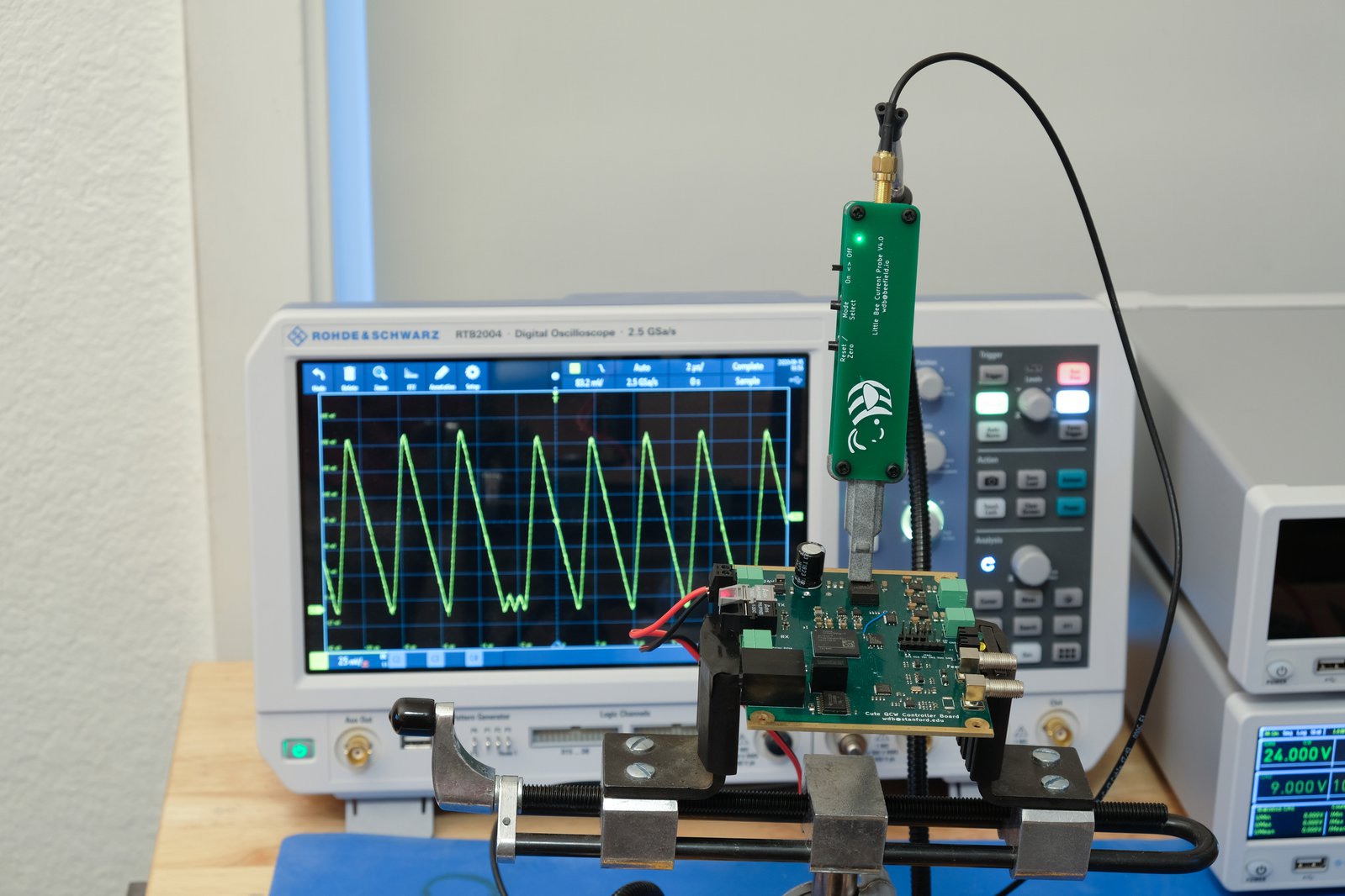

Little Bee is an affordable, high-performance current probe and magnetic field probe that allows you to debug and analyze electronic devices more efficiently.
Features:
- Adjustable bandwidth (10 MHz and 1 MHz)
- Adjustable gain (1x and 4x)
- SMA output connector
- Connects to any standard 1 MΩ impedance oscilloscope input
- Powered by a single AA battery (4 hours battery life)
- Automatic Return to zero
Specifications:
Current Sensing
- Bandwidth: DC - 10 MHz
- Sensitivity: 0.25 Volts/Amp
- Maximum Current: +/- 5 A
- Noise: 3 mA RMS, 10 MHz bandwidth; 2 mA RMS, 1 MHz bandwidth
- DC Accuracy: + /- 15%
- Insertion Impedance: 100 nH in parallel with 70 Ohms
- Maximum Wire Size
4.25mm Full
10mm End Feed
Magnetic Field Sensing
- Sensitivity: 0.2 Volts/Gauss
- Maximum Field: +/- 6 Gauss
- Noise: 4 mG RMS at 10 MHz bandwidth, 2.5 mG RMS at 1 MHz bandwidth
