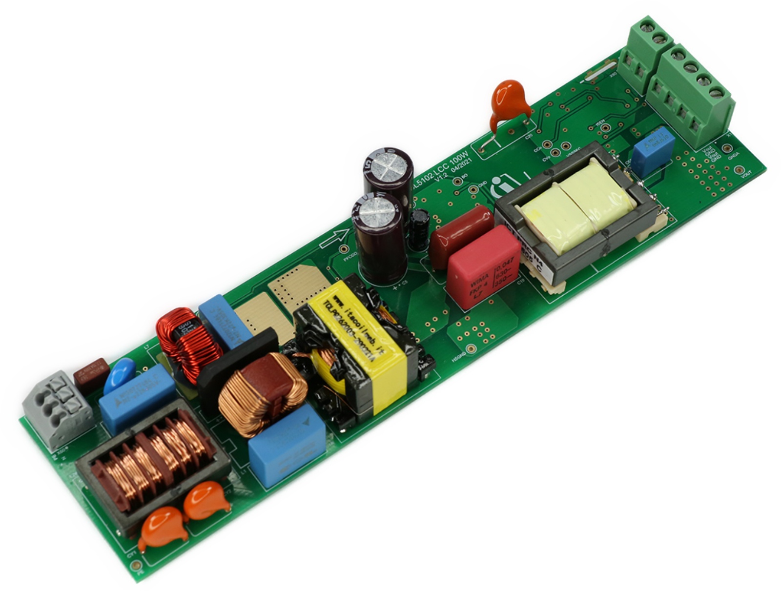

100W LED driver evaluation board using high-frequency LCC transformer to achieve low-cost and miniaturized design
REF_ICL5102_U100W_LCC
This 100 W reference design highlights the excellent power quality and high frequency performance of the half-bridge (HB) driver using the ICL5102 with the economical CoolMOS™ P7 series. The design takes full advantage of the applicable frequency range of the HB driver to create Highly compact LCC transformer. This transformer integrates the series inductance of the LCC resonant tank. Relying on this high power density transformer design, the high frequency operation capability can drive system cost and size reduction.
REF_ICL5102_U100W_LCC is a 100 W LED power supply that provides constant current output over a voltage range of 55 V to 20 V. Features include: wide range output current from 1.82 A to 0.018 A, wide range of analog dimming levels from 100% to 1%, fast turn-on time of 500 ms (worst case), 30% effective at 267 V RMS High power factor exceeding 0.9 at above load, input current THD less than 10% at 20% load and above at effective voltage of 267 V RMS .
