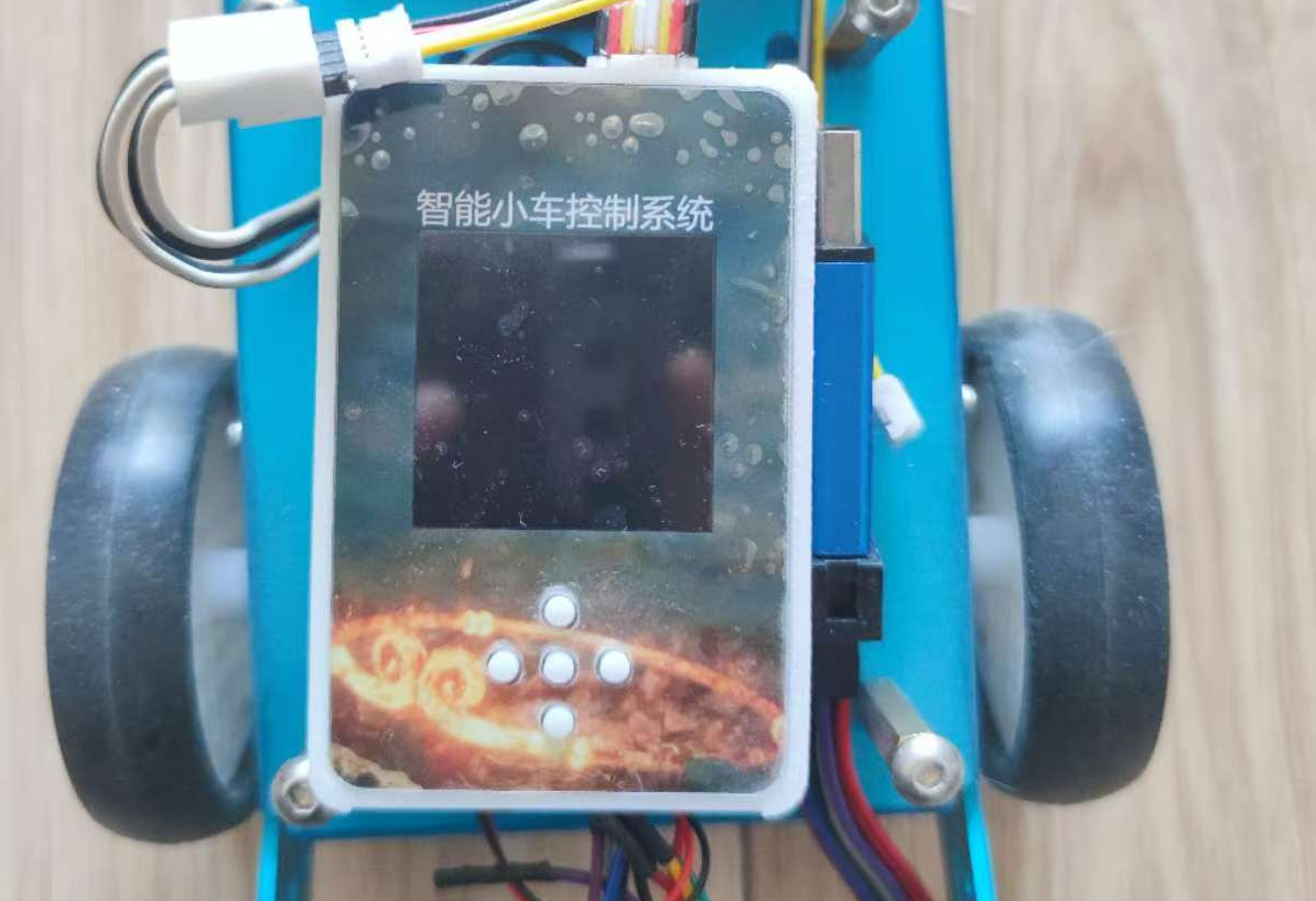

Project Overview
This project is an expansion board for a smart car based on the LCSC Skystar GD32F407VET6 development board - Youth Edition.
It uses two TB6612 chips
and PCA9685-16-channel servo motors for driving, with 6 channels actually brought out.
The gyroscope uses an MPU6050 .
The screen is a 1.54-inch 240x240 high-definition IPS LCD display with integrated backlight.
Project Functions
Drive 4 motors.
Drive 6 servos.
The MPU6050 gyroscope
can be connected to a 3.7V lithium battery, providing charging functionality.
1.54-inch 240x240 screen displays
Project Parameters
This design uses the MPU6050, integrating a 6-axis Motion Tracking device. It integrates a 3-axis MEMS gyroscope, a 3-axis MEMS accelerometer, and a scalable Digital Motion Processor (DMP).
This design uses the TB6612 motor driver, a Toshiba Semiconductor IC for driving motors. One TB6612FNG can drive two motors, each with two logic input pins, one output pin, and one PWM pin. The motor's operating state can be controlled by applying different levels to the two logic input pins, and the motor speed can be adjusted via the PWM input pin.
The PCA9685 is selected; it is a 16-channel PWM servo motor driver based on the I2C bus. Internally, it integrates 16 PCA6124 PCA bus servo drivers, providing independent PWM control signals for 16 servo motors. Each channel can independently set the PWM width, thereby precisely controlling the servo motor's rotation angle.
The
project consists of the following parts: charging section, motor drive section, servo drive section, and gyroscope section.
The charging circuit uses an IP5306 and includes a switch.
The TB6612 consists of two
servo motor drivers as shown below. The actual value uses a 6-channel PWM output
gyroscope circuit. AD0 grounding
software code
is available in the attached zip package.
