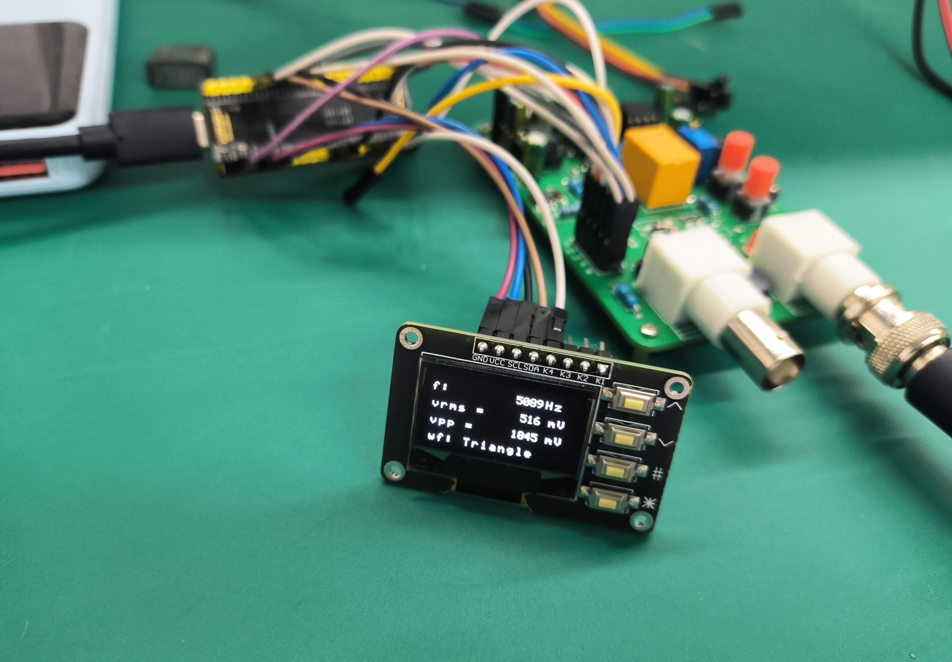

Raspberry Pi pico connected to PCB board. Wiring details are shown in the code. Note that the Raspberry Pi VUSB is connected to the PCB 5V. The Raspberry Pi is powered by USB, or it can be powered separately.
Program flowchart .
Physical display:
Demo board used for testing.
Demo board reverse side.
Note:
The effective value of the AC voltage of sine and triangular waves is the waveform. The measurement error is large (100mV+) at higher frequencies (10kHz+).
Physical picture: The PCB silkscreen is incorrect. The bottom of the vertical pin header is the AC voltage input instead of G (ND). It has been corrected in the file.
